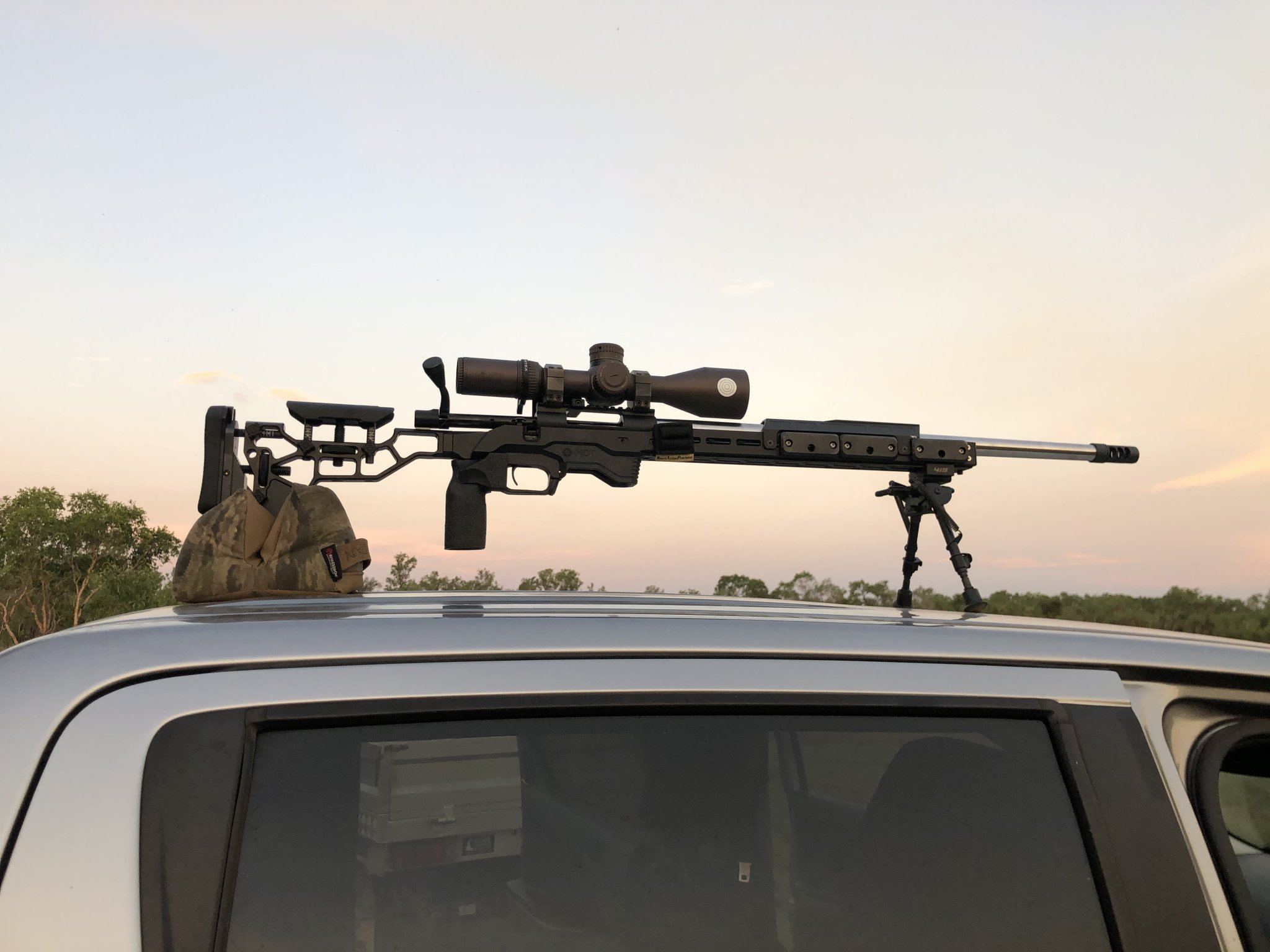

I shot my Howa 6.5 Creed barrel out at around 2400 rounds, then rebarrelled it in 6BR while I wait on my Defiance Ruckus to arrive in Australia (7 months so far). I have a custom rifle in my safe as well but the Howa is now my “go to” again for PRS. I had no truing work done, only turned down the firing pin and bushes the bolt face and it shoots 0.3s consistently at 100m, took it out yesterday to 700m and shot a 0.5MOA (4.16”) 7 round group off the roof of my truck. Howa’s are an extremely underrated action.

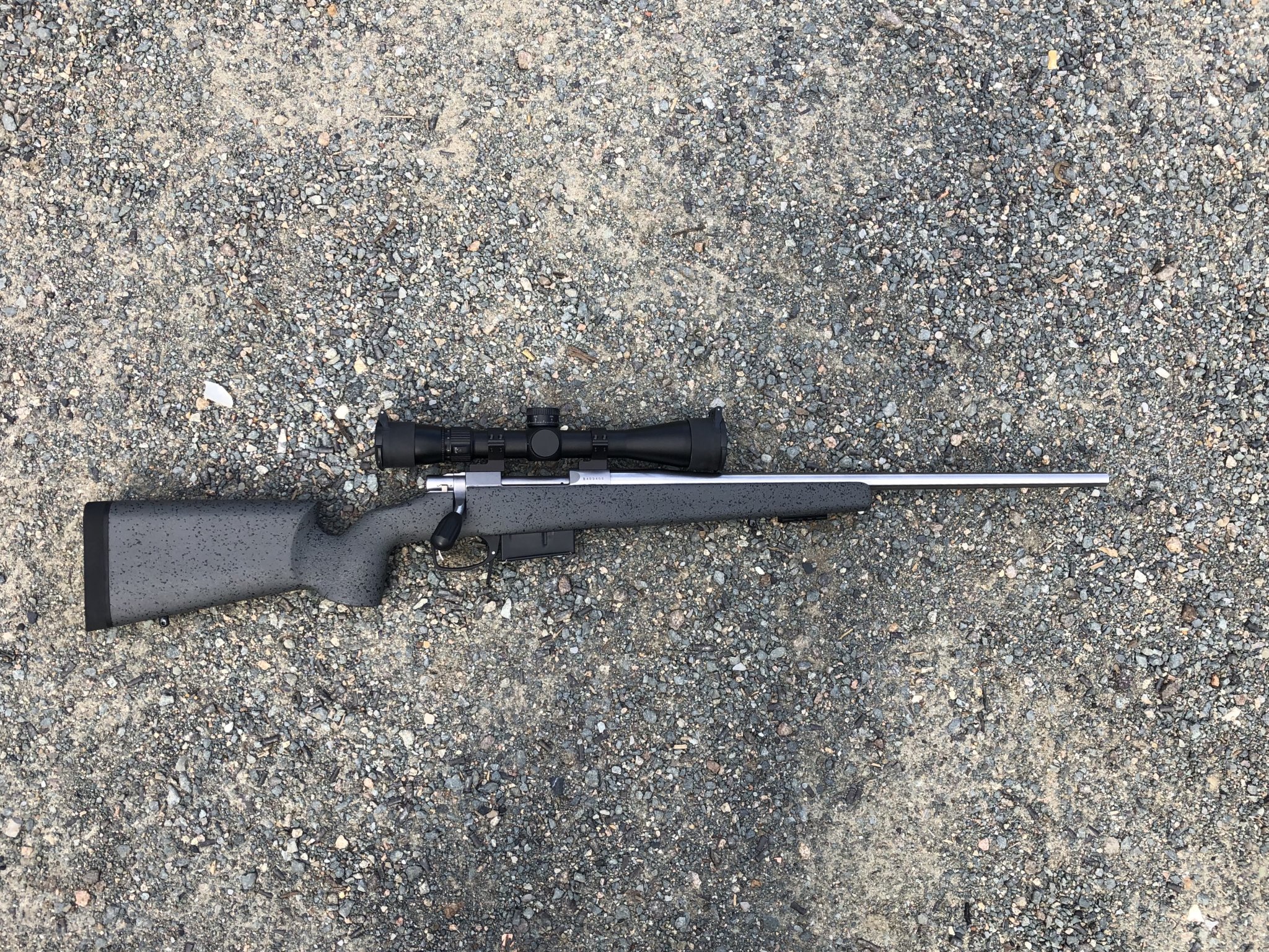

You can just pull the Howa trigger out and clip the trigger spring to lighten it up. 1st stage on mine is 7 oz, 2nd stage is 1 pound. Think I clipped 1 3/4 coils, might have been 2. Google it or or I think there's a video or 2 on youtube.
Reactions: _JT
I like that a lot! What stock is that and what contour barrel?
It's a McMillan A3 - It has the highest comb of any of their stocks which is great if you don't want the weight of an adjustable cheek-piece. The contour is the IBI Medium Hunter Profile and the total weight is 9.25lb as pictured. If this was going to be for higher volume shooting I'd opt for a beefier contour - for it's intended purpose (hunting) the balance of components here is great
