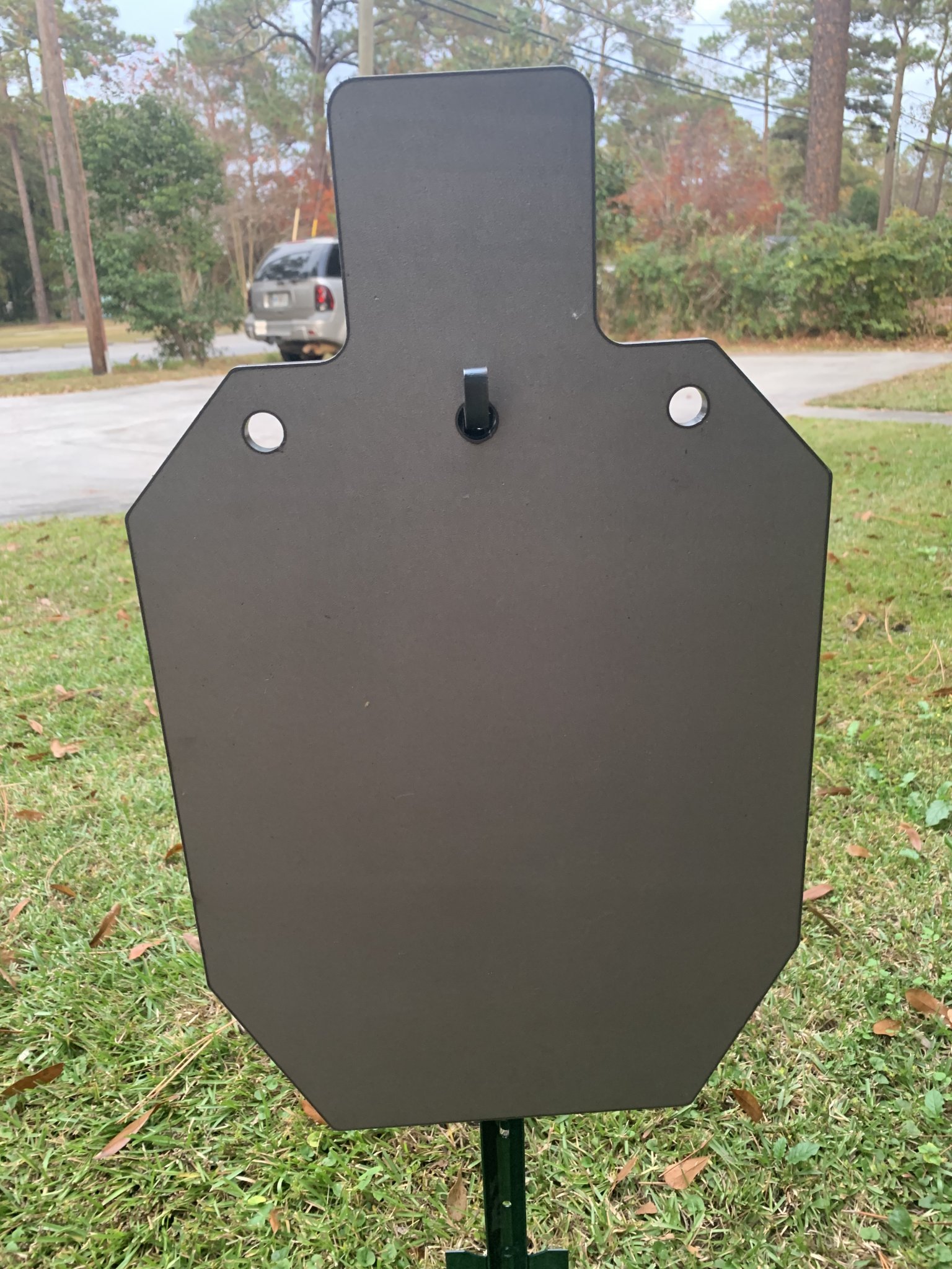

On another note. My AR500 target came in from Krate Tactical. I was skeptical ordering AR500 off Amazon but I found out they were from Georgia and they give a discount for first responders. Came with a holder that’s easy to move around.
