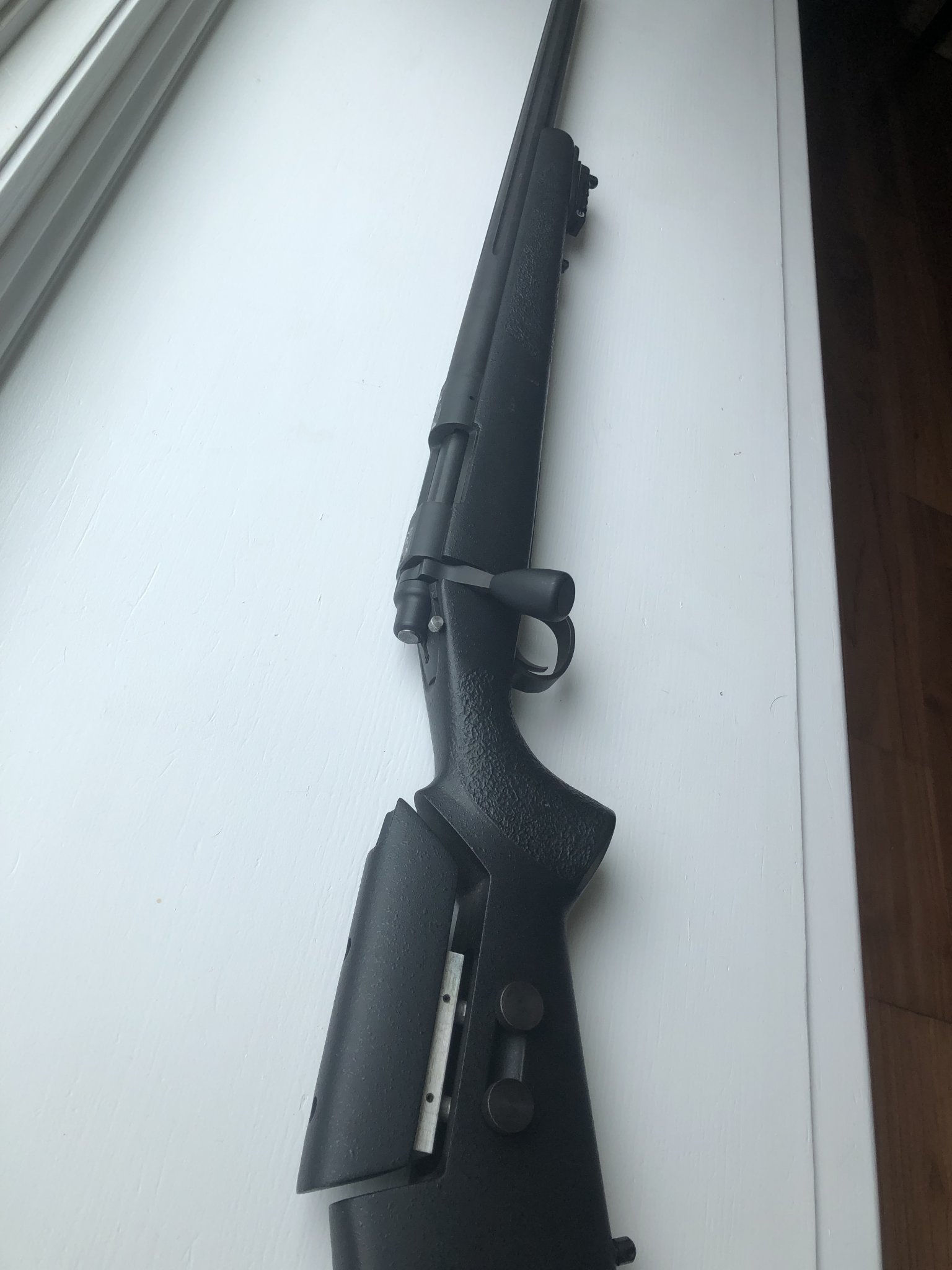

    I have a Rem700 in .308 that I traded for a couple years ago. It is a custom rifle that the guy didn’t know much about. 24in fluted bull barrel on a Caldwell stock, Jewell trigger, weighs about 20lbs. I plan on using this gun to hunt deer out of box stands and shoot on the range occasionally out to 500.
    I have not had much luck with accuracy though I am very new to the precision bench shooting but not new to shooting. I did order some cleaning supplies to see if that helps but It might be too far gone. I’m getting 2-3 MOA (factory 178 ELD hunter and me doing half my part)
    My question is should I rechamber to the 178eld or rebarrel to 6.5CM?
    I was about to buy a Ruger American Hunter in 6.5 but a custom barrel would cost apt the same and be better…OR… stay with .308 since all I doing is hunting and shooting medium distance and will that help my accuracy?
    If I rechamber should I get the reamer myself and have the shop do the work? to avoid a dull shop reamer. I do have a competent custom shop near by.
    What is that stock made of to make that rifle weigh even close to 20 pounds? Also, it takes quite a bit of shooting to shoot out a .308. If you aren't happy with how it's shooting you could try different ammo or reload. Rebarreling would be fine, I wouldn't mess with getting it set back though.
    Also, the gunsmith you choose should definitely have a .308 or 6.5 creed reamer, you shouldn't have to buy one yourself. If you plan on having numerous barrels cut, then you may consider buying the reamer.

    The first hing I would check is the scope base, followed by the scope rings, followed by the scope.
    I would also check the torque values on the bottom metal, make sure the barrel is free floated and check the crown.
    Once you eliminate those, consider the barrel.
    I'm not familiar with any rifle stock made by caldwell, though I could be mistaken.
    Good luck, that is a good looking rifle.

    I didn't know Caldwell make stocks either but that was labeled on the inside of the stock.
    I just ordered a Steiner P4 and plan on having the pros slap it on and will see if they notice anything out of wack with the gun.

    Ok its only 13lbs with a scope... Im used to 5lb AR15s and hunting rifles.
    Same advice as the others. Verify that screws for rail, rings and action screws are torqued to proper values. A little blue Loctite doesn't hurt either. Give the barrel a good scrubbing with cleaner of your choice that will remove the copper. Use a good rest to stabilize the rifle when shooting. Certainly try some other brands of cartridges and weights of bullets. I can't imagine you won't get that rifle to shoot with bullets between 150gr. and 178gr.'s.
