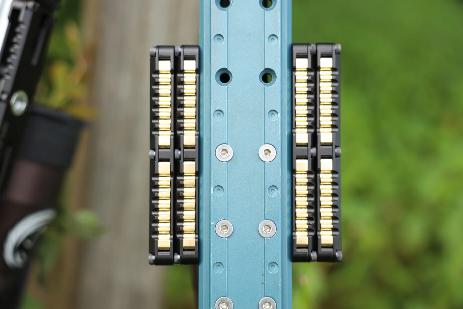

Do stacking weights on the ACC
Put a tuner on the end of your 22" MTU, like a Harrel's or a Holeshot, which will simulate basically 2" of added barrel length weight.
Though the cost of all the weights and a tuner is like $400.
Lighten up your ACC Elite rear, get rid of all the crap that doesn't need to be there, take out the heavy adjustment wheels, tighten it with just set screws.
Get rid of the heavy-ish butt spacer if you have it on.

I hadn't considered stacking weights. That might be the my cheapest route.

Get a clamp on tuner, like a Harrel's, no need for rethreading and will add another 8oz at the forward most. They actually sell weights for the Harrel's too I believe to add another 10oz on it, so you could have 18oz at the muzzle for weight.
If I had to re-do things and wanted to reduce overall weight while having the most balance, I would try to push my weight as far forward as possible. I'd probably do like a .9" straight, heavy tuner at the end of it, and put chassis weight forwards.
