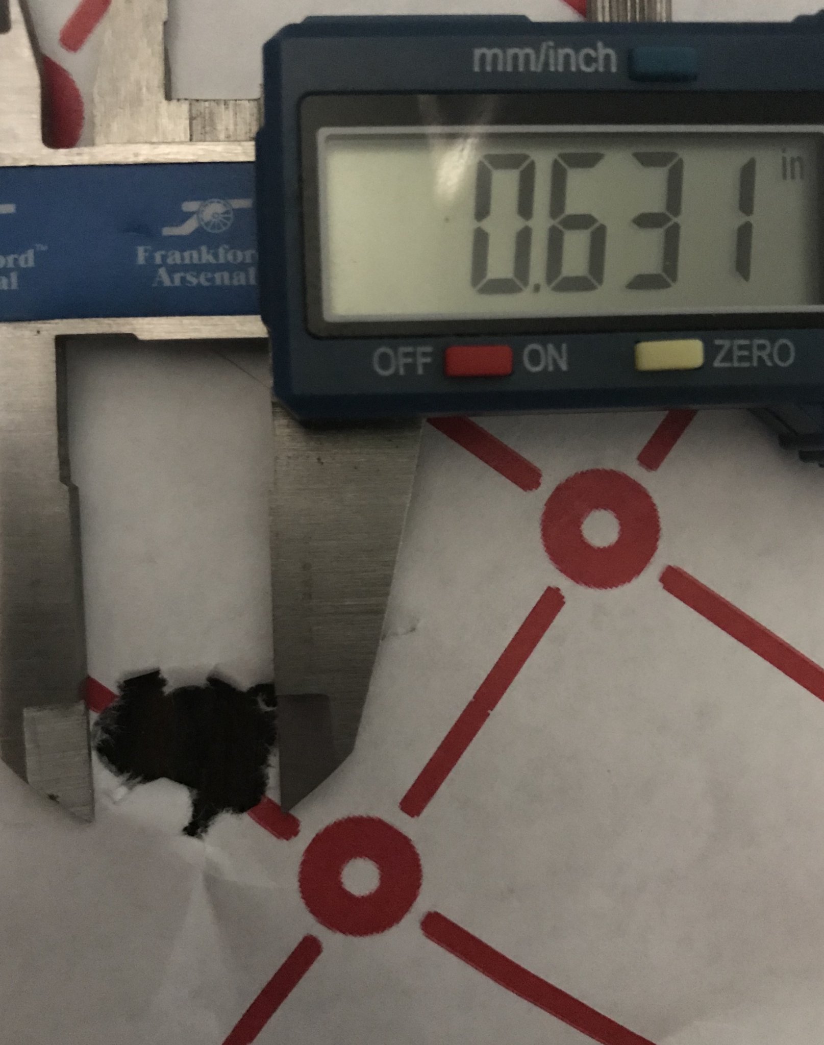

    I also have a Craddock Precision barrel in my AR-10. She hammers. It’s a Criterion blank chambered in .308. Paul talked me into buying the Criterion over the Bartlein when I called them to talk about options. I couldn’t be happier with it. He also offers a military discount, just need to call and ask.
    This was a 5 shot group with FGMM 168gr. It’s a 16” 1:10
