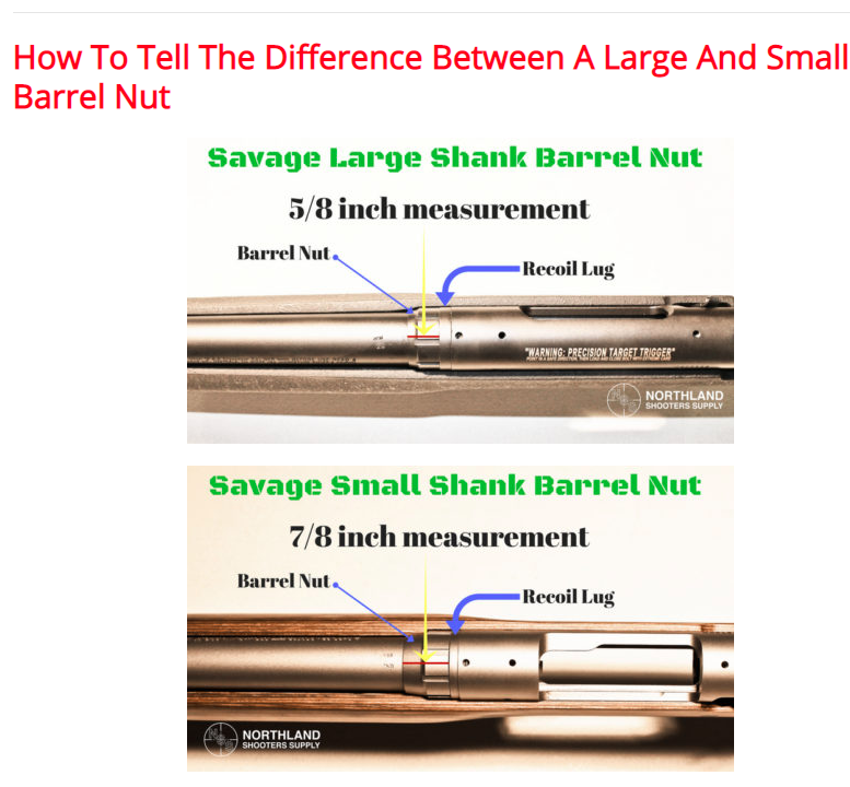

Measure your barrel nut 5/8'' is large shank and 7/8'' is small shank.
Long Action: 5.062" Spacing
An illustration
Reactions: Steel head
That's a shitty illustration.
NSS should do better.
If it is the length of the barrel nut being measured, it should look more like "--->| |<---".
Are you sure it is small shank? I thought all of the *factory blueprinted* models was large shank?
According to the shitty illustration above, created by someone who has no business whatsoever giving dimension details, I think its a small shank but now I'll have to look when I get home. This quandary will annoy me until then and I'm out of Copenhagen.
Pretty sure all Stealths are "blueprinted" and also large shank barrels. From what I remember, all "blueprinted" actions were large shank. From a company that is massively driven by production simplicity, I can't believe that they would have a small shank/large shank "blueprinting" system.
