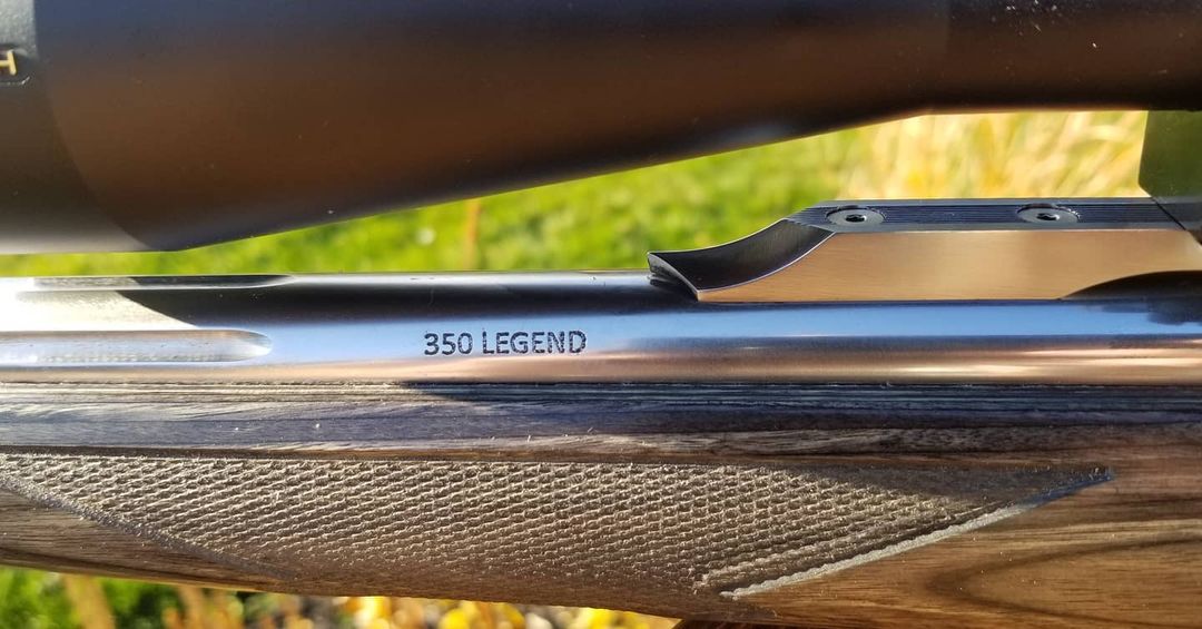

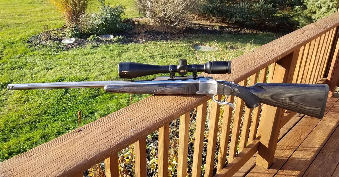

I should have replied back here sooner the rifle turned out great shoot as good as it looks. The barrel profile is the same as Remington sendero the mount fit perfect just needed tapped .
The biggest issue I had was threading the barrel not having wire gauges for the first one . When threading you can't just check the thread with the action because of the hanger system . Threaded it to what I thought was close pulled it out of the lathe and it wouldn't start . So we learned a couple things re indicating the barrel and getting the threads "timed" to cut deeper .
The extractor cut ended up being the easy part chucking an old lathe chuck on the edge of the mill table to hold the barrel upright. Going from 450 bushmaster to 350 legend just took a 223 extractor .
Ended up rebarreling four of these for the same family they all shoot nice didn't need any work on the hanger just free floating the hand guard .

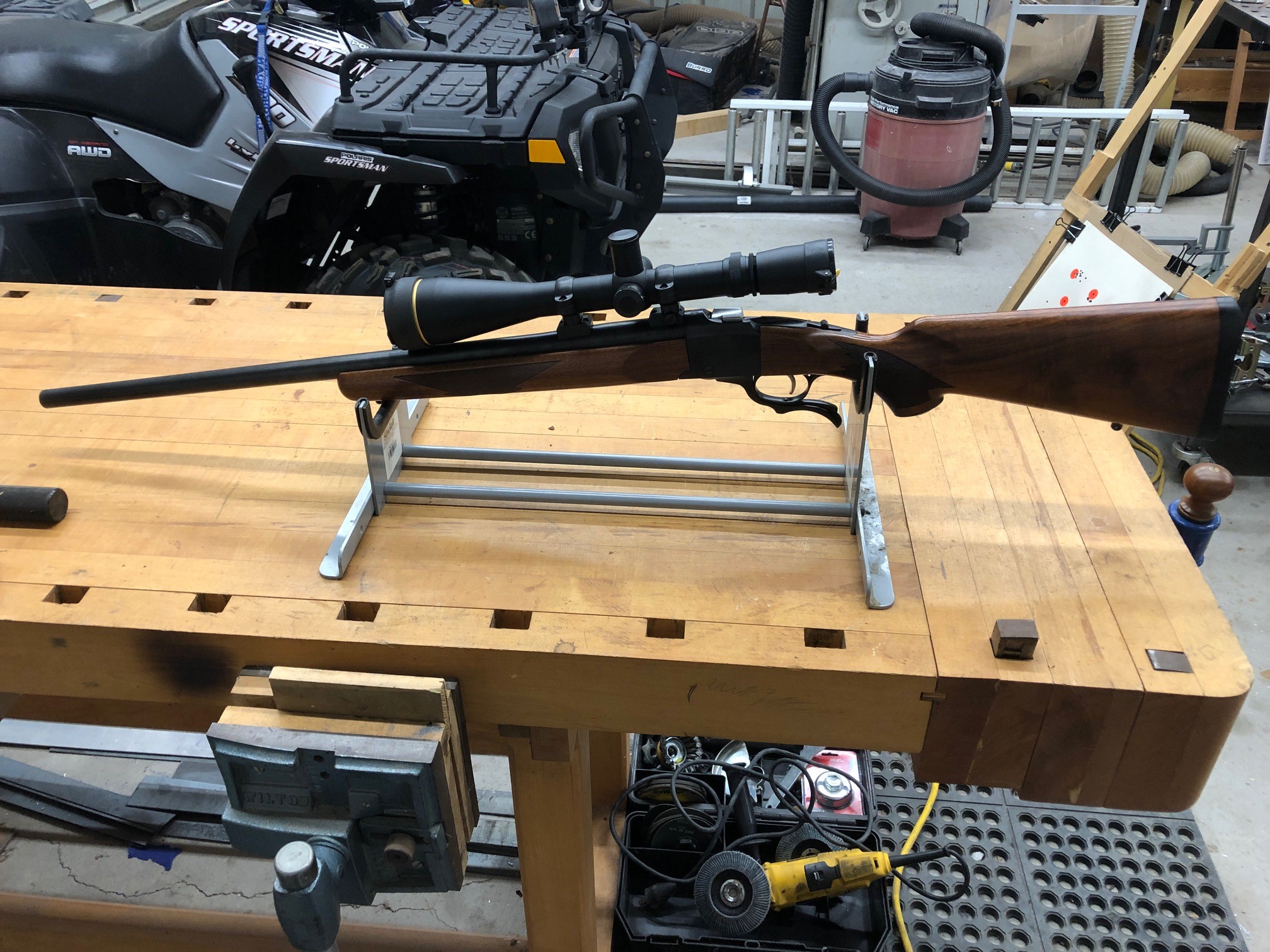

Robert Gradous re-barreled a No.1V for me in 220 Swift just before he passed away. Put a Krieger 4 groove 1:12 barrel on it and had the scope mounts made by D'Arcy Echols. It took him about 18 months to do the job and he called me numerous times during the project to let me know his thought process and seemed to be a labor of love on his part. Unfortunately the picture does not due justice to the beautiful job he did.
