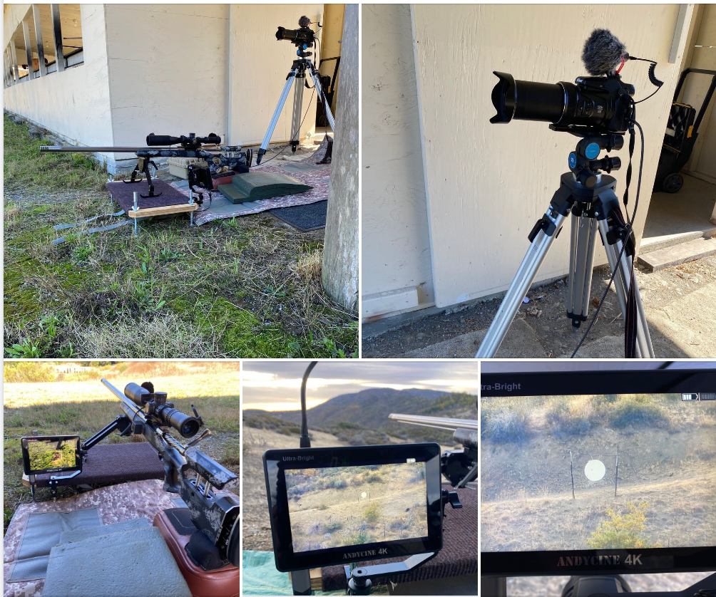

What's target size (in feet, or minutes)?
Remote camera at that range?
Curious what they might be using. The range we frequent goes to 2K, but the camera system is crap... can't spot anything with it because the refresh rate is literally measured in seconds.
The target size is 37" round - see the definition of "target" at https://www.unlimitedrange.org/operations.html
We use hit-indicator lights for scoring (hit or miss).
Recently one of the shooters has started using a camera to assist in "documenting" his shooting and for spotting - a tripod-mounted Nikon P1000 and a tethered monitor on which to project the camera image in real time. See the top two pics at https://www.unlimitedrange.org/gallery.html
Here is what I am using...
My Long Range Camera Setup
I'm using a Nikon P1000 digital point and shoot camera, which has a focal equivalent to 3000mm on a 35 mm camera. The Monitor that I use is an Andycine C7 field camera monitor. It works awesome even in direct sunlight. I'm using a surveyors tripod with an adapted Benro 3 way geared head adjustable mount. This makes it nice and stable for recording at long distances and very easy to adjust. I'm using the monitor on the HDMI output of the camera and have it mounted on a clamp on cold shoe to my small shooting table. The monitor is a touch screen with all kinds of options and has a pinch to zoom function so I can leave the camera at 3000mm optical and record the video without any digital zoom. By using the pinch to zoom on the monitor I can get as close as I want to spot shots. I was able to see small impacts in the grass below the target that you'd never be able to see through any spotting scope I've looked through. and by recording your shots you can go back and figure out where you hit if you didn't see it the first time. Oh yeah and if you have that awesome day when everything goes right you'll have the proof as well...
The 3000mm view is at 2054 yards and the gong size is 37"
