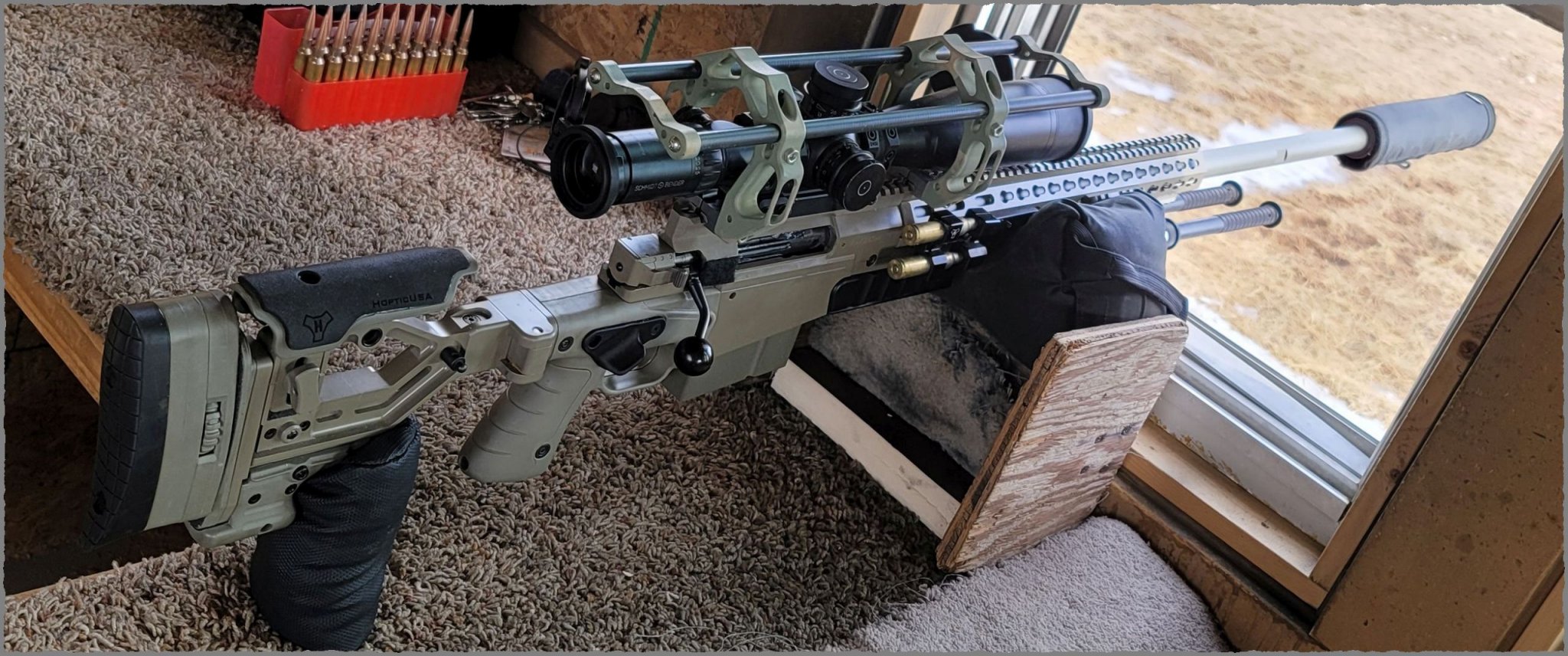

Received my new .33xc barrel
bunny too
Just a cook
May 5, 2020
480
543
Wyoming
Had it turned at Southern Precision, Bartlein MOD400BB. I know there are those that do not like the cage. Kicks substantially more than my .338lm....
