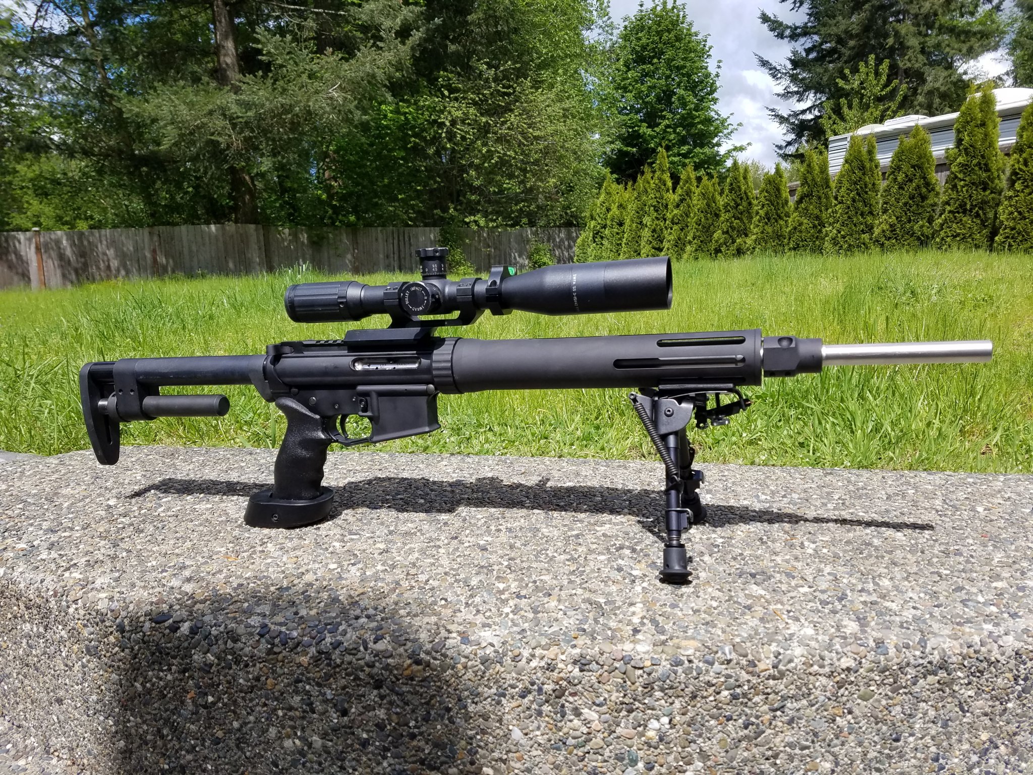

I had one of these ugly assed DPMS uppers with a heavy 20" Shilen barrel and it was the most accurate AR I've ever owned. Sold the rifle to a dude from work a few years ago like an idiot.
