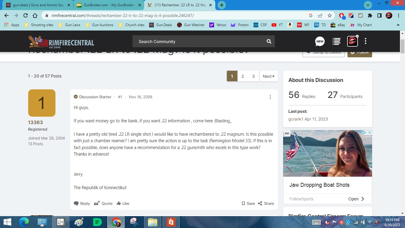

Hi guys,
I have a pretty old tired .22 LR single shot I would like to have rechambered to .22 magnum. Is this possible with just a chamber reamer? I am pretty sure the action is up to the task (Remington Model 33). If this is in fact possible, does anyone have a recommendation for a .22 gunsmith who excels in this type work? Thanks in advance!
