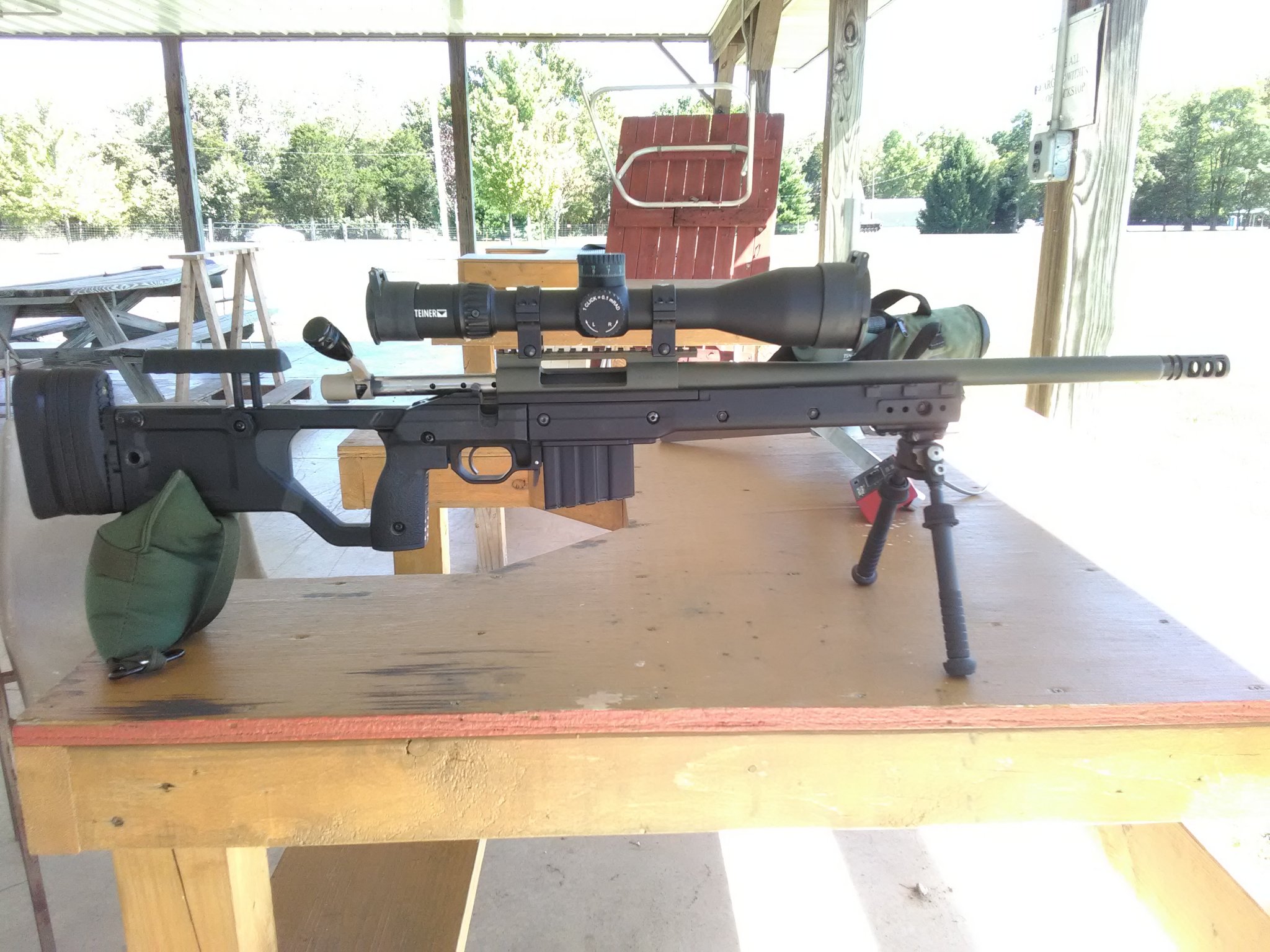

I'd go with a barrel somewhere between 16 and 18 inches with a good brake.
This one (mine) has a 17" 308 barrel and the brake adds another 2.5". Super handy and still capable to hit torso sized targets at 1000 yards without undue difficulty.

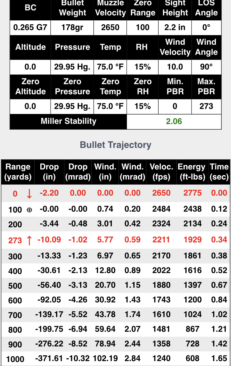

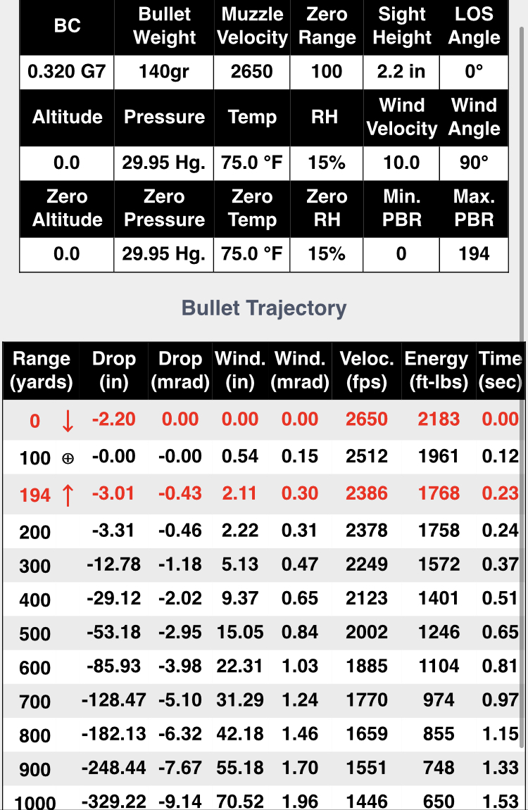

I think the 6.5 just murders the 308 in drop and drift, while being accompanied by 25% less recoil. Energy is another matter and at intermediate ranges the 308 wins. I’d still pick the 6.5 because it means i’ll miss less with a less than perfect wind call. There’s just no overcoming the 6.5’s bc advantage using bullets you’d likely shoot in a 308.

The difference looks dramatic if you miss a 10 mph wind shift.
Run that chart with a 2 - 3 mph wind, which is the kind of wind shift that is more realistic for a person to miss. Now let's see what kind of linear error that makes in relation to a realistic target size.

The number shrinks, but in all cases youre giving up the drop/drift advantage while being punished with more recoil. It will only equal more misses.
