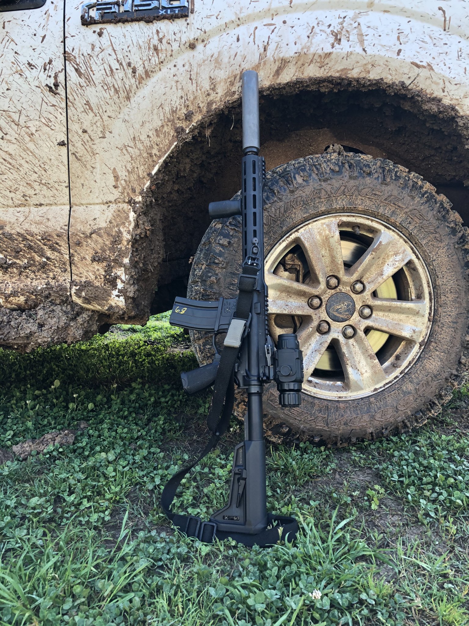

    Hell I killed (a very conservative) 5 hogs with it last night on a solo hunt, only had to get out of the truck once. Here it is on a 12.5” SBR for perspective:
