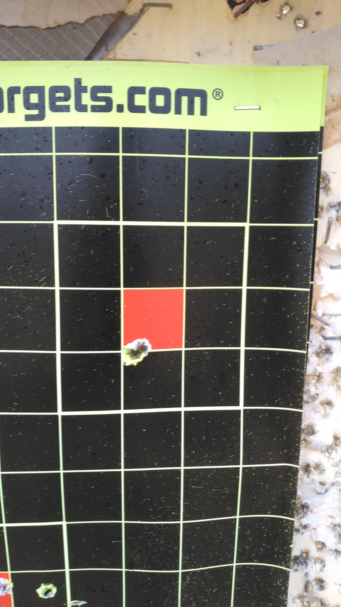

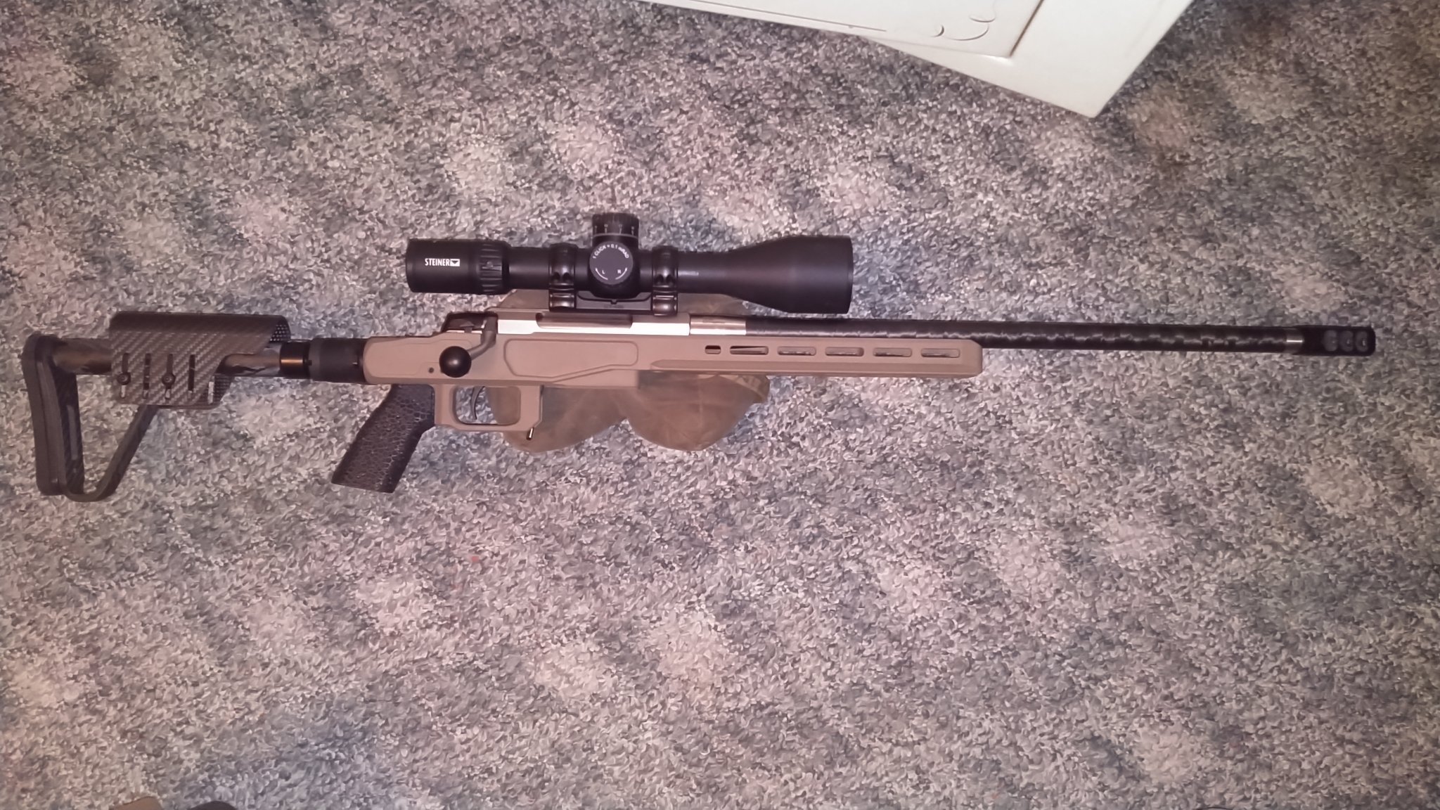

Just got my Tikka T3 hunter set done a couple months ago. Bartlien CF 22" #4 in 6.5CM, XLR Element 4.0 folder, Timney CE, Spuhr direct fit 34mm hunting mount, 3x15 Steiner M5XI (could get something lighter but it's bomb proof), Spartan tall adjustable bipod with Arc mag. w/o ammo just under 10lbs total It's a hammer thanks to DMR, group of a pet load used for brake in. (other photo w/4x16 P series but swapped on M5)
