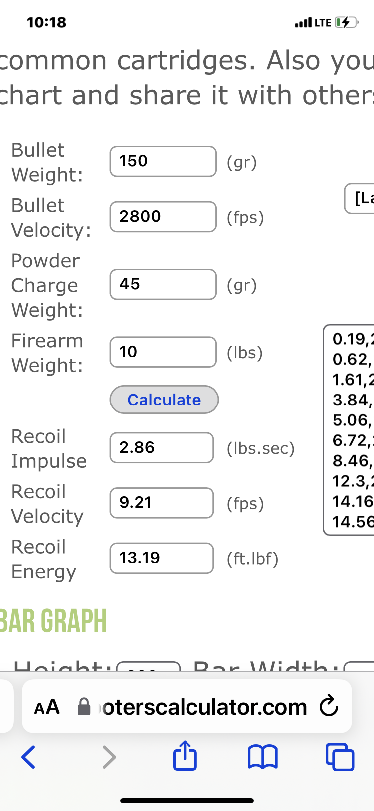

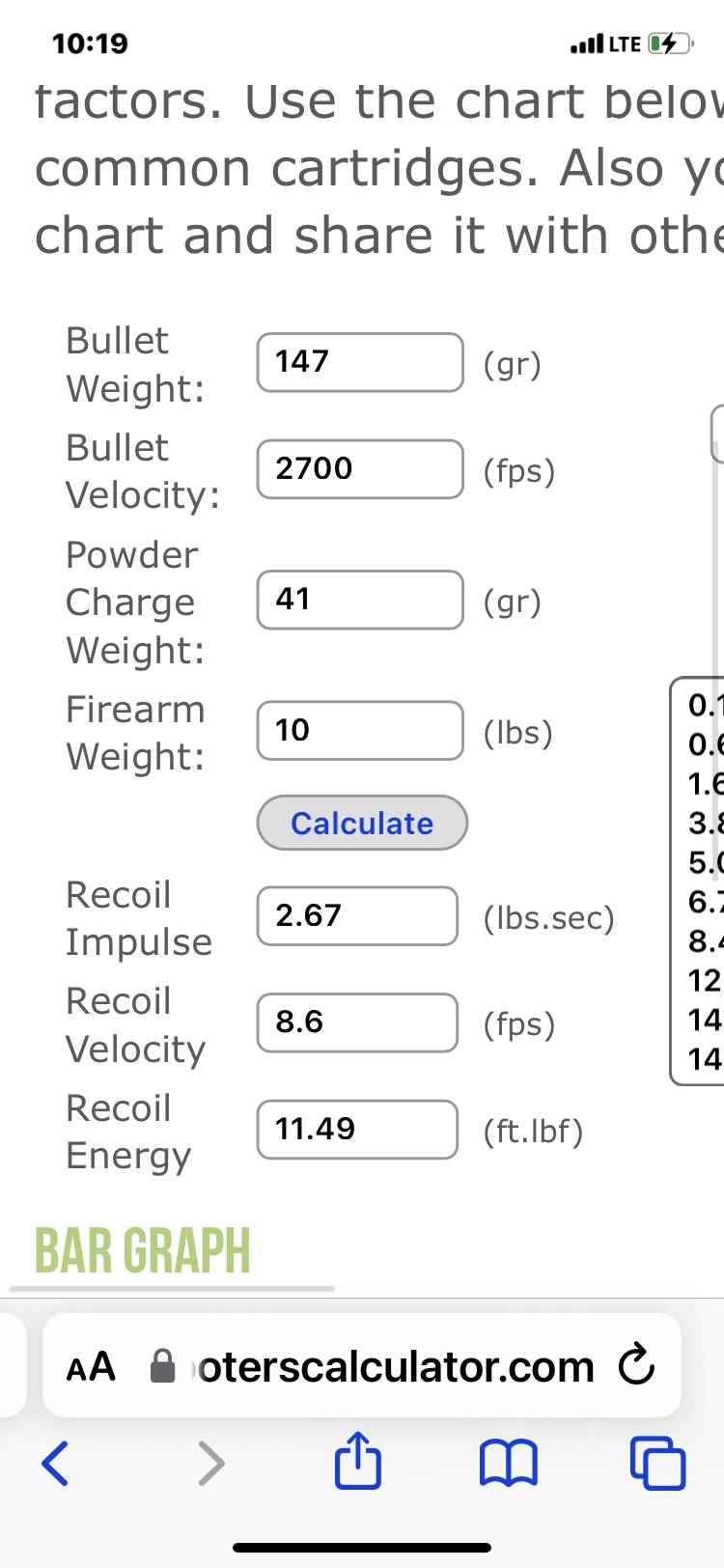

For all practical purposes, I do not think you are going to notice any difference. To figure out the recoil, I would look at data on energy a the muzzle, or even at 100 yards, not the speed. But, all things being equal, E=(MV^2)/2, so the velocity has quite a bit to do with Energy, as it is squared. Here, your mass is relatively the same, and you have a small change in velocity, so the .308 has greater energy, which will give it greater recoil in the same weight gun. But, not much.

Recoil is not a factor when choosing between 308 and 6.5. I've got several of both and its just not a thing. Especially as the rifles get heavier.
Even with the calculator its only a 10% difference. If you can "feel" that difference, you are probably selling something because between my ARs, M1As, and Bolts, its all about the same.
