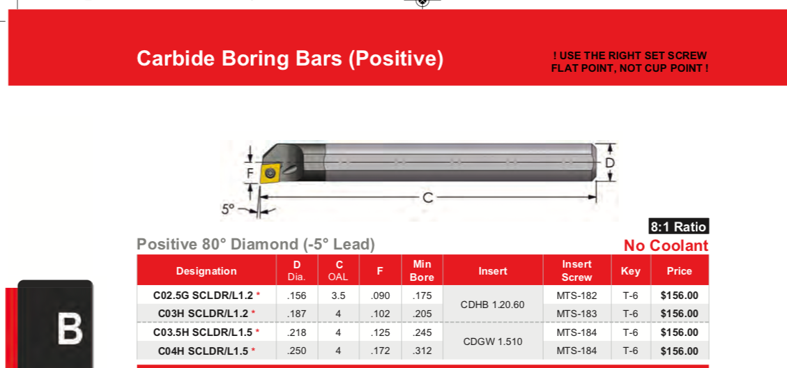

these are from a michigan company ultradex
1/4" after you pre-drill?
