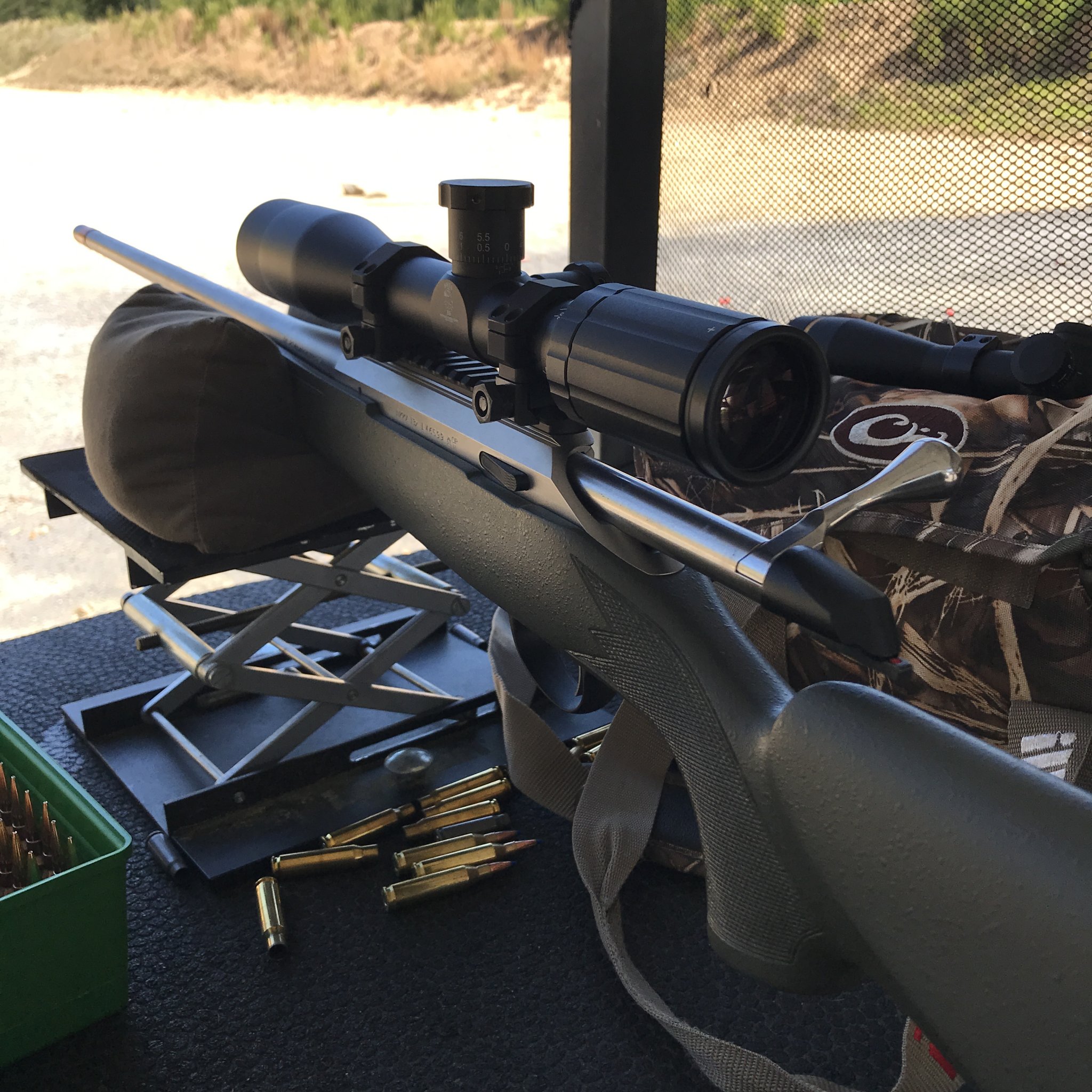

just acquired a Tikka T3X Superlight, all stainless. I like using one-piece scope mounts, so I'm looking for recommendations for a pic rail, 20moa. Anyone have any recommendations? THANKS!!
EGW. Just did my T3x 7mm RemMag and it's perfect. George and his team at EGW make excellent products. I've used them for 1911 parts for years and when I got my Tikka then found out they made rails for said Tikka: done deal.
I've fired 150-200 rounds since mounting and it's solid.
I just put an EGW on my Tikka 595 Master Sporter and I have zero complaints.

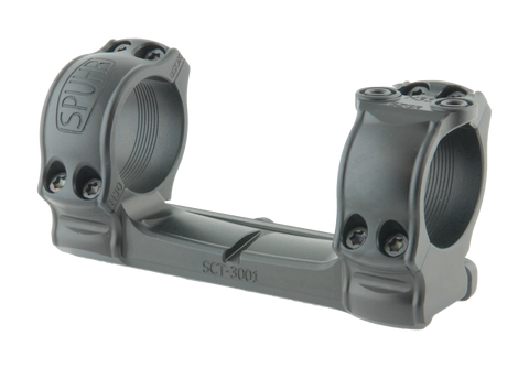

What I like about this particular Spuhr mount is that you can slide it all the forward to get recoil lug engagement then torque it to the dovetail. This is how AI was doing all their stuff before they started putting picatinny on everything. There is much more material engaged at the dovetail to resist forces from all angles as well. The base and rings being contained in one piece eliminates several other points of failure as well. And the cost is no higher than buying one of the bases mentioned above coupled with a set of nice rings.
I just went through this myself, and decided on the Area 419 rail. It is extremely well made, low profile, and includes a recoil lug. The Spuhr was in consideration, but I wanted picatinny compatibility across all of my rifles. Badger alloys and a SWFA 6x make this .243 nasty out to 500yds. Leagues above the Leupold 3-9/Talley setup I pulled off of it.
You might consider one of these.
I went with the Spuhr mount. The biggest issue to me with one piece mounts (I have 4) is the amount of fore-aft adjustability (or lack of). I saw that the recoil lug on the Spuhr has multiple locations, so it looks like fore/aft adjustability will not be an issue. Ill post something once I get the scope mounted and zerod. Thanks guys for all the input. Appreciate it!!
