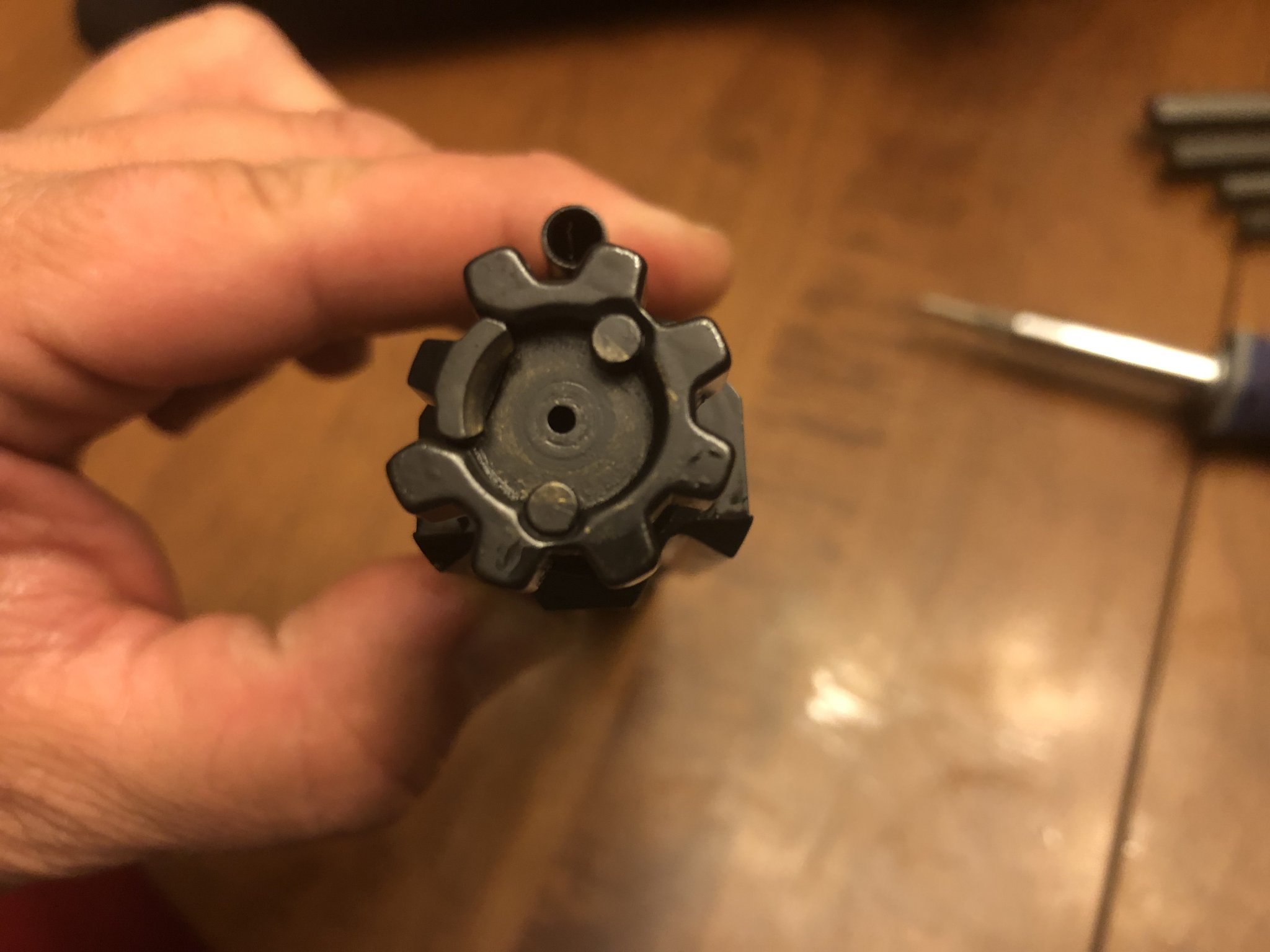

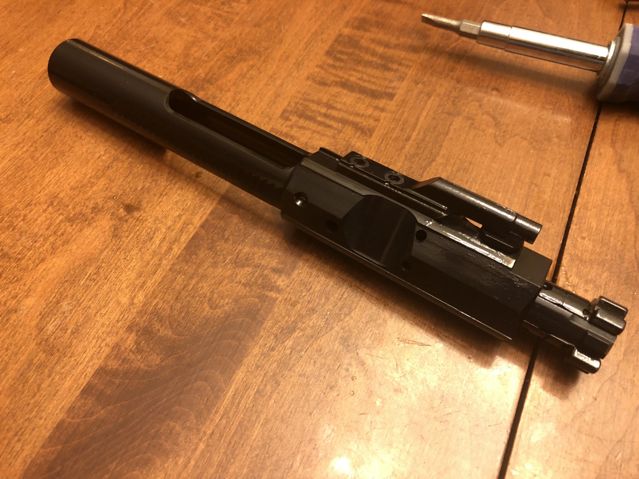

Does anyone know if Seekins SP-10 6.5 Creedmoor BCG is a Toolcraft-manufactured item? I like carrying a spare bolt to matches in case crud makes the gun go down. The two ejector bolts and carrier certainly look the same, from the few Toolcraft pics I find online. Seekins doesn’t sell BCGs or bolts for that rifle yet, or I’d just buy theirs.
Included photos are of my Seekins SP-10 BCG. Rifle is circa July 2018.
Thanks,
/David
Thanks,
/DavidView attachment 6940978View attachment 6940979
Looks exactly like my Toolcraft BCG that came in my PSA PA65 6.5 Creedmoor AR-10 and I am very impressed with this BCG. It's got the double ejectors and it beefy and seems to be a quality build. I've never had a problem with it loading or ejecting.
This is correct, they make the carrier and farm out the bolt.
