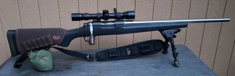

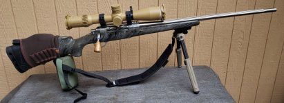

I can't count how many Timney triggers I have but I only have one Jewel, on a defiance 7mmSTW and only one Trigger Tech on a Rem700 250 Sav.
I have a lot of complaints about a lot of triggers, but none about those 3 brands.
