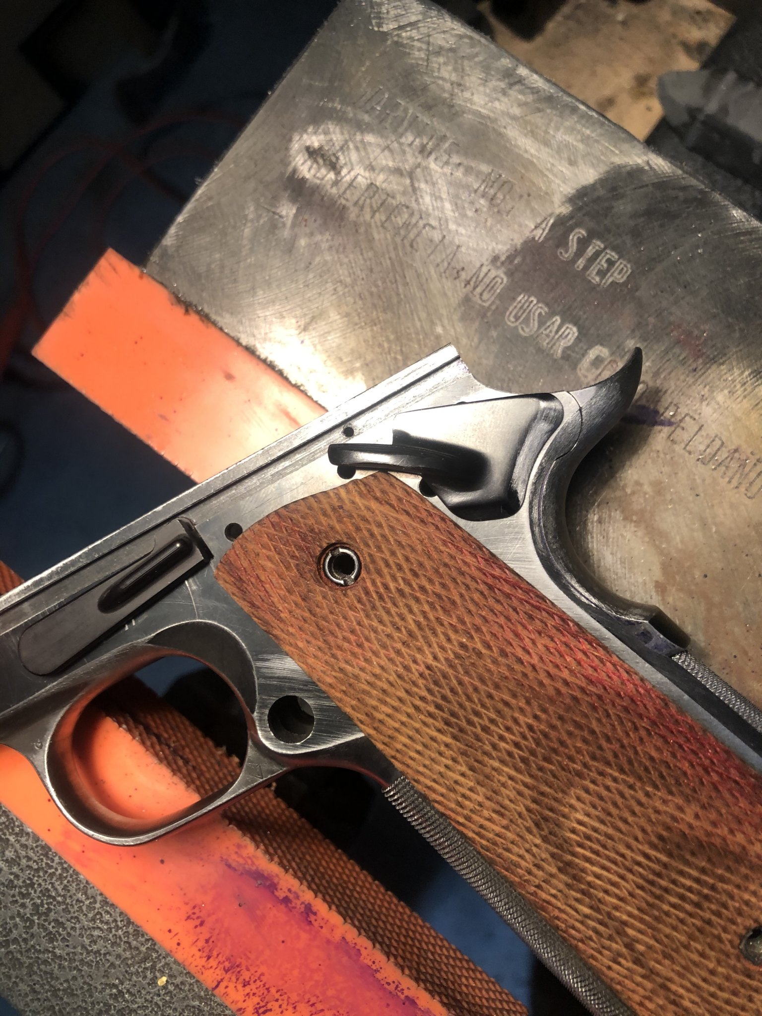

I’ve been working on a build and have been really happy with Wilson’s bulletproof parts. The concealment grip safety was easy to fit with their jig and the thumb safety and mag catch only needed minor fitting. Slide stop was straight drop in and came notched for easy reassembly from the factory.
