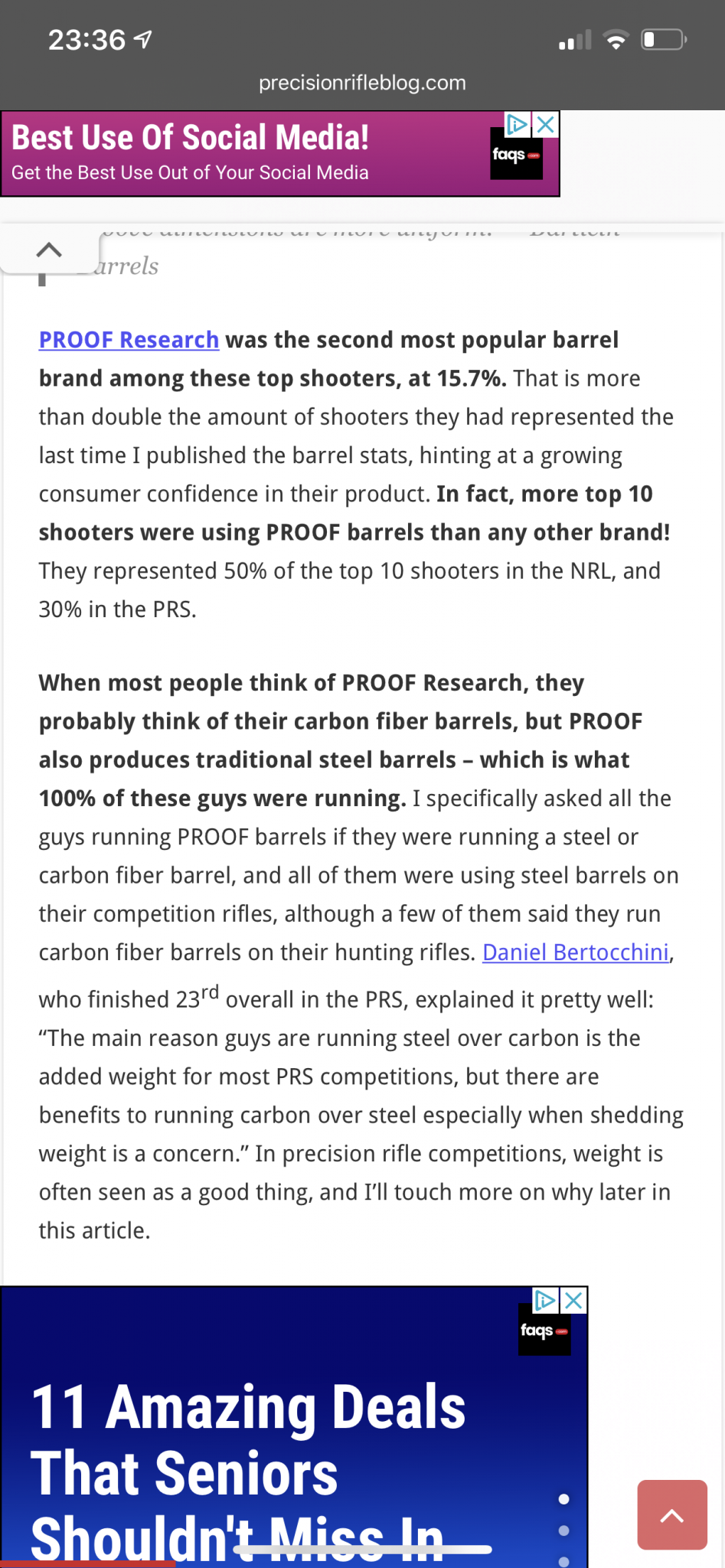

100% stainless steel. From the same site. See photo and link below.
That’s not to say carbon wrapped barrels are bad or anything like that. Depends on application. If I was building an ultralight for hunting or packing I’d go cf. But for target or match steel seems to be the way to go.
Reactions: RTH1800
OK, thanks for the info.....................very good to know.

I can’t swing the $ for the CF wrapped one. It’s almost twice what I had sort of set as my “budget”.
My only issue with the Stainless Proof barrel is that it’s roughly a full pound heavier than the Criterion/RA/etc options. The type of precision matches I shoot in aren’t from static positions; the max distance I’m shooting is 800yds but there’s offhand/standing/unsupported/whatever the match director comes up with type of shooting. I’m wondering if a 3lb 3oz Barrel is a little too much and that a substitute, but still good quality, option might be better for me
