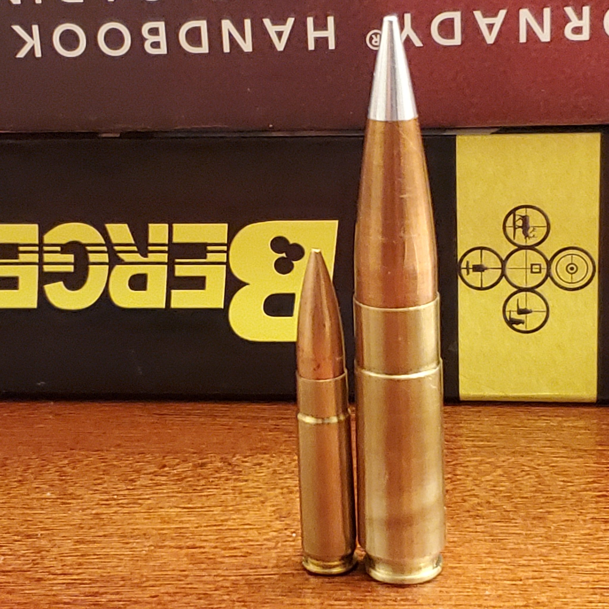

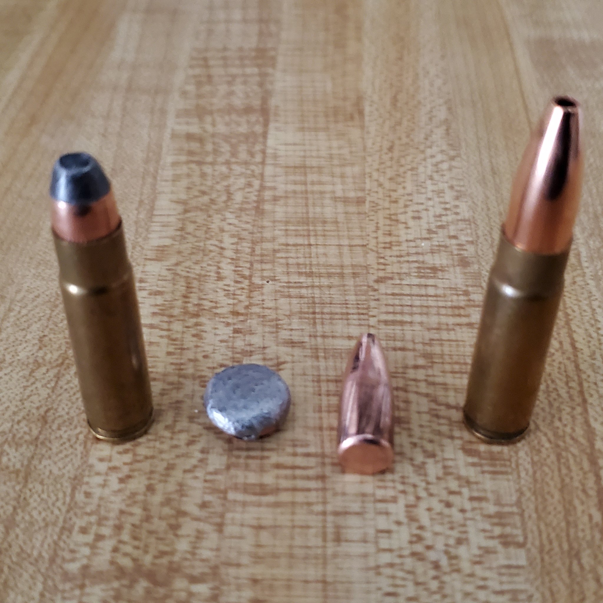

    Here is more unique, a 220 SMK 300 blk, vs a 750 gr 510 whisper.
    Or a 300 Blackout that actually mushrooms at subsonic velocities, the Speer varmint does not.
    A 9mm luger over 2600 fps from a 16" barrel AR.

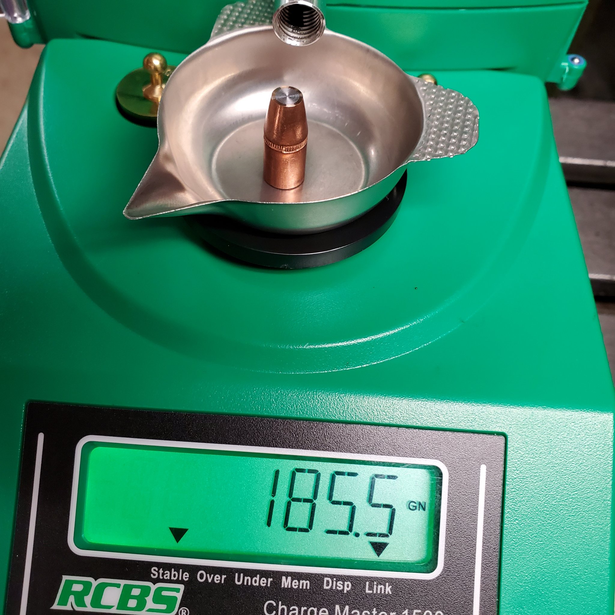

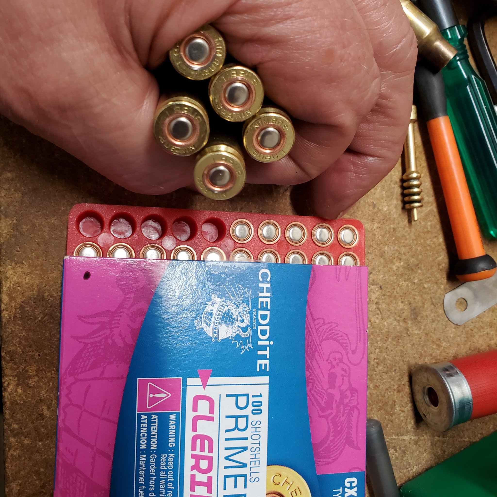

    A 185 gr 9mm luger, or shotgun primers in a 308 case.
    Making a die to take 30-06 to 8.6 blackout, one shot without case lube, but just a light spray makes it easier and keeps tbe cases from getting hot, while sizing the brass.
    Making 6mm ARC out of 308 Win or 35 Rem out of 308 Win.
    18" AR 200 gr SMK at 2673 fps. Or s 230 SMK at 2620 from a 308 bolt gun...and will be improved up on. Then there is hybrid cases reformed to other calibers.
    When in the experimental mode...almost nothing is left in its original condition, except no barrels under 16" for me anymore. I like performance of the longer barrels ...my 308s run from 16" to 30". Just got done loading done subs for 45-70 & 45-90...so that might be pretty unique...but almost everyone has or has tried the 300 blackout, it really quite common, with many variations...the way they like it I presume.
