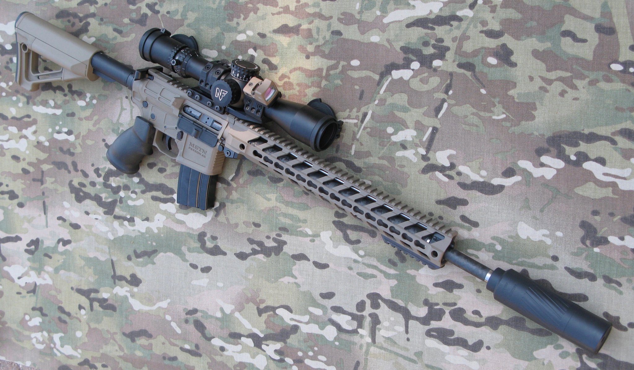

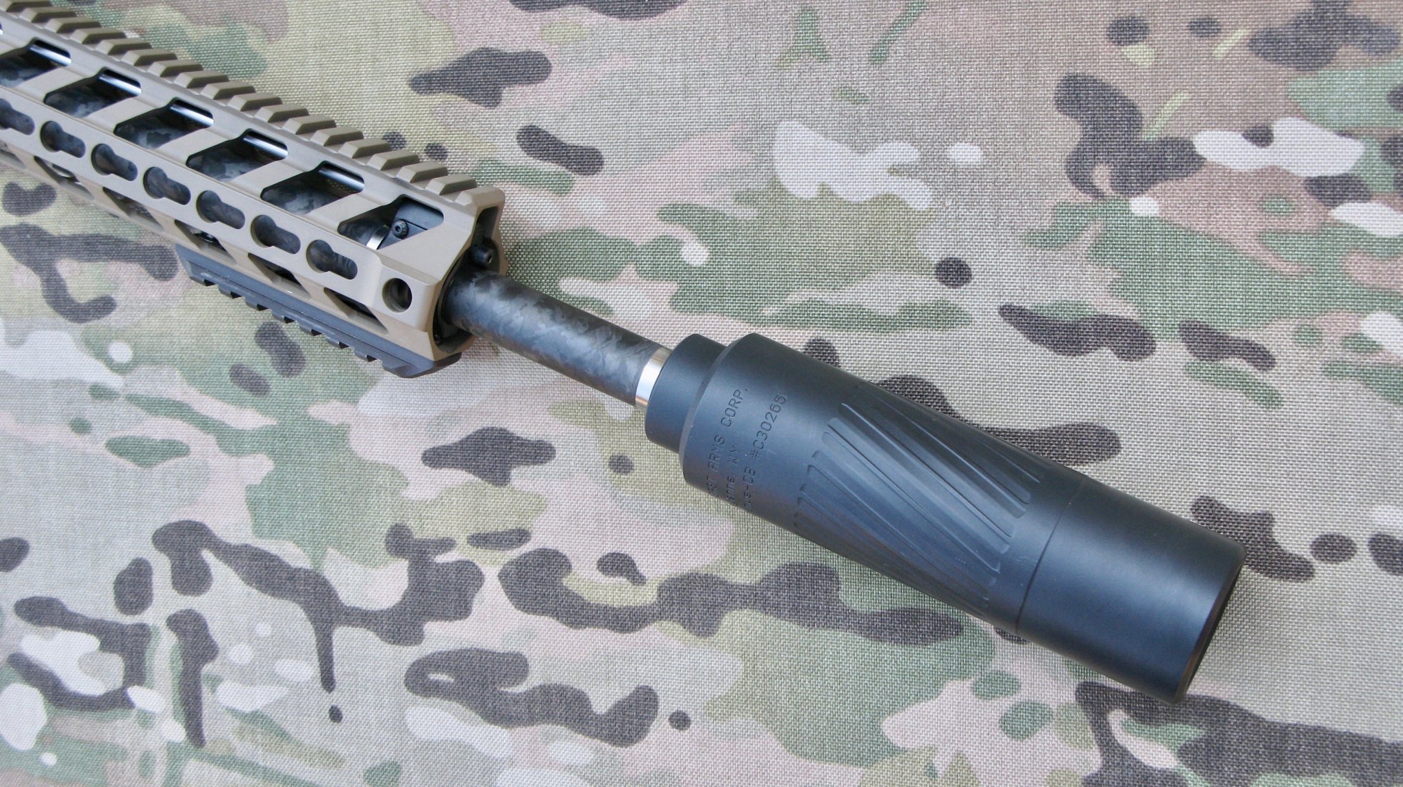

I am wanting to finish a medium range AR-15 in 6mm ARC. Leaning towards getting a custom Bartlein barrel spun up. Might shoot suppressed with a TBAC 30CB9. Looking for recommendations on barrel length, profile, etc. What is working well for you?
You never go wrong with a Bartlein. I went with a stainless 18” Proof and so far it’s shot well. I went SPR profile and it’s a little heavy with the suppressor. I wouldn’t go longer than 18 if it’s me.

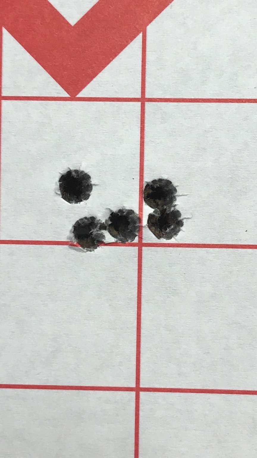

I've had good luck with my Proof 18" CFW 6mm ARC barrel shooting the Hornady 105 BTHP (2689 FPS):
Here's my first five at 100 yards the other day:
Wish I could do that every time ........

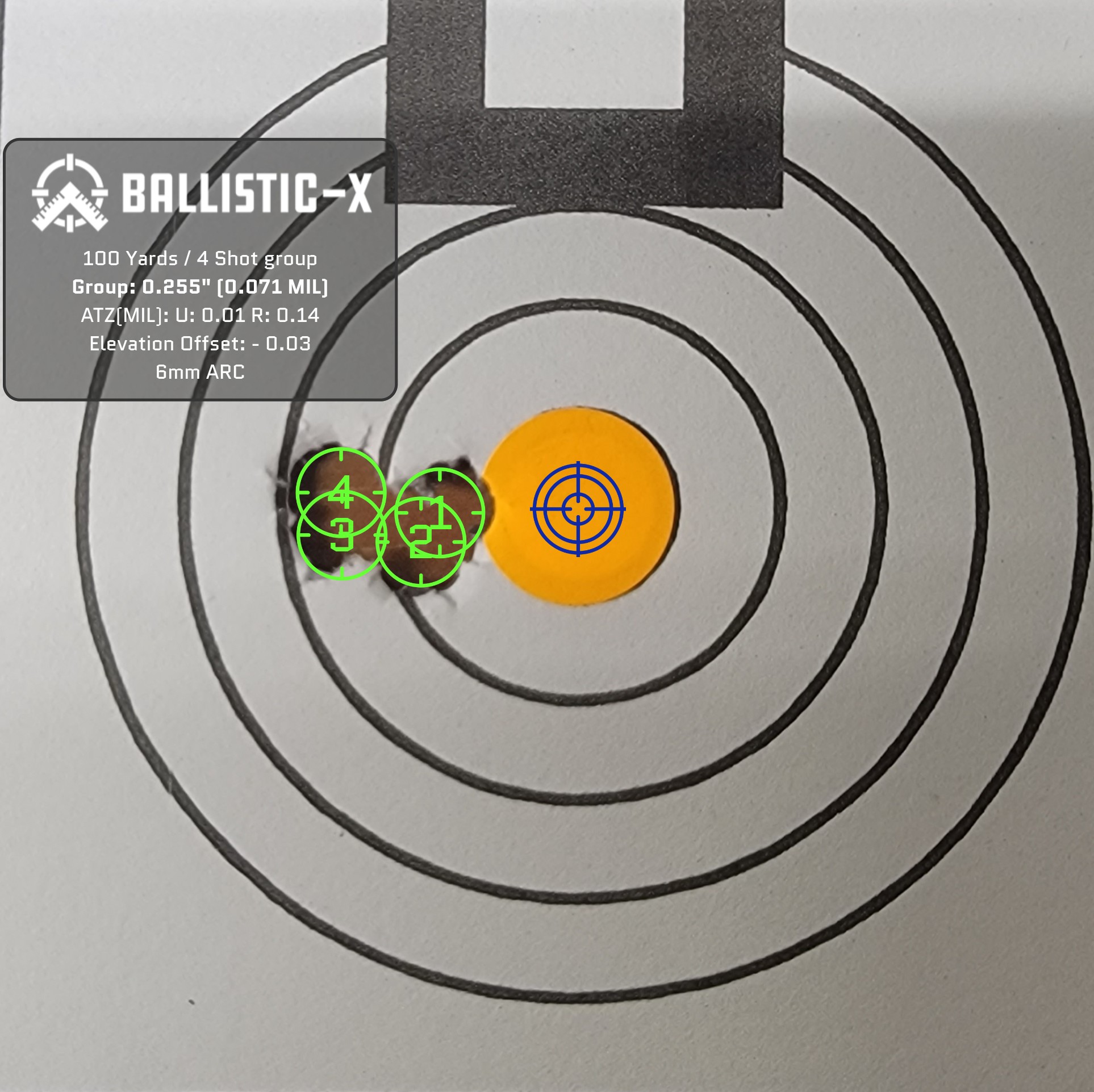

I've had really good luck with Shilen match barrels spun up by Mike Milli at Dedicated Technologies. Most have been in 223, but I had him do this barrel in 6 ARC. 20" medium contour, rifle length gas (.875 gas block), fluted and threaded. Turnaround was about 9 months, but worth the wait.
Took it out Monday for the first time and after 20 rounds of factory Hornady Match 108 ELDM, cleaned the barrel and decided to shoot a 5 round group. Despite the first round clean bore flier, I was pretty happy. I think it has potential.

@yotesniper66 ..........was the flier or "pulled " shot ,the 5th shot with the bolt locking open ? If so, load 6 and shoot 5........see if 5 th shot won't stay in the group . Have seen this make a difference................ Sometimes.
@NH4X. The numbered 5th shot was actually the first shot out of a clean barrel. I numbered them that way so I could remove that shot out of the group to see what the 4 shot group measured. I tried numbering in shot order, but I couldn't find a way to remove the flier without Ballistic-X removing the shots in order. This is the first time I've used Ballistic-X so there may be a way to do this, I'm just not aware.
