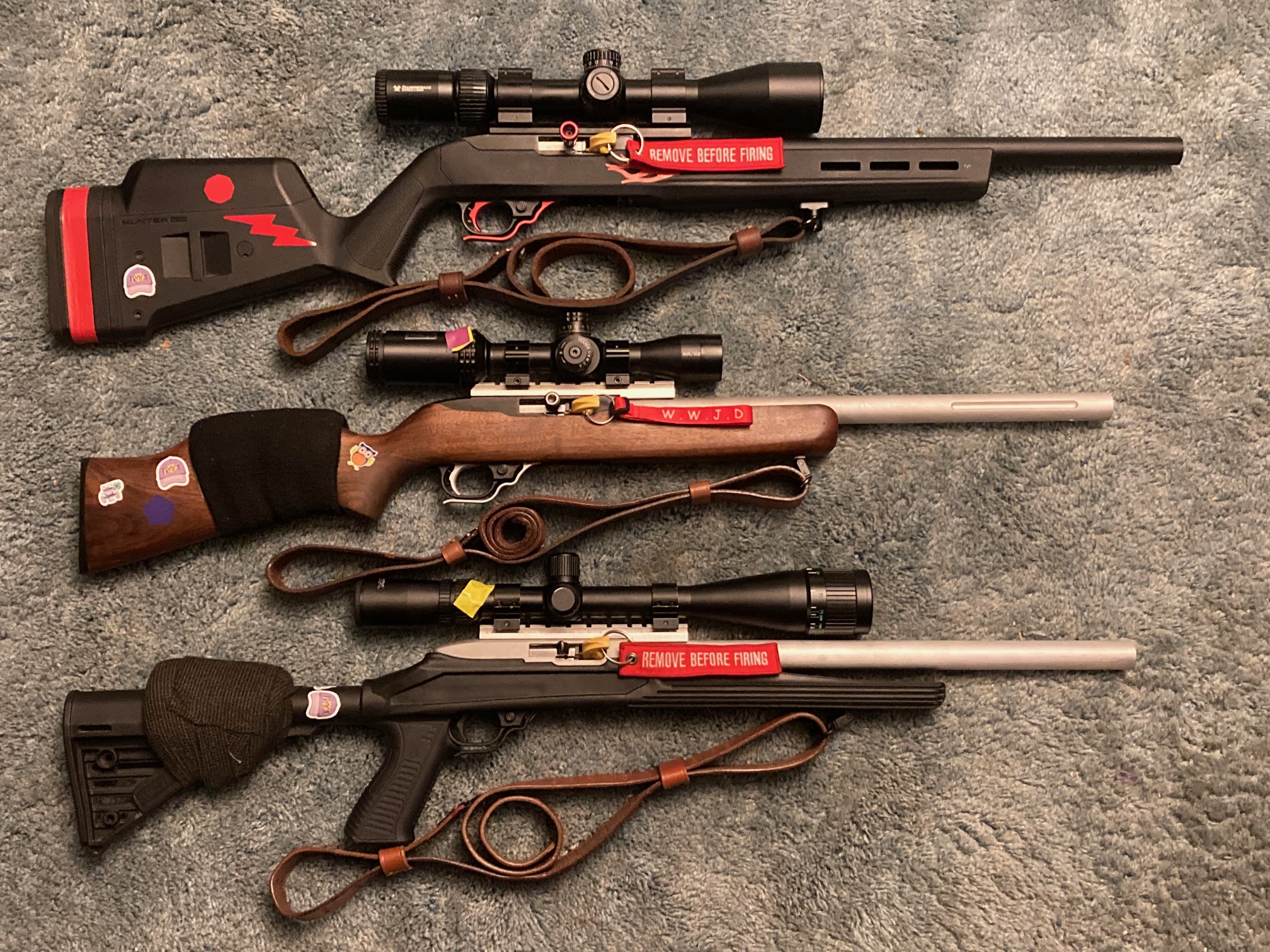

Can't go wrong with a BX trigger. For a rail I'd suggest one of the Power Custom rails that extend forward over the barrel. The extra length is handy when mounting a scope to get proper eye relief. All three rifles in the photo below have the PC rail.
https://powercustom.com/store/index...oducts_id=84&zenid=gij2s16i1m6ig7id5n656a5hs3
Some like an extended mag release, and they are available from multiple vendors. You will probably also want an adjustable stock to better fit your kids. I'm kind of partial to the Magpul X22 Hunter, have two of them (top in photo below). One of the Brownells youth stocks (center rifle below) is excellent for a child but probably wouldn't fit an adult. The Blackhawk Axiom stock (bottom in the photo) is a quick-adjust and works well for both adults and kids.

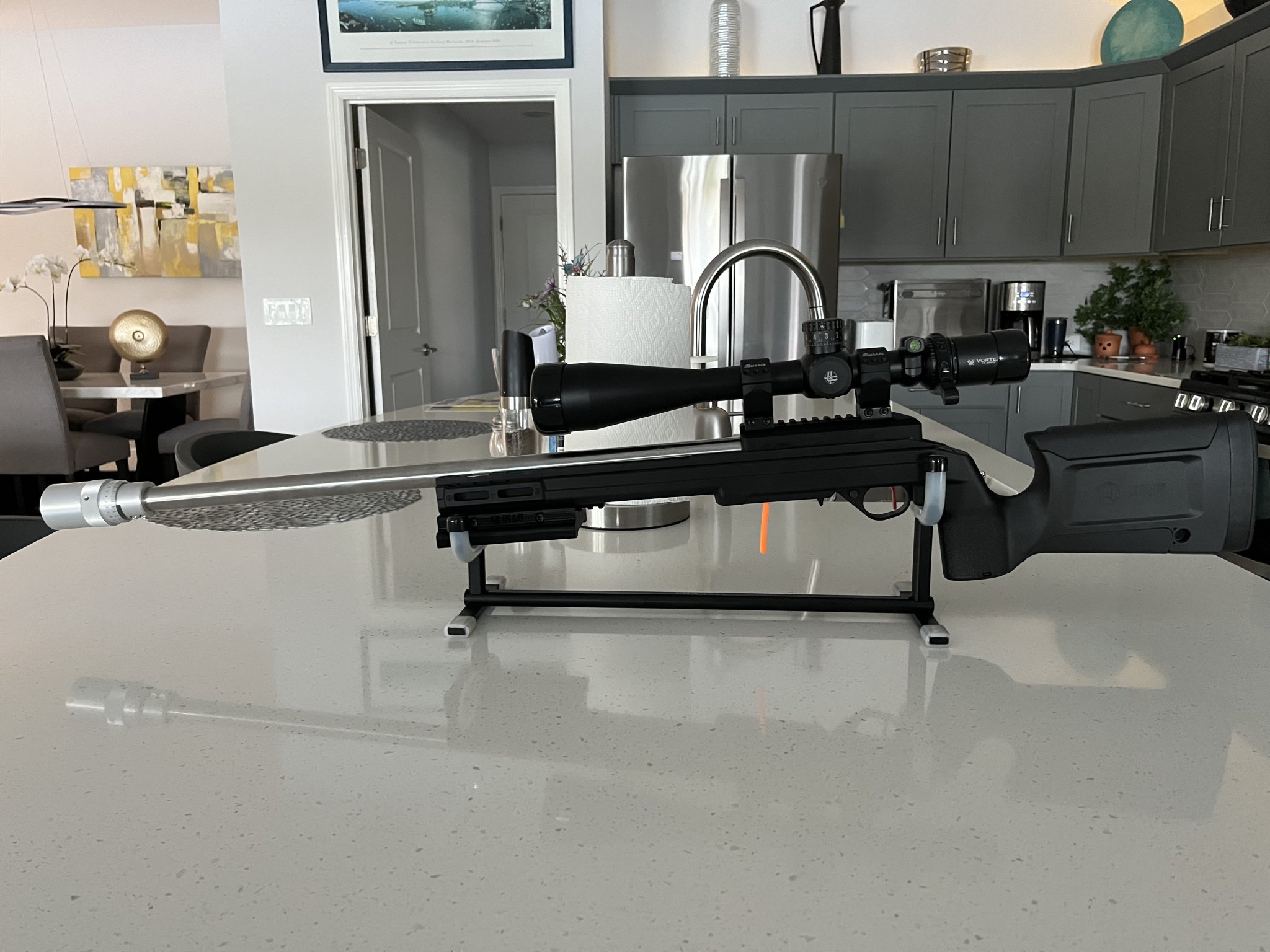

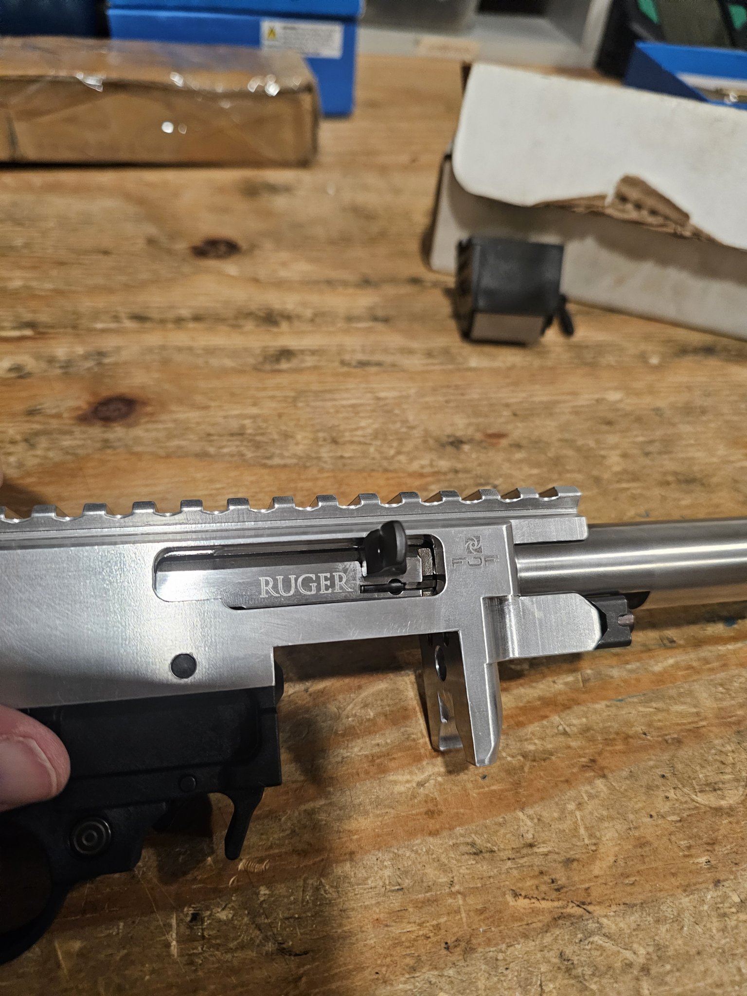

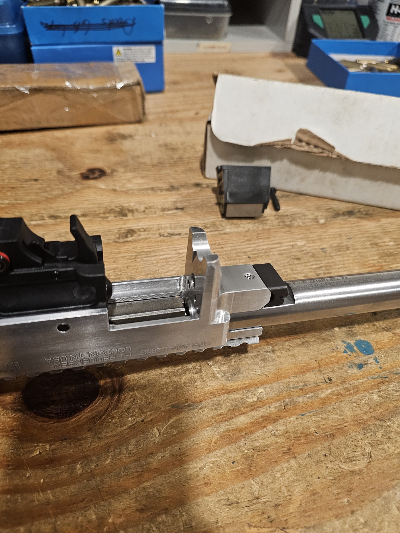

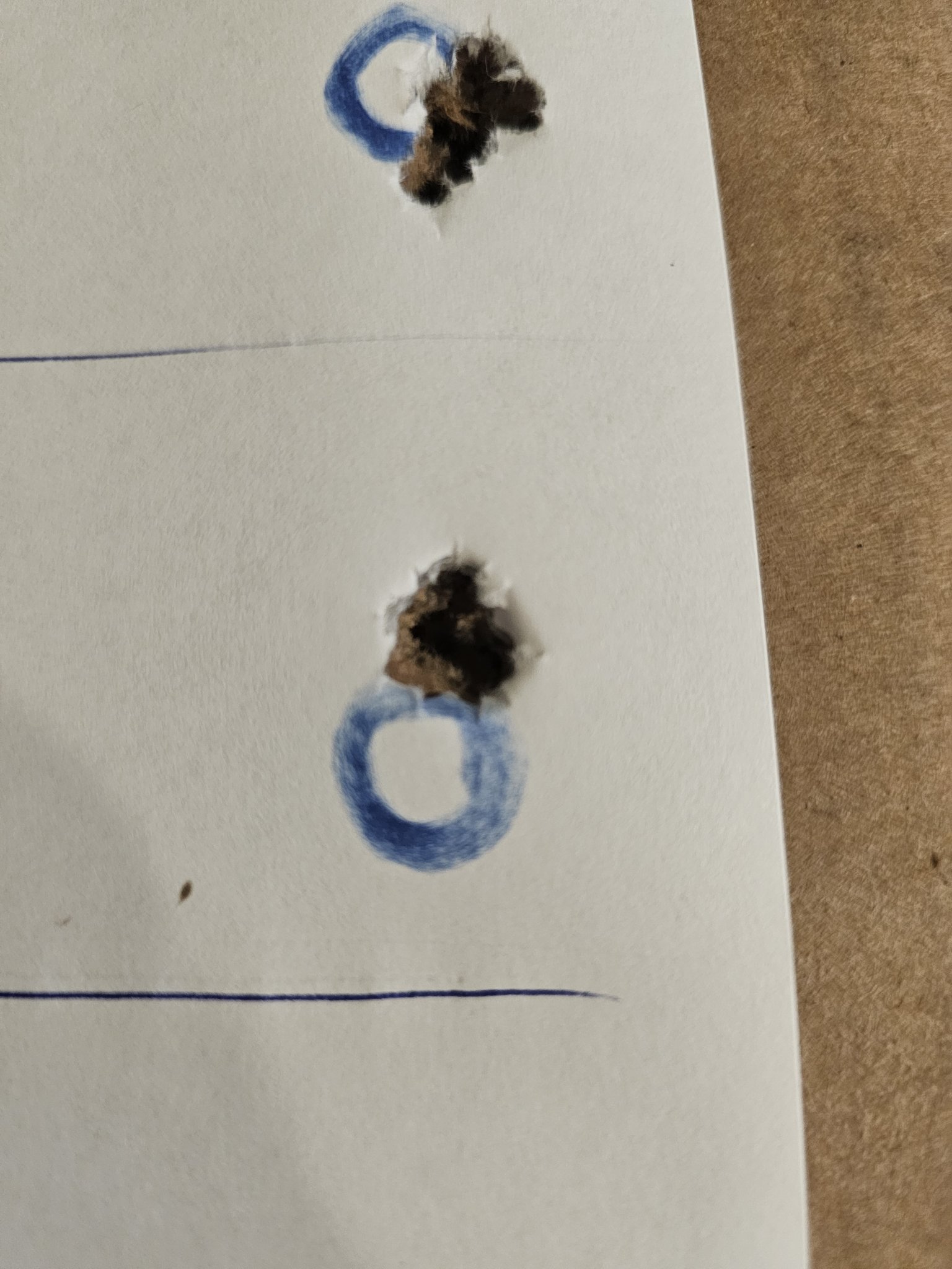

I just had Feddersen polish up one of their receivers and barrels. Man it turned out great. Such a smooth action. That group is 10 rounds of Eley Club at 50.

Is that a bone stock bolt or one with the headspace set and dowel pinned? Also how tight did the barrel fit into the receiver? I’ve been thinking about that exact combo. Groups look great for bargain match ammo!

It's a stock bolt. Feddersen sent me the barrel and receiver already together, but I'm sure it's tight. Really a great setup. I've got it listed right now, FYI. I want to go back to a r700 compatible setup.
