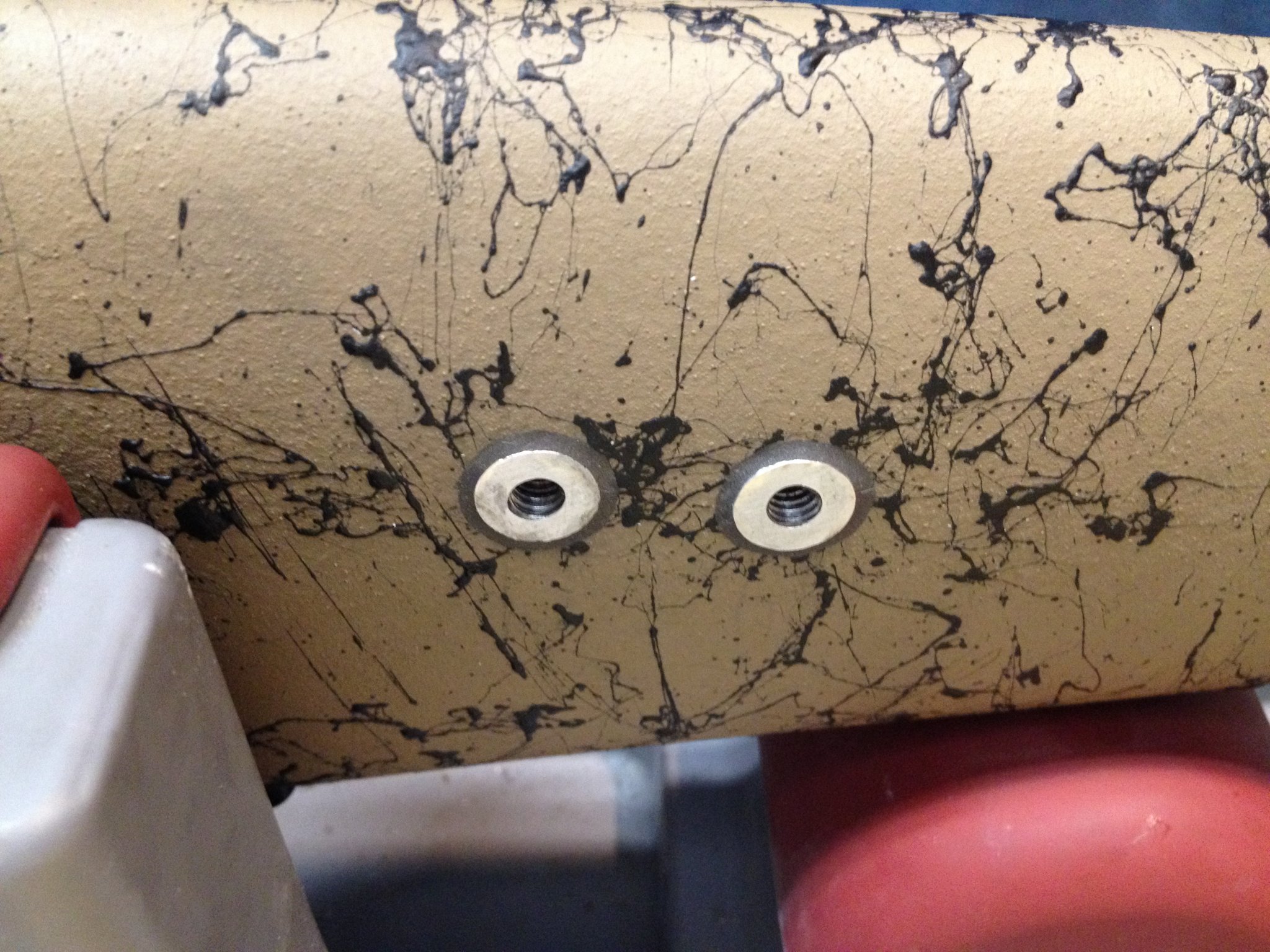

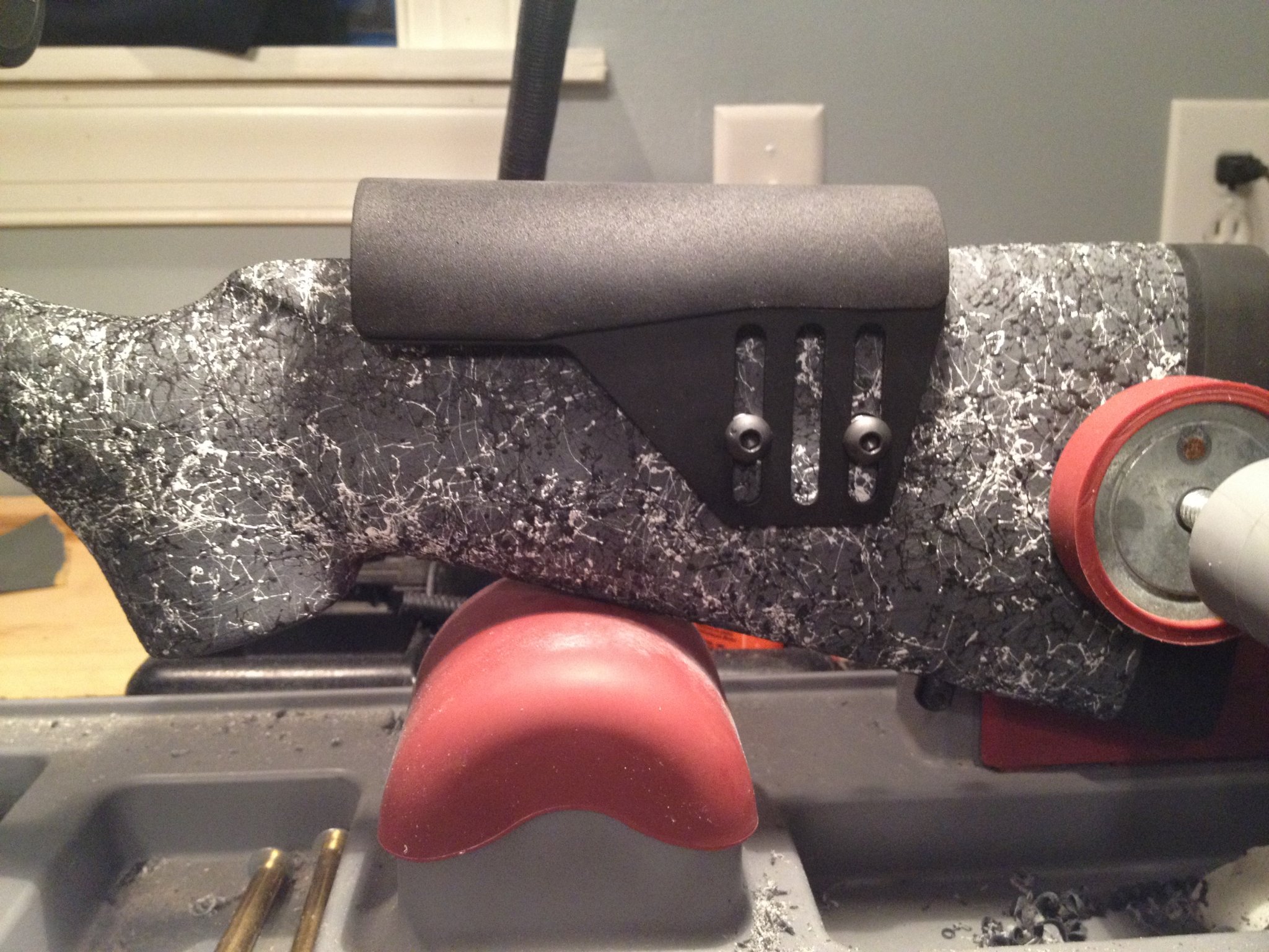

I have set up about a dozen rifles using the XLR Cheek riser and 1/4”x20 pitch standoffs from Grainger. You have to cut them to length from each end (threads dont extend all the way through so you can cut all from one end.)
I either devcon or g-flex the standoff in place depending on how snug the fit is in the drilled holes.
2 examples below. One woth riser installed and the other with it removed to show the standoffs.

I researched a good bit before using the XLR and the stock modification is not too displeasing even with the riser removed. It may not be for everyone as it tequires some skill to get everything lined-up, drilled squared and set.

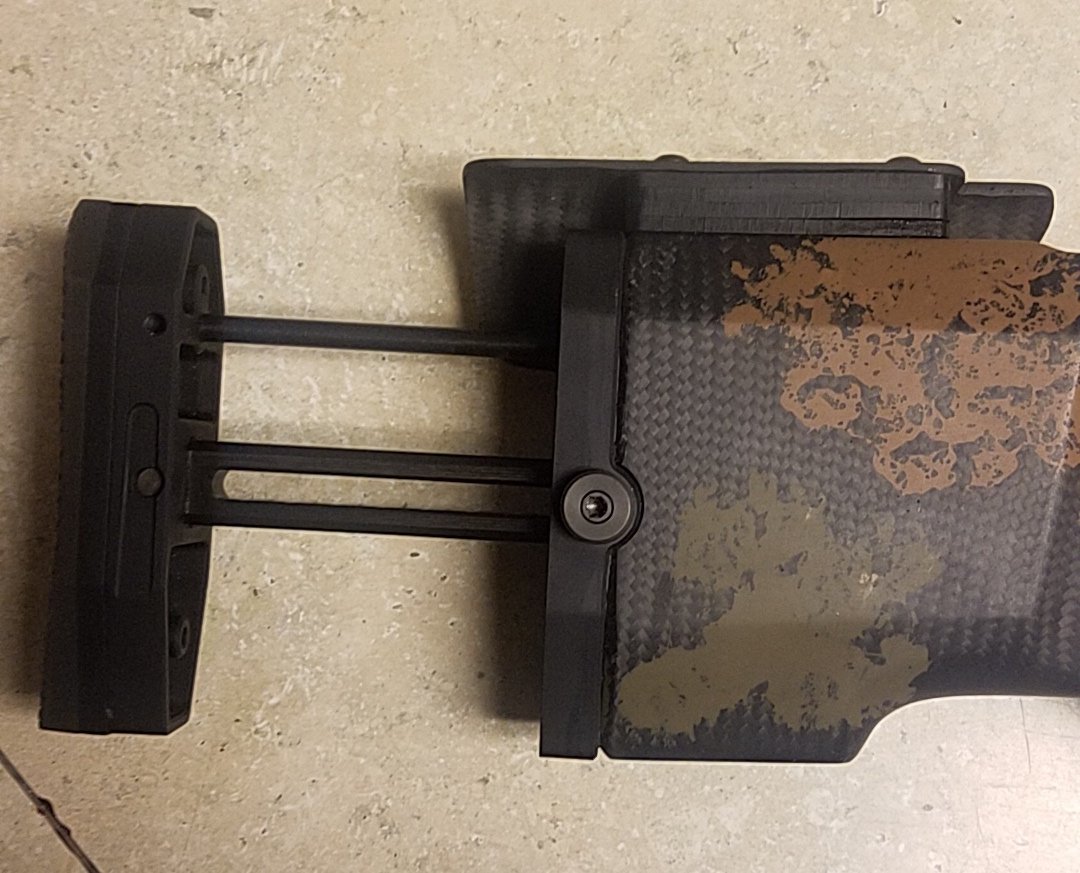

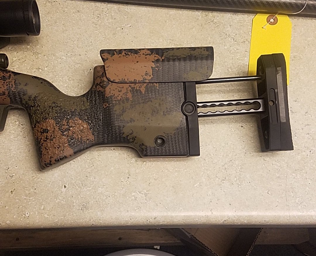

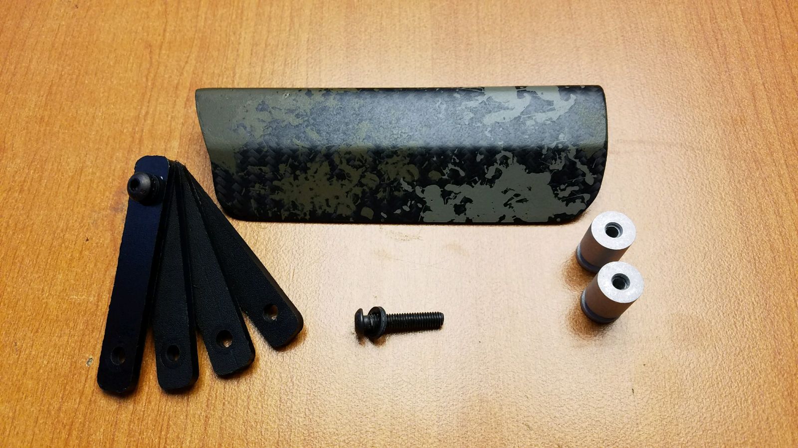

Here is a pick of the carbon fiber that was designed for the mcs-cs shorty stock that will also work on the EH1, it weighs in about 2 to 3 ounces. Nothing fancy, simple spacers for height adjustments. thanks

They are! I talked about it to Robert from Manners when I was ordering my stock. He said they can paint match the scheme you have and ship it out later if you decide later you want to add it or if you already own the stock.
Here is a pick of the carbon fiber that was designed for the mcs-cs shorty stock that will also work on the EH1, it weighs in about 2 to 3 ounces. Nothing fancy, simple spacers for height adjustments. thanksView attachment 6928524View attachment 6928525View attachment 6928525
I do like it. Robert did an excellent job explaining it and showed me some sample photos on instagram. I honestly hope I dont need it, love the appearance of the stock without it, but this is a very nice looking option.

EH1A is about a pound (18oz exactly) heavier. Their add on kit is about 2-3oz.
