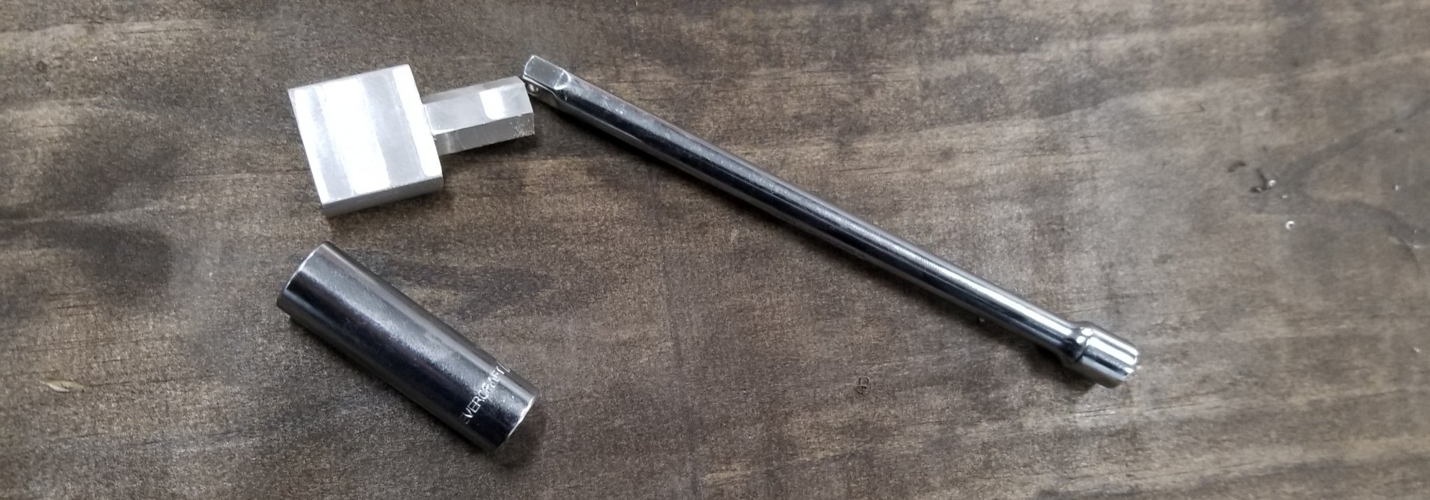

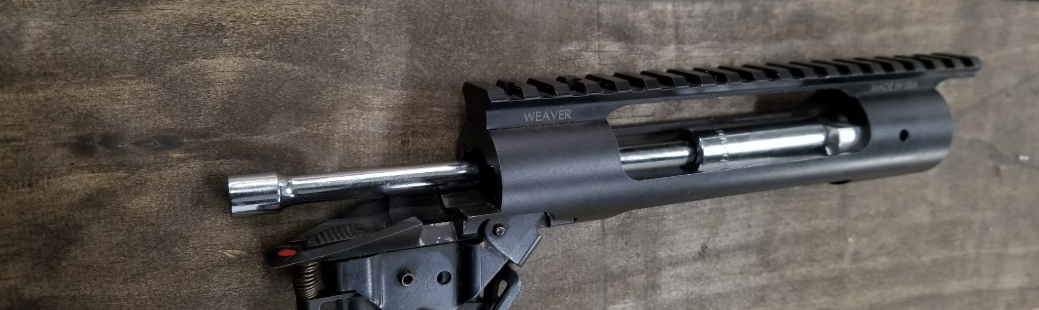

Surgeon action wrenches work great and I like them, I misplaced mine so I whipped up this one, not really cheaper if you pay yourself for your time but if you have the time and tools...ps found it the next day after I made it... have since made other wrenches for other actions the surgeon does not fit...
