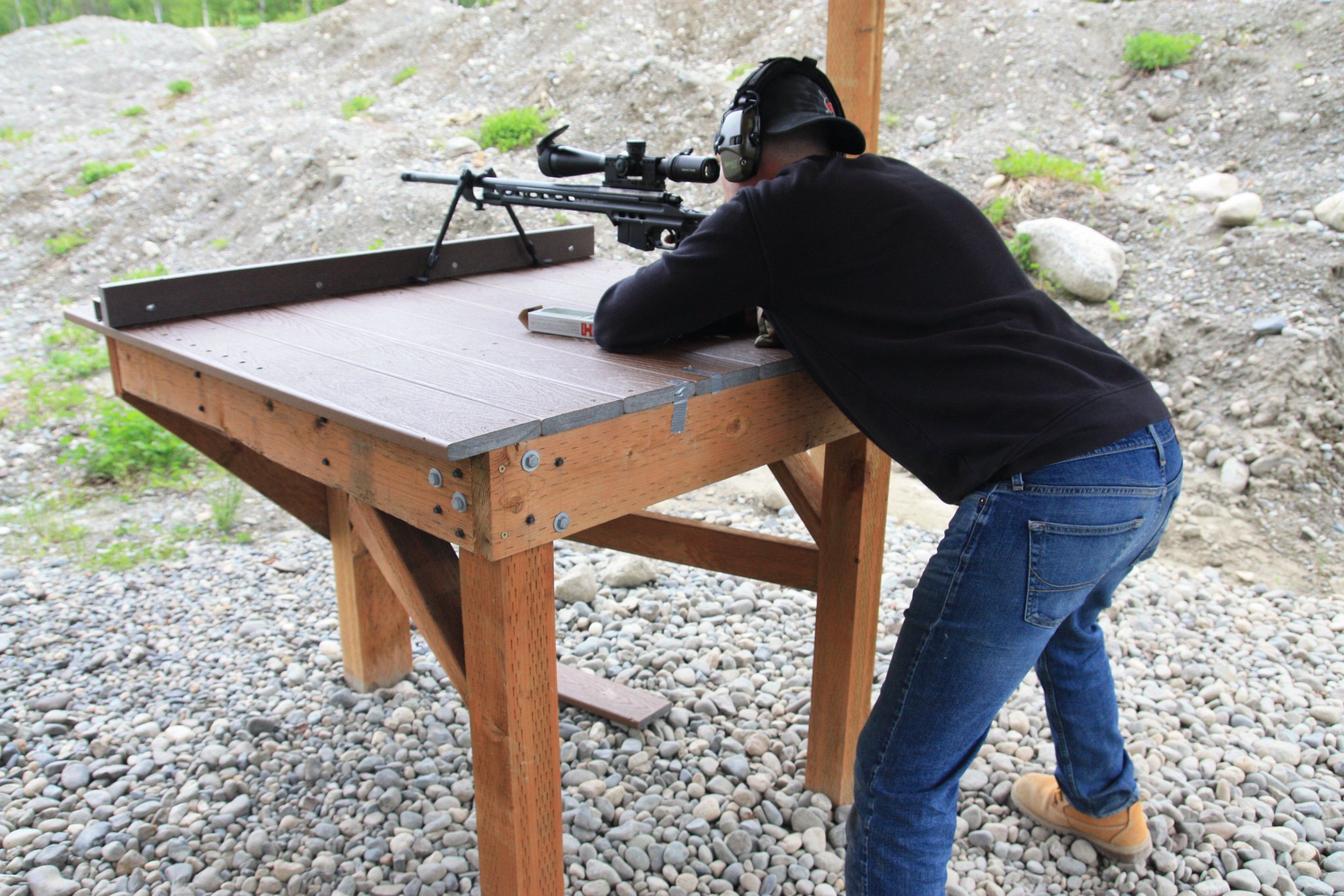

You the bench square, so you can stand straight up behind the rifle properly
If you want to sit at the bench, make it low so you can get your shoulders in front of your hips,
This position is no different from prone, we put all our older students on these benches,
The rail up front is adjustable too, the holes on the side.

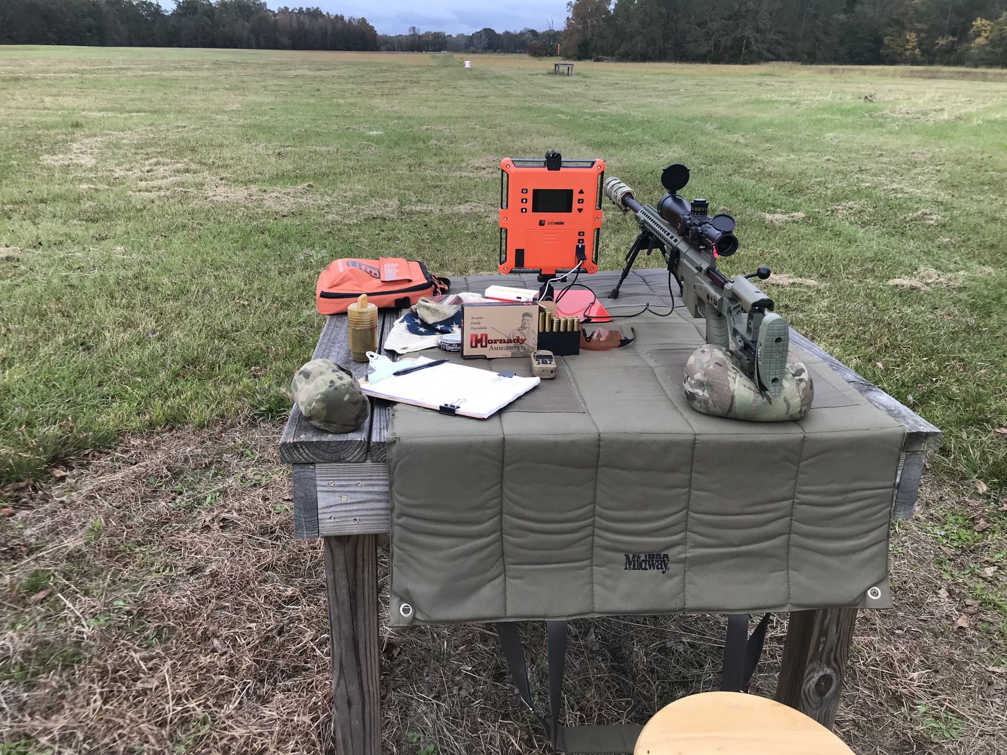

so that it promotes bending forward and forces you square. If it is a seating bench, build lower than what you see at the public ranges as well. The table should low enough that the shooter is able to sit in the chair and duplicate the feet, hips, and shoulders perpendicular to the rifle as in the image. When you attempt to do that, you'll notice the rifle bench must be lower, or the chairs much higher. Higher chairs are not the proper solution.

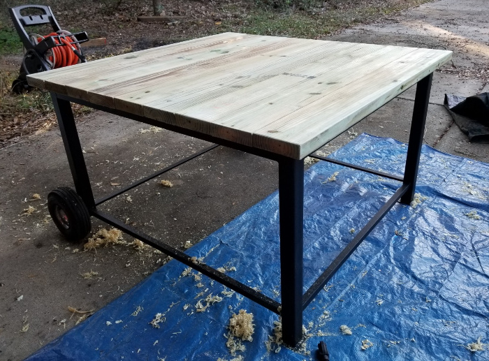

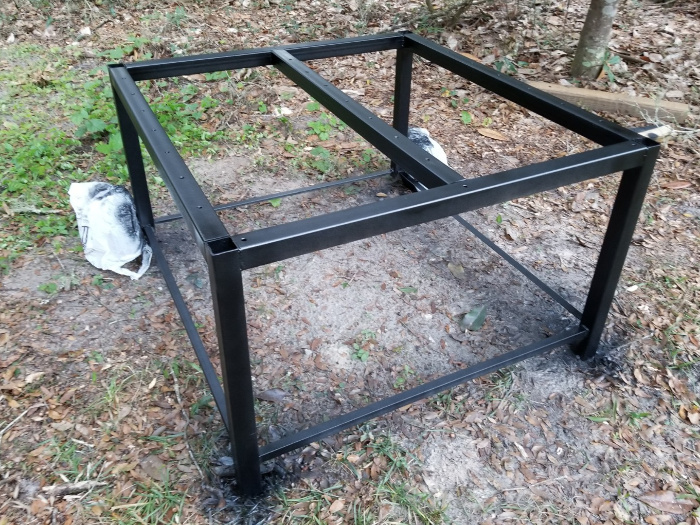

It's too late for advice to help me now. This afternoon, I bought $100 worth of 2" square tubing, some angle iron, truck bed paint, and a bunch of screws. Looks like I'm committed. Tomorrow I'll pick up some two-by-sixes for the top.
In retrospect, 1/8"-wall tubing was overkill. I will need the tractor to put this thing in place.
Based on what I learned here, I'm making a simple four-foot square table with a height of around 29", depending on how deep it sinks into the pasture.

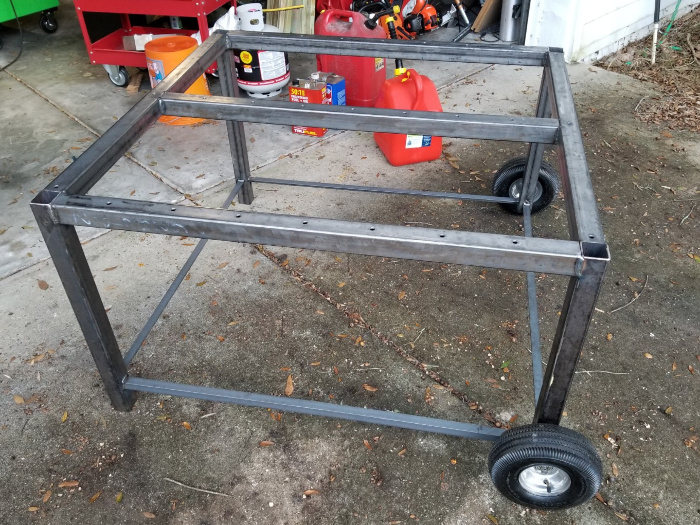

Mine is just scrap warehouse racking that I welded into shape. Then carriage bolted three runners from the decking so I would have something to screw the top decking down. Then put a few coats of left over deck sealant on.

Thanks. I had wheels left over from another project. Bits of bar, too. Made axles on the lathe, pressed them in, and welded them in place. There is no such thing as scrap.
