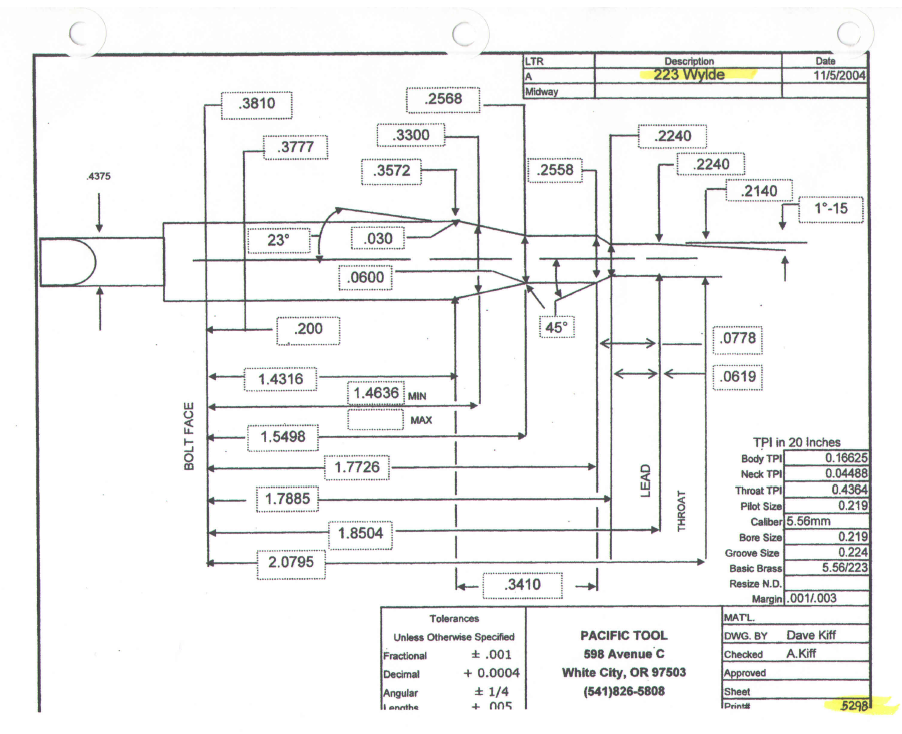

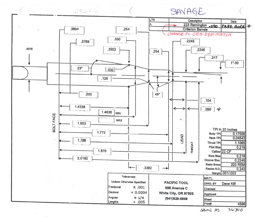

I would probably go with the northland 7 twist criterion in the 223 match chambering for those long 88s. The match chambering has .090 of freebore as opposed to the .062 of the wylde chamber.
I have a PVA remage in 223 but it is a wylde chamber with the .062 freebore I believe (hes never corrected me on that spec when I say so on these forums though he wont share his proprietary reamer print that hes designed, it does work well though) that shoots wonderfully but I think he only offers it in the wylde chamber. Im loading the 75eld for it and I think that with where Im at now the additional .030 of freebore couldnt hurt and the bigger bullet shouldnt be thrown off too adversely. (Wylde is the safe answer if mag feeding right up on the lands for every bullet under the sun is an absolute requirement, Id hate for you to get something and then in your certain scenario it wouldnt work even though I think it would. Thats why I didnt mind the wylde chamber from PVA)

These will need to mag feed. Would love to shoot the 88's just wondering if I can push them fast enough out of a 26" or if it wouldn't be better to go with the 75's in a Wylde chamber. I was told by Northland the Wylde had .078 free bore and the Match chamber had .090.
Going to take this moment to shine a light on some of the differences in terminology between... well everyone. They claimed .078, thats from the end of the neck diameter and the beginning of the transition to the freebore diameter. The .062 is what I was referring to which is from the end of the transition. Two different people talking about the same reamer but different certain little aspects leading to differing info.
Here is their print for it that they had sent me for the Wylde.
Here is their match chamber print
