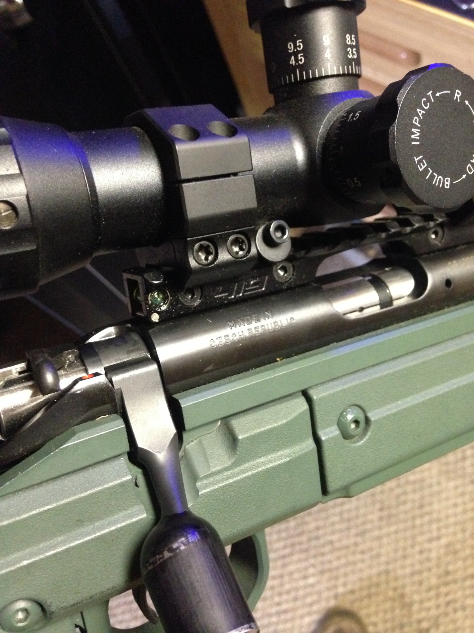

I'm running a DIP rail and Vortex precision match rings 0.87" height on my 457 MTR. I'm running an Athlon midas tac 4-16x44 though.
Area 419 15moa rail on my 455 American varmint stock with low vortex rings fits my pstII 5-25 easily. Ive also had a 44mm scope on it. In both cases the stock was the limiting factor, not the rings. Ive needed a badger cheek rest on mine to maintain the needed stock height. (If anyone has a 30moa A419 rail Id love to trade!)
