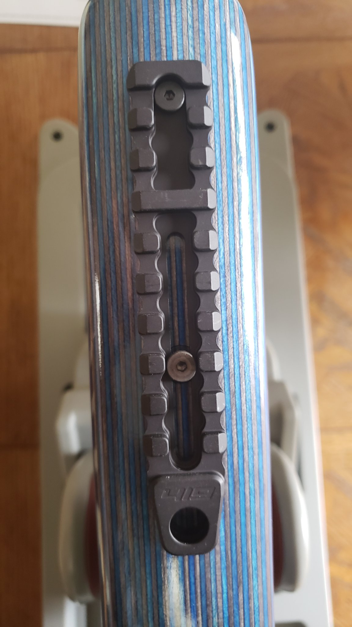

a few items to consider - a cheek pack to increase the comb height, Area 419 bolt knob, 10 round magazine and some decent ammo. Give the SK Pistol Match and SK Standard plus a try, green and yellow boxes. They shoot incredibly well out of my 457.
Scope related - Vortex Defender flip caps, throw lever and bubble level are all nice additions, but not as critical as the ones above to me.

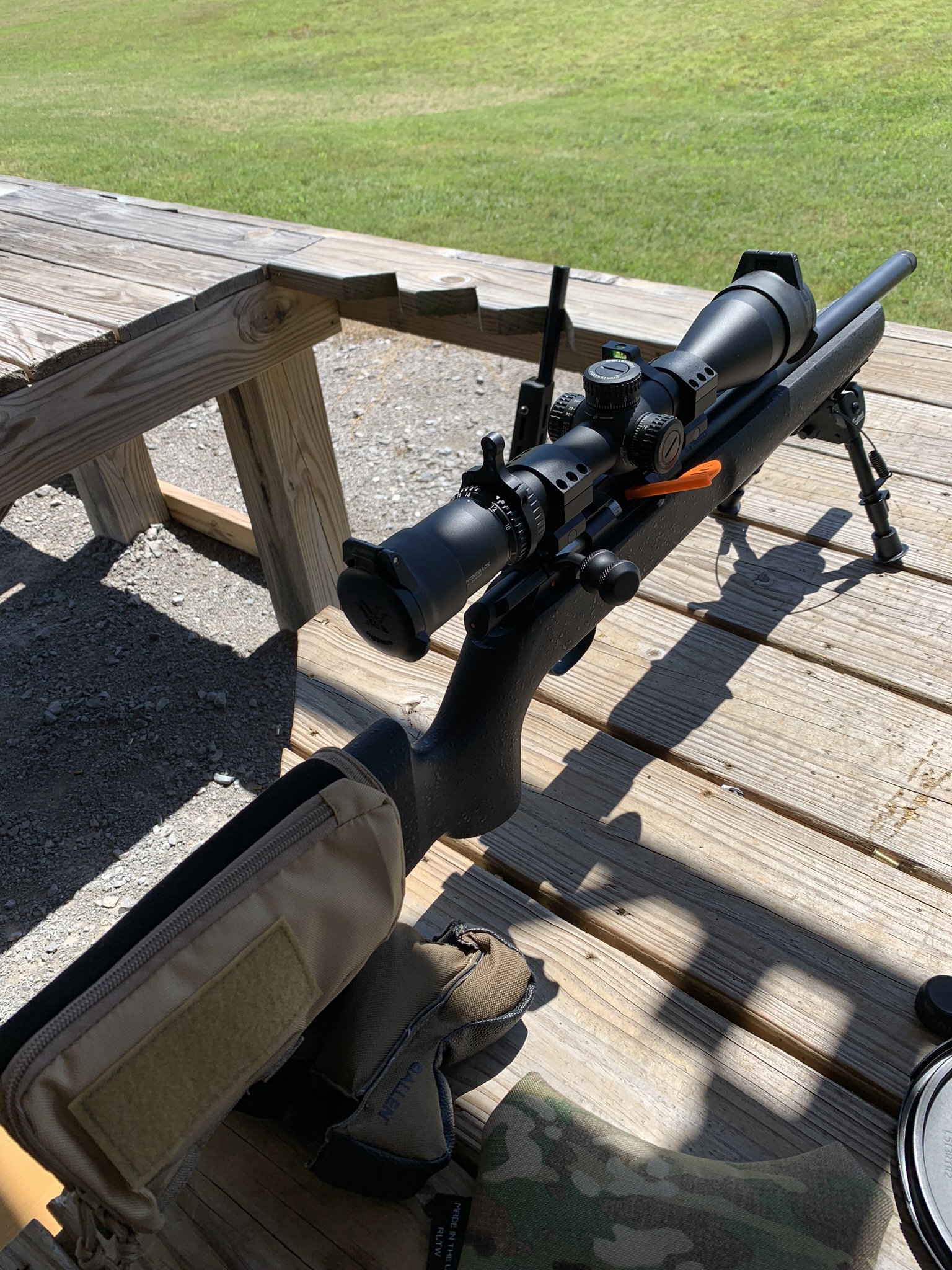

Just my opinion, but unless you really want to trick out a 457, not much needs to be done. My trigger was really good out of the box, but is easily adjusted if need be. I added a DIP extended mag release, an Area 419 bolt knob, and did some light filing on the bolt to smooth the cycling.
Be mindful that rail will raise your scope quite a bit. I tried the 419 30 moa rail and it just didn't give me a good cheek weld. My rifle started as a 457 Varmint and I thought about having jducos work his magic on the factory stock comb, but ended up going this route instead.

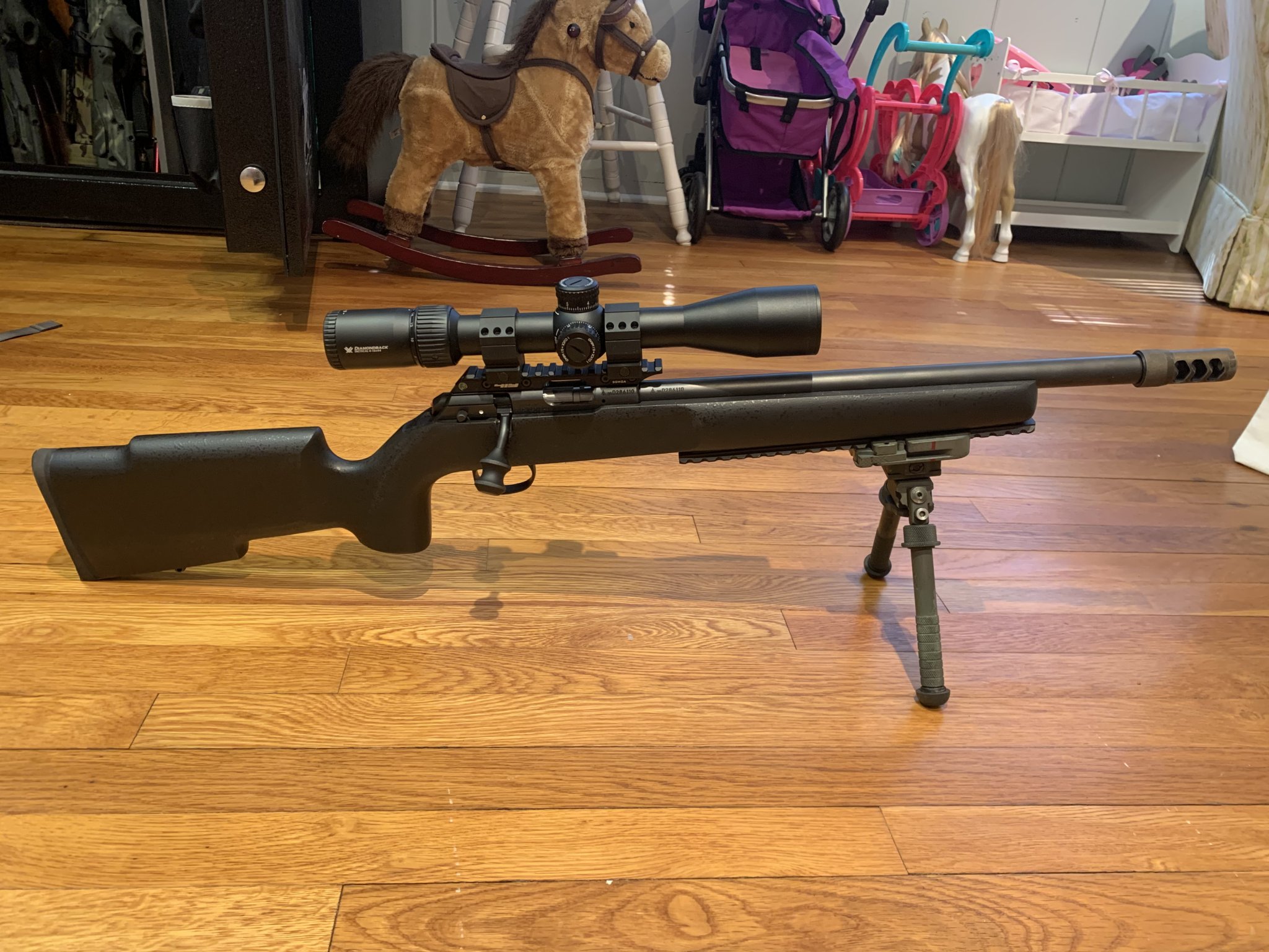

I've done a lot to my cz 457 but I agree the yodave trigger spring probably the best. Really helped for nrl/prs style shooting. It may have been extra practice and experience but my scores increased over 10% on average after installing the lighter spring...
I did not hat others have said to smooth mine out. I polished the bolt and the underside of it. I polished the rails, the ramps, and the other edges where I think the bolt handle go. I told the bolt apart and polished inside of it too.
I got the Area 419 bolt knob and that helped. I got their 30moa base too.
I put a Seekins arca rail on the bottom.
I got a diamondback tactical on it in SWFA Medium rings. I have victor company cheek risers on the way.
Lastly, because I had an extra, I put a Hellfire break on it. I mean why not.
I need flush cups too.
I haven’t touched the trigger but I think that is coming soon.
