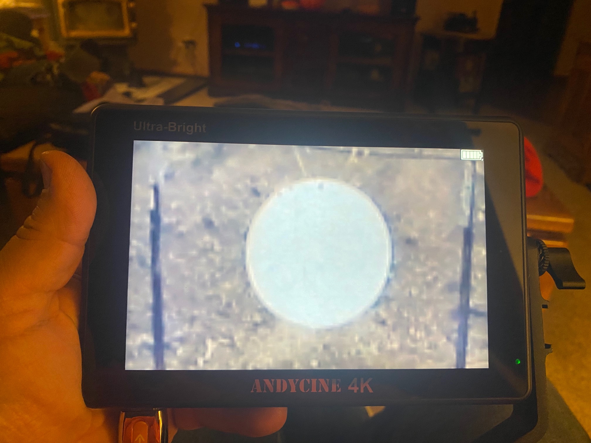

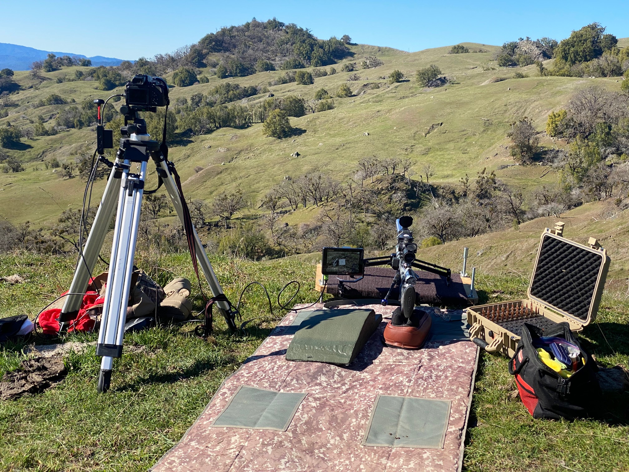

    The P1000 is what I use and yes there is a bit of setup but the view is amazing and I use a Andycine Monitor for viewing my own splashes. And using that I have it on my little table that I shoot from. Also I am able to use the pinch to zoom on the monitor to get as close as I like. The zoom is amazing. I also am able to share the video feed with others using a Z-Cam Ipman video streaming device. I can share it to 4 other shooters as well as watch it on my monitor. Yeah I'm kind of a geek and just love gadgets... We shoot ULR and start at 2054 yards and we all like to get hits, even though we are still competing We all help each other get on target. The close up is at 2054 yards but zoomed to an extreme with the pinch to zoom on the monitor.
    This was the view at 1 mile and was zoomed to 3000mm on the camera and only a slight pinch to zoom on the monitor.
    You can see the little video transmitter clamped to the side of the tripod.

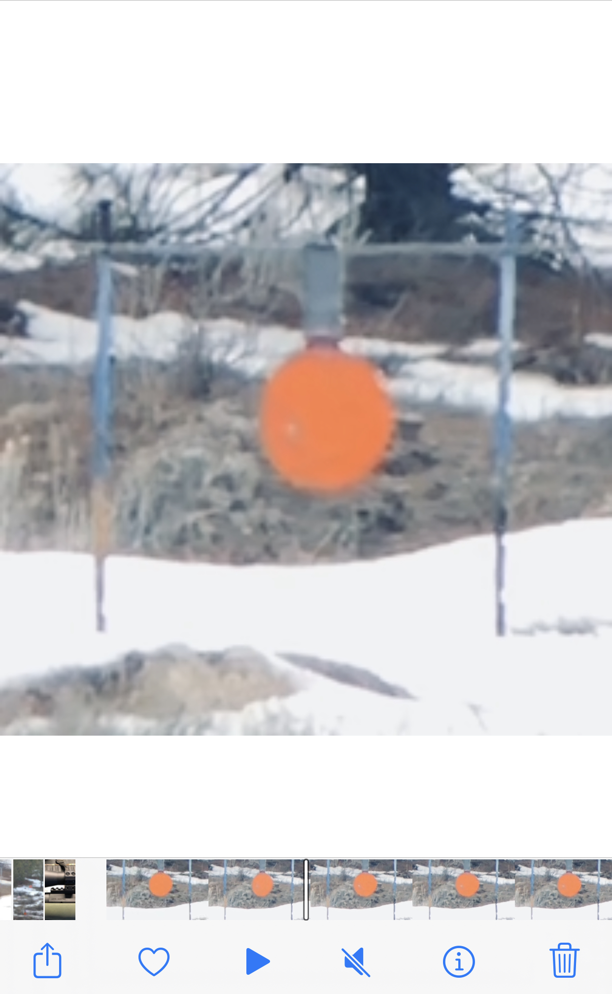

    Screen shot of a video I was recording a few weeks ago. This is at 800 yds. There was a decent mirage when you watch the video, which is why the snapshot below is a little blurry. I guess there a million ways to do it, but for $170, the novagrade is a nice bit of kit.
