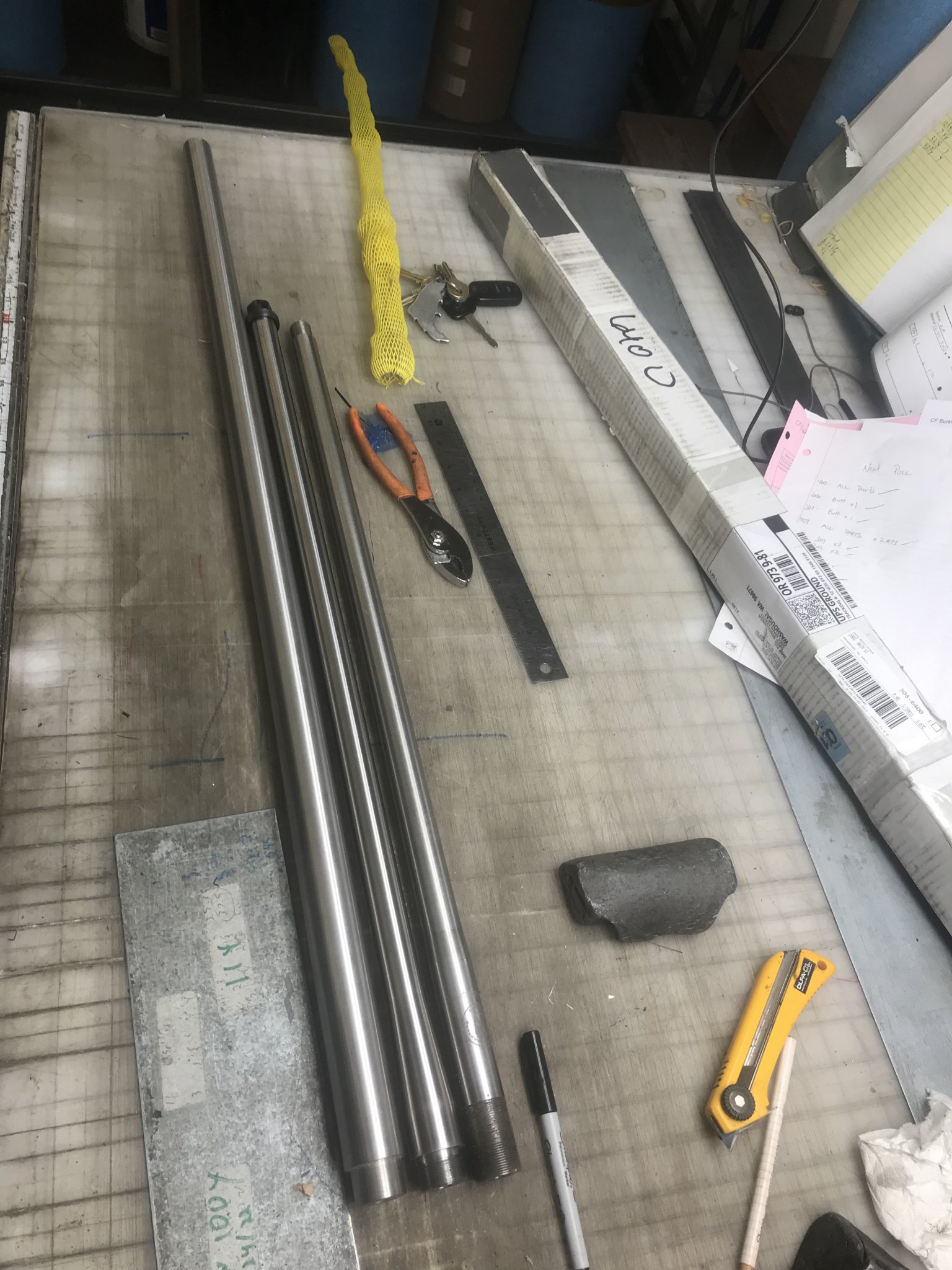

Thank you for all of the information. I just measured the barrel on the rem in front of the barrel nut and it is 1.065. The barrel on the Zeus in front of the action is 1.233. Am I correct in assuming the barrel on the rem does not have enough material for a shoulder?
Reactions: Dragoon300
Your going to have to use a barrel nut with that remage barrel
Here you can see a shouldered barrel and barrel nut barrel side by side.
The nut is basically an adjustable shoulder.
Correct...the rem barrel cannot be a shouldered barrel on the Zeus...as we stated above...it will need to be a nut barrel just like on your Rem but machining will be needed to work with the zeus. The nut is the shoulder...
