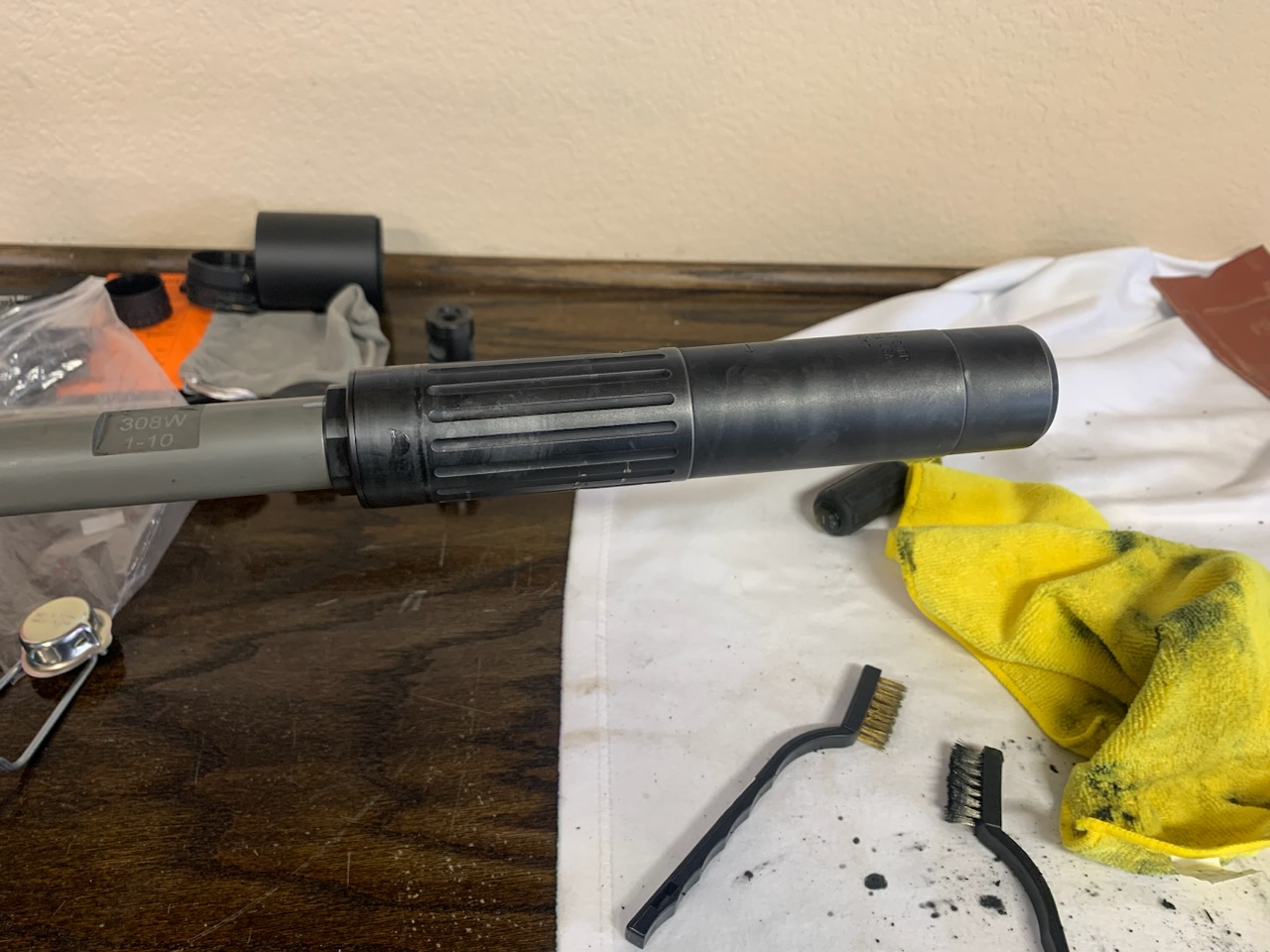

I’d just save up and go this route. Absolutely nothing wrong with ECCO, but getting a magnum can rating with a smaller lighter can is the way to go for turning that paperweight into something you want to grab.
Reactions: Joshua1:9b
I believe this is it.
