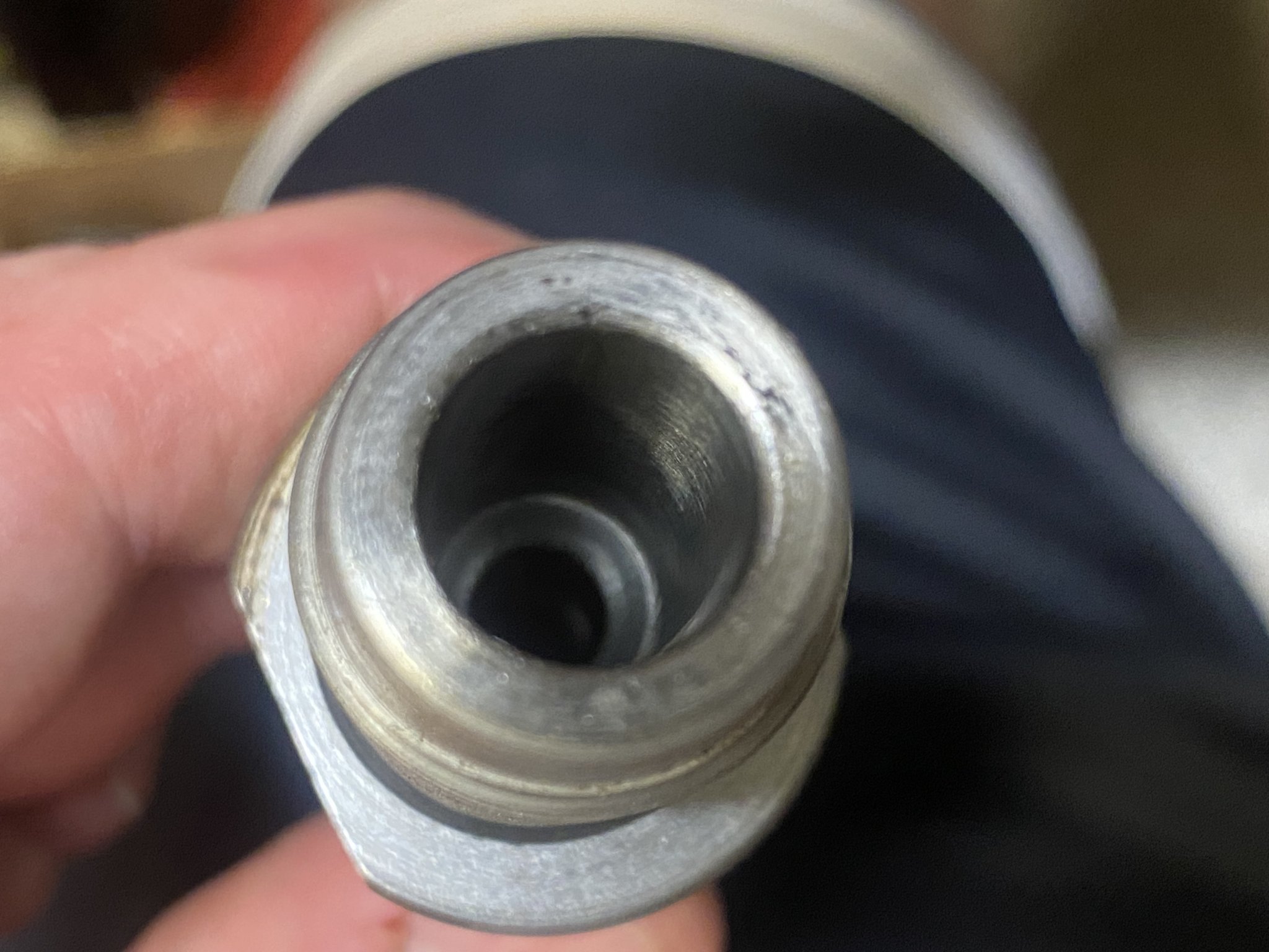

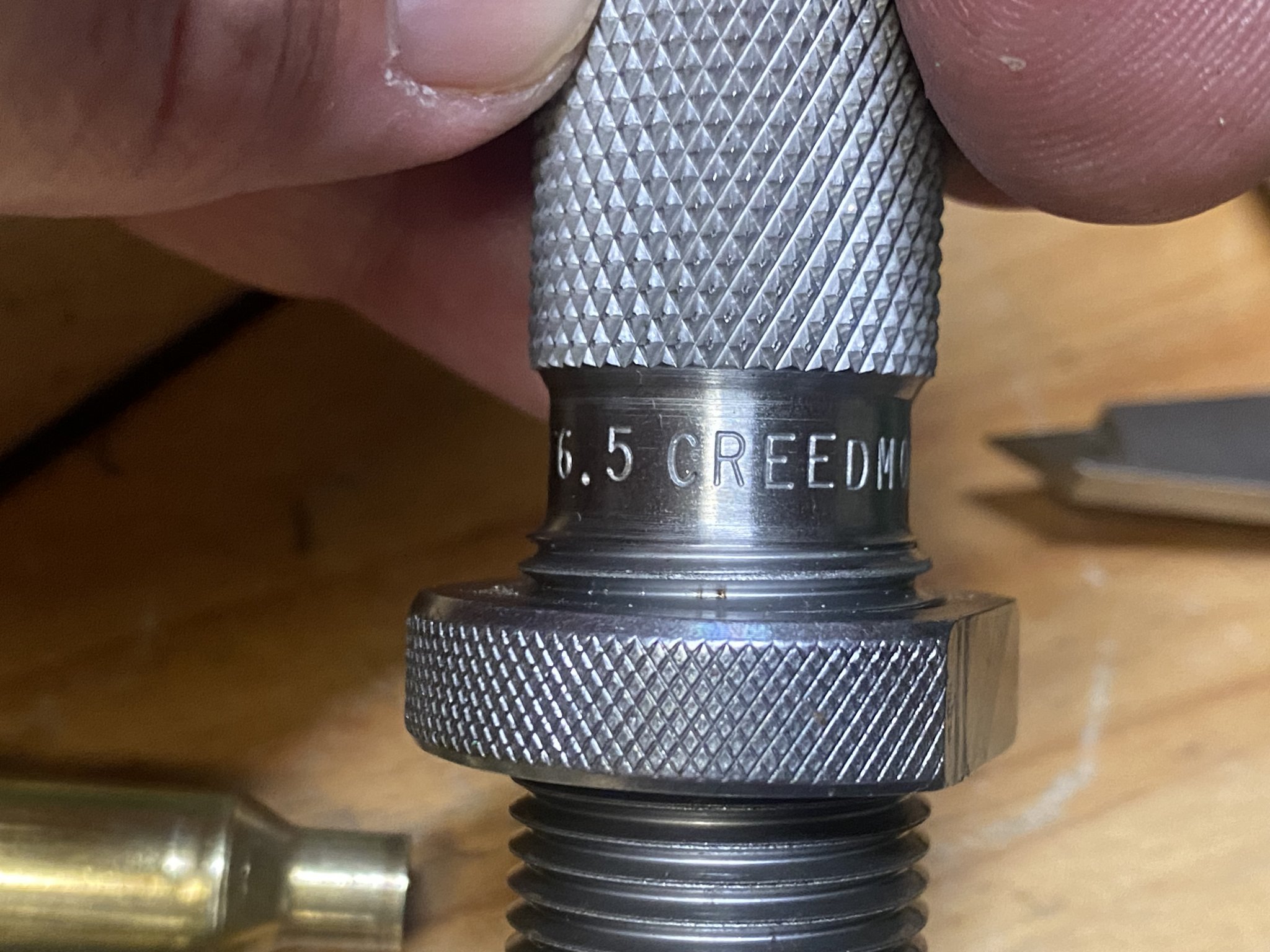

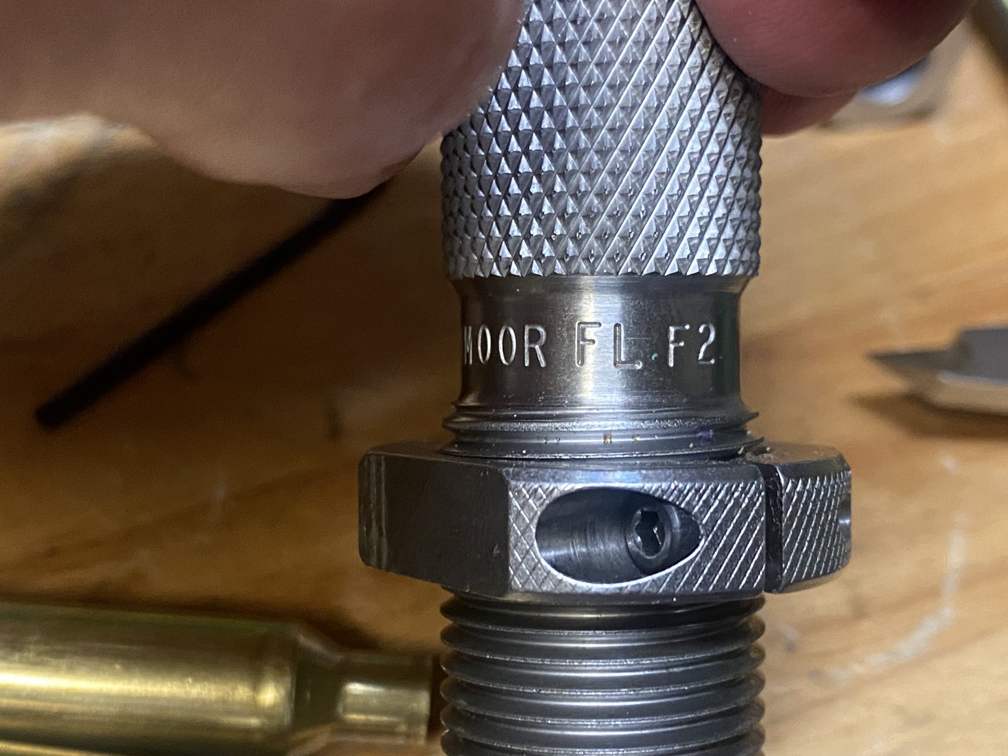

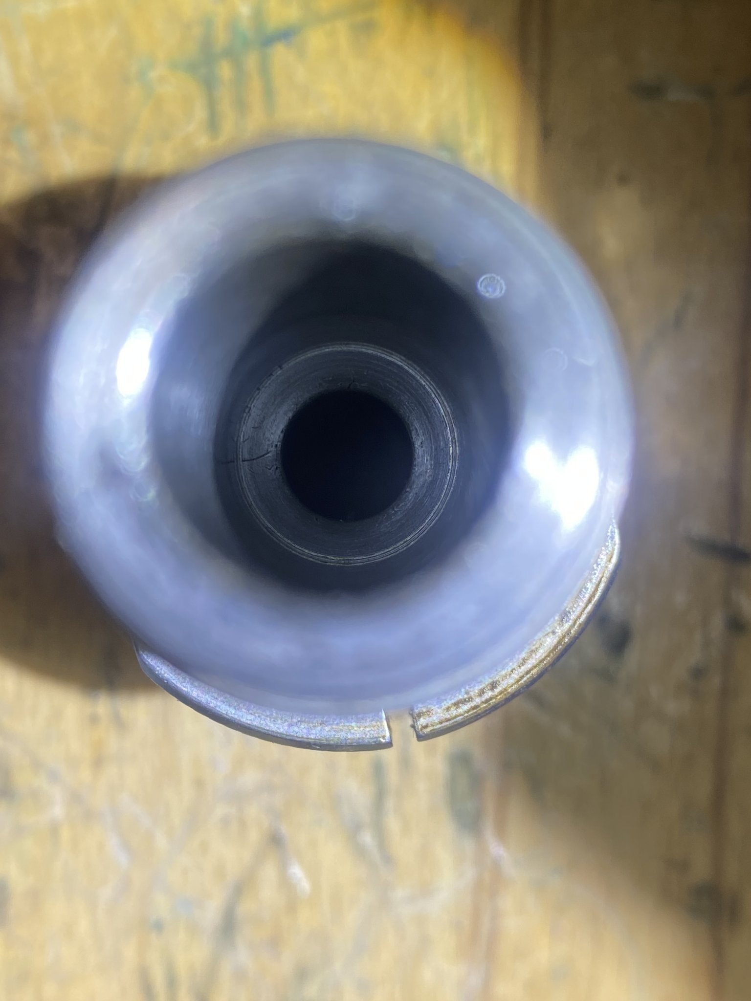

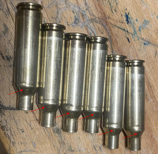

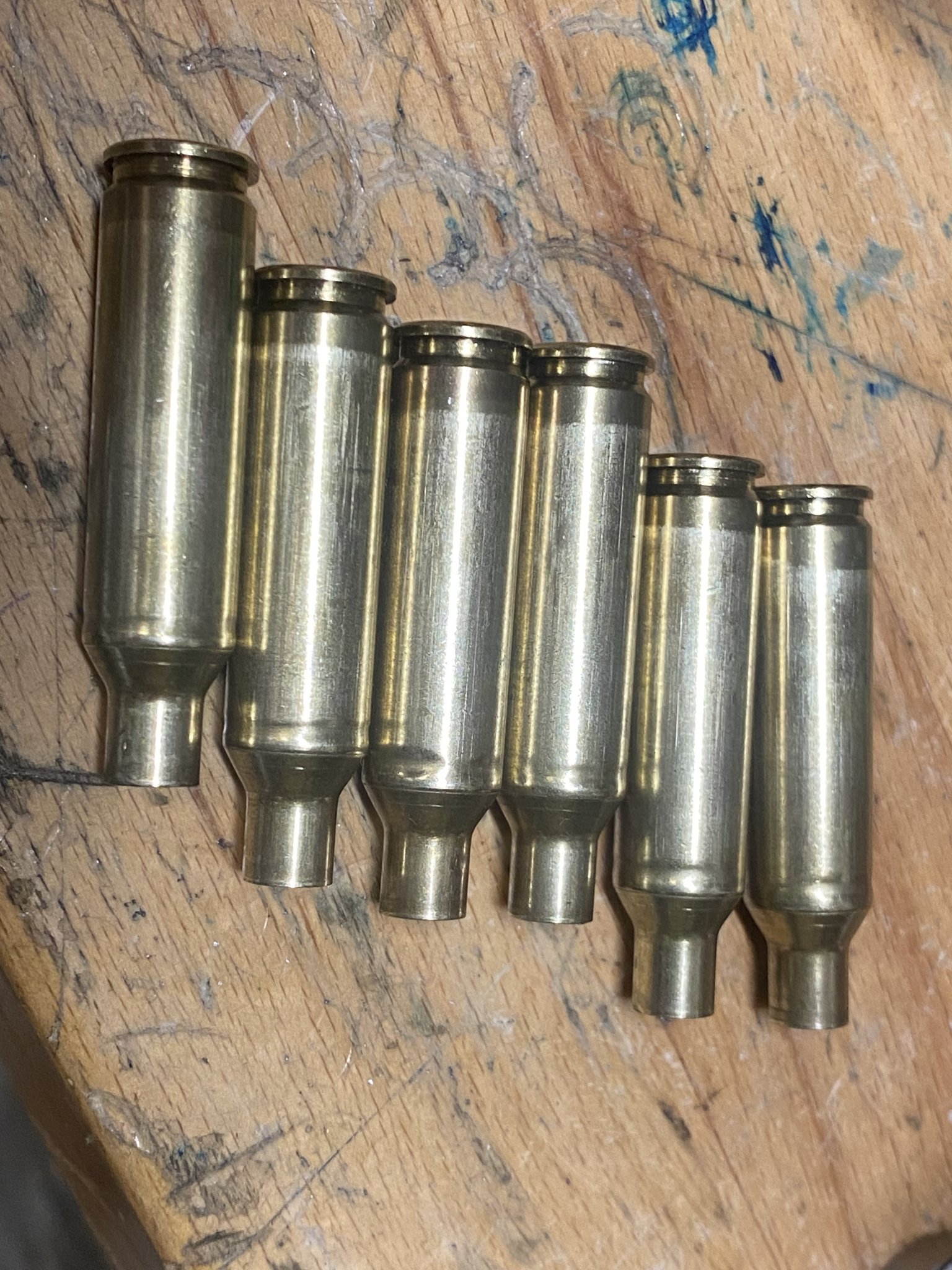

I tried to setup my new 6.5CM Master Hunter resizing die last night to bump the shoulders back about .004” and was destroying cases. I was using my normal lanolin lube I always do, but the dies had a LOT or resizing force and the body near the shoulders were getting warped.
Any ideas what’s going on here? I’ve got several sets of Redding dies and they all have been perfect and easy to set up (223 & 308). I think I ruined 8-10 pieces of brass last night!!! This brass was fired in a new Proof 6.5CM AR barrel with no issues. I had the decapping stem removed from the die because I was going to next expand in a separate step. I’ve had to really crank on .mil machine gun 7.62 brass before, but never had cases deform like this.
Here are some pictures:
You need to break the die in.
Yeah, my last Redding die (ten years ago) needed a little spin with steel wool on a bore brush with case lube.
Although, looking at the picture inside the die, it looks like a weird "ring" at the shoulde/body junction? Like the reamer had a chipped edge. Even some of the sized brass has a weird shape at the junction.
I would consider contacting Redding and sending the die with a few pieces of that brass. There might be an issue.
I'm sending this resizing die back to Redding. It's cleary defective and basically junk. I'm so irritated with the whole thing....:mad:

Redding wound up send me one of their competition shell holders and told me to use imperial wax. They didn’t say it, but I think they polished the inside of the die.
It works fine now, but seems to take a lot more force than I’m used to compared to 308 resizing.
Reactions: RandyM72
Sizing effort depends on how much brass you are trying to move all at once. A 308 case from a tight chamber is going to be easier to size than a 6.5 case from a loose chamber.
I purchased another Redding shell holder - although the old one says its compatible - RCBS. I placed an old case (FL resized) inside the die body and spun some rubbing compound on a drill to polish. I am able to get most of the used brass to chamber with a small resistance to bolt closure. I guess thats the best I can do. I have had this experience with hot 220 Swift brass a long time ago. Once the brass becomes overly expanded (especially the bases) its pretty hard to get it back to size again. In my case, the used brass was fired in a quite sloppy chamber I suspect and the shoulder just won't go back easily. We never stop learning something new. I thank all for their input.
I’ll chime in… I upgraded my press to a Zero and had to reset all of my dies, including this Redding set. I wound up trying my original shell holder and was able to set everything up just fine. I noticed that I needed to lube (Imperial) the entire case including the body almost to the rim to get consistent results. Resizing effort has reduced greatly since it was new, so between Redding cleaning it up and it getting broken in/burnished… it’s GTG now. This is the only resizing die that I’ve ever had to “break in”, which still leads me to believe that it’s mostly a QC issue with Redding.
