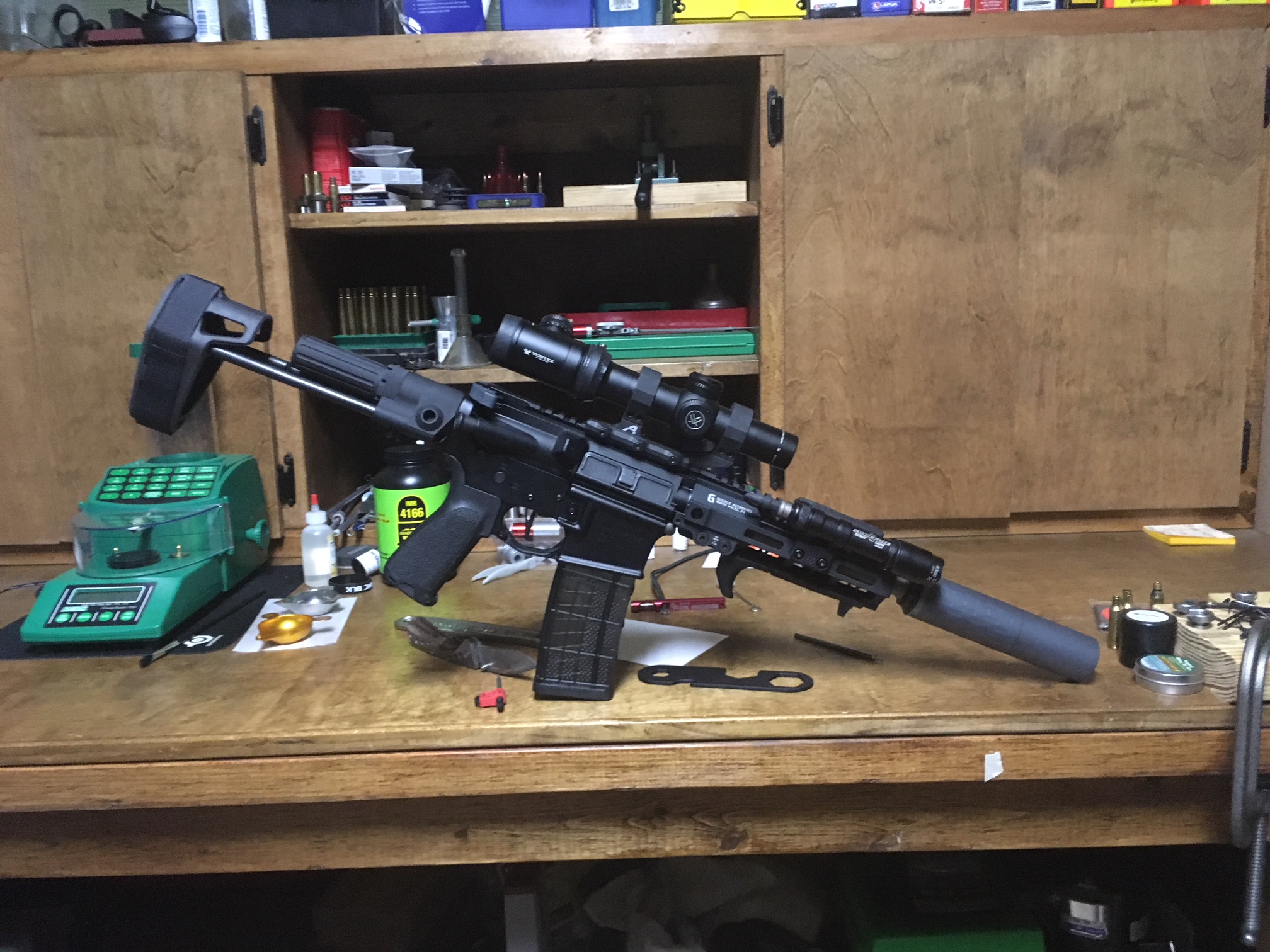

    Here's the build list as of right now.
    CMMG LPK without FCG/Grip
    Greyghost precision lower
    Aero upper
    Aero NIB BCG
    Raptor LT charging handle
    Ballistic advantage 8.3" premium series
    Geissele MK8 7"
    Maxim Defense PDW Brace
    JP heavy SCS for the maxim

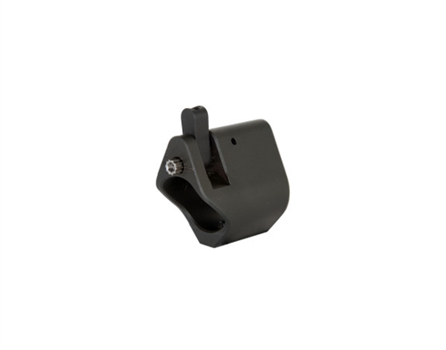

    I prefer adjustable gas blocks to control blowback, but my blk build was before the Bootleg or Gemtech carriers that could be tuned at the ejection port.
    If you can wait, I'd look at the new gas block Seekins had at shotshow, its has a two position throw lever that allows you to tune the gas at each position i.e. suppressed and super with a flip of a switch. I'm planning on tuning some rifles when these are released.
    There's no rush really everything is ordered but the BA barrel came with a gas block, so i can always just change it out. Wonder if it will fit under the Geissele?
    Most Geissele handguard have a decent amount of space to play with however, I don't want to steer anyone wrong. I'm pretty sure the GB will fit, the lever might run into the handguard. Depending on how it operates you might be able to get away with shaving some of the lever off for clearance.
    I might pm Glen to see what thinks. I'm going to run it as is for a little while and see how bad the blowback is first hand i guess.

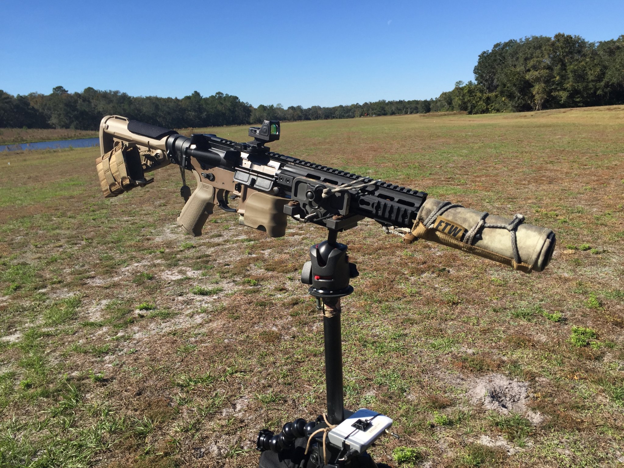

    I almost always am shooting with safety glasses so they really help mitigate some of the blowback; I use PRI "gas buster" charging handles; this is one of my .300 BO SBR builds that fits nicely in a small Blue Force Gear Jedburgh pack. Since the armadillo's never hear the muzzle report, just for fairness I warn them with a Allahu Akbar just before breaking the shot; you can see one of their now vacant domiciles at the base of the tripod.
    Upper
    PWS Mark 109, 9.75” 1:8 twist
    LaRue LT872 QD RMR mount
    Trijicon RMR 3.25 MOA
    Surefire X300 Ultra
    Aimpoint T-1 , LaRue LT660HK QD
    Surefire 762 SOCOM2 suppressor
    Surefire WarComp QD muzzle device
    Lower
    GPI Legacy Arkansas Ranger M4A1
    Magpul MAID grip
    Leitner Wise Buffer retainer
    Magpul aluminum trigger guard
    Geissele SSA trigger
    Battle Arms short throw ambidextrous safety
    Wilson Combat match grade small parts
    Wilson Combat buffer tube
    Trident Tactical buffer spring
    Law Tactical Gen3-M folding stock adapter
    Rogers Super-Stok & cheek pad
    Rogers single point harness adapter / sling QD
    Phase 5 bolt assist lever
    Rogers Mag-Grip
    Tactical Innovations Teflon tension screw
    Precision Reflex Gas Buster charging handle
    Fabricated stock-ELS-spare magazine carrier system
    Rogers Magazine Grip
