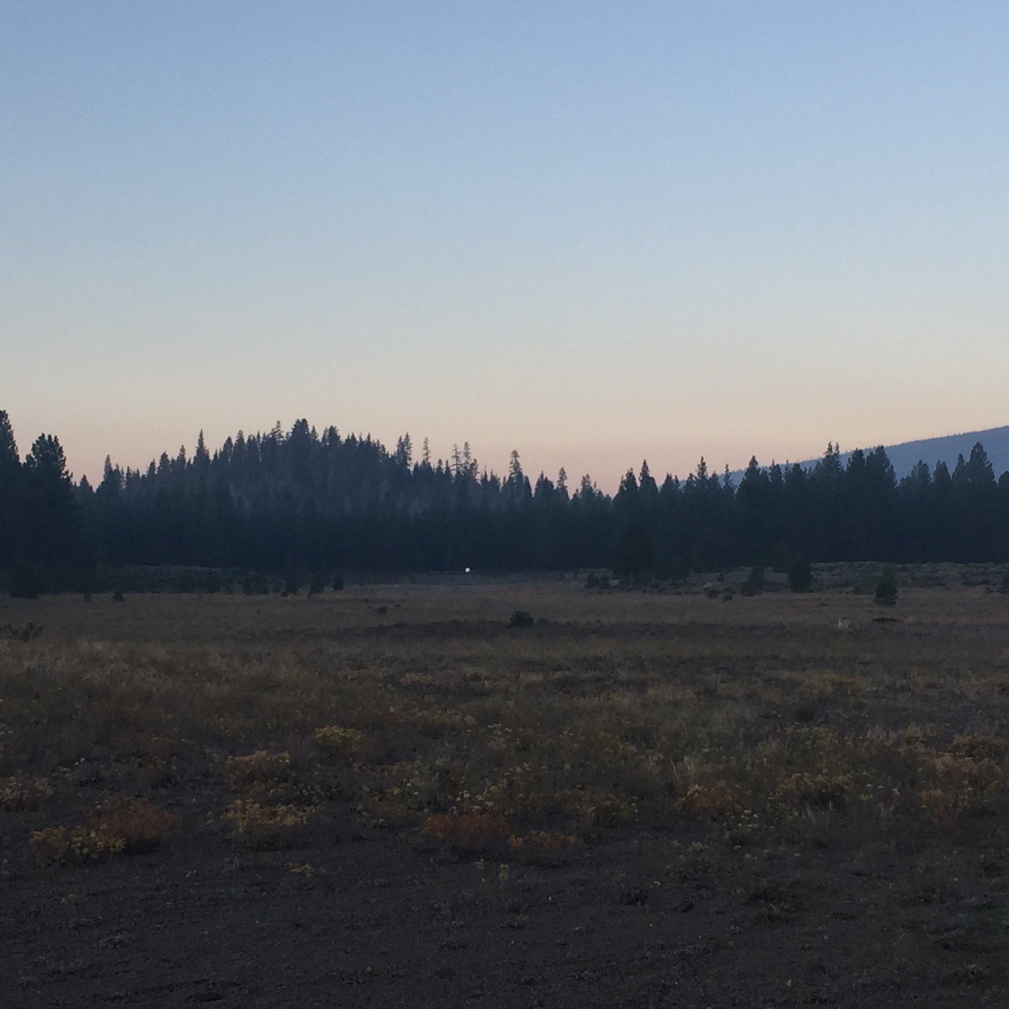

If you look close, you'll see it. Thats about 1020yds IIRC. Really stands out, makes it easy...
Reactions: Changed

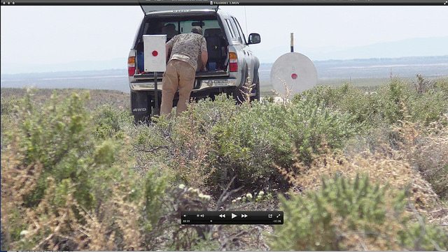

Parking your vehicle at the FFP using your vehicle tail lights facing the targets yielded almost as much distance as the road signs.

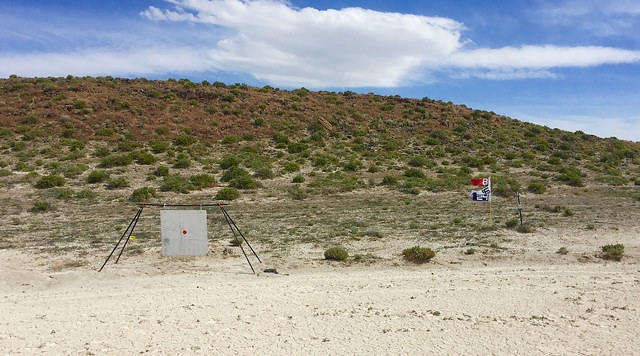

If those two aren’t an option 3” 3M 3430 reflective tape covering everything on a 48”sq plywood, was 2nd to large road signs. It takes I think about $300 in tape. I have a 3M connection that allowed me to work around the cost.
In third place was using a thin sheet metal plate 4x4 painted with 3M reflective paint.
Again, if at moderate distance were the wider beam range finders can return distances from things other than your targets, ranging back to the FFP with your truck next to the target, seem to provide the most certainly of exact distance. Once the range finder drops out, you can get a good return from the plate plate go either way. At the end of the day the vehicle thing worked the best in my makeshift testing.
PS: Note that the front of most vehicles are way more stealthy than the rear. I think it is the not only the shape and lack of large reflective tail lights, but the radiators that brake up the beam; as I have seen the same even with a 25C on a tripod aimed carefully at the radiator area of a truck.. pull off it and a return is read..
In reality, what we do is get to a FFP figure out the best line-of-sight, then one guy stays back and the other sets targets. We range the truck as we drive out the targets. Radio communication is needed as the guy on the range finder is prone on a tirpod to confirm the line of site is going to work.

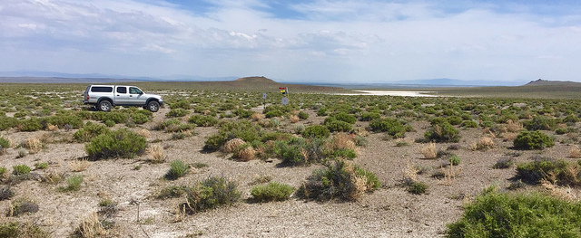

The image above at 2100y from the FFP, is in the white sink area in the middle picture. You might notice the wind is well over 25mph. Thats why the camera reflector trick is a no go.
We are luck to move the FFP and targets wherever we want. Sometimes well have paper at close ranges 100, 300 then lots of steel all the way out.. This is were we tested the Kilo and a few others, in bright daylight.
