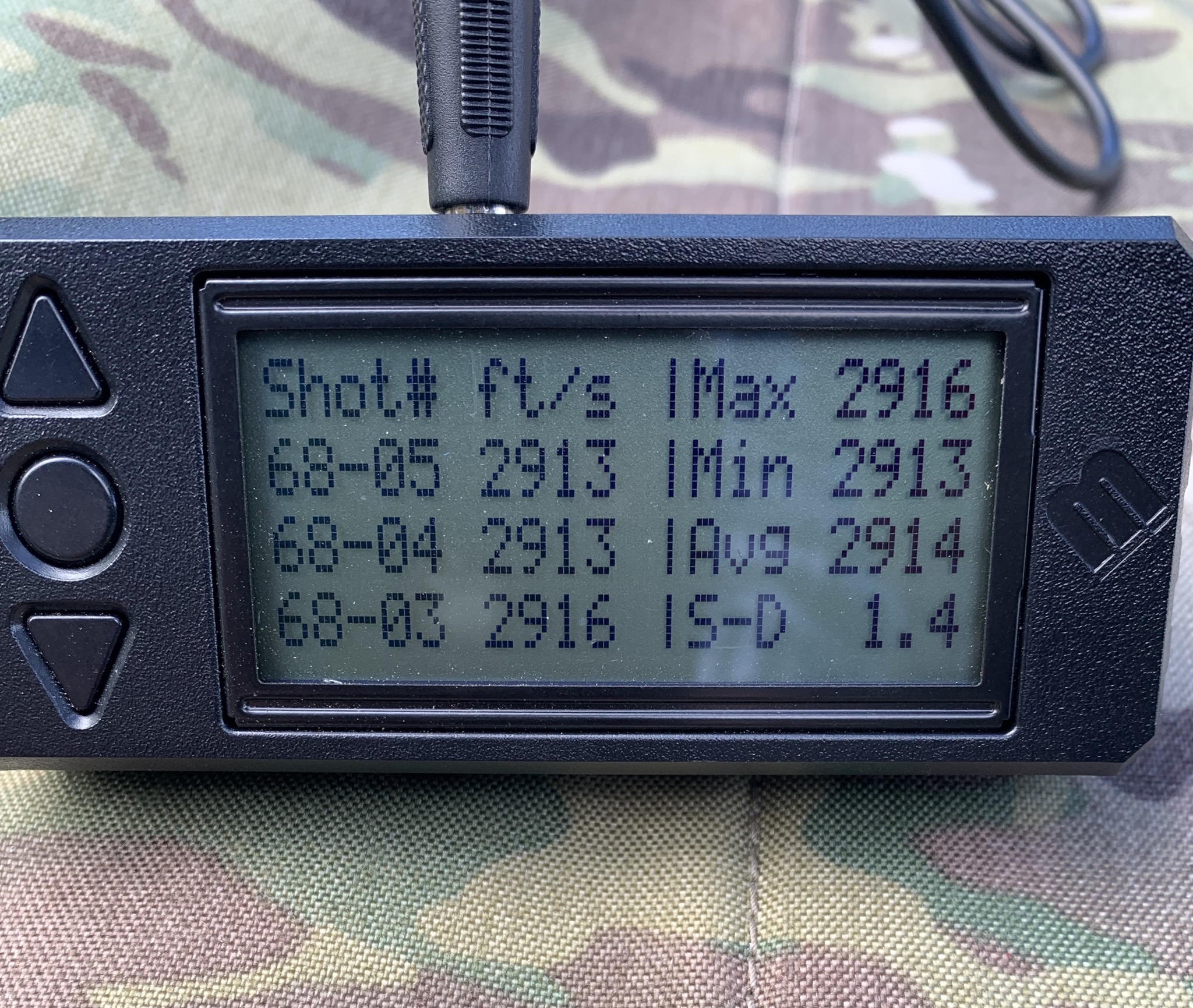

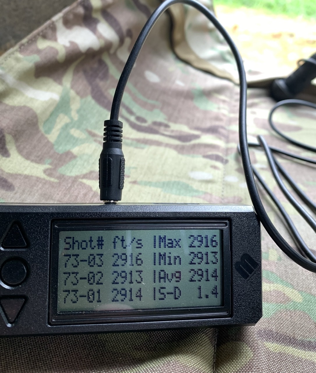

Tested some RL 16 with 135 A tips on Thursday in PA.
44.0 gr seated 2.880 = .057 jump in my barrel. 24” Rock Creek 8T
Shot that load again today in MD to confirm. It was about 10 degrees cooler & I loaded 44.2 @ same jump 2.880
I’m going with this load for the Major land match. Swapped mounts and re-zeroed today. Now have 25 mils on the dial, almost enough.
