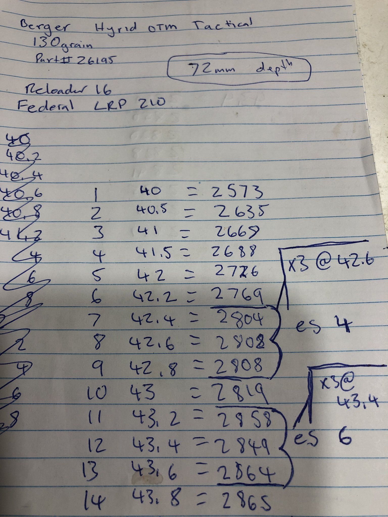

I’m trying reloader 16 in my 6.5 creedmoor with 130 Berger hybrid otm projectiles. Hornady brass. My loads during load development are fine but once I start having strings of fire the speeds jump up in speed every shot , sometimes by 10fps per shot. I have a RCBS charge master that’s been accurate on all my other rifles so that’s not the problem.
I have used reloader 16 before and had the same issues, after about 8 shots it jumps up o pressure then disappeared again once I let rifle cool of for a minute.
I find it strange as I’m not leaving the cartridge in the chamber long at all and it’s pretty cold outside so I’m lost as to my the speed always starts climbing.???
Guess my rifle just doesn’t like it!!
my load is just 43.4 grains of reloader 16 doing 2840fps

Yeah I agree that’s a hot load. I’m at 42.6 with a 142smk going 2850. What rifle and barrel length? Seems really slow for a 130 bullet and that much powder.
I haven't used hornady cases - but I've never been able to get more than about 42,5gn of 16 under a 130 before pressuring out. I don't own one, but the talk on tikka barrels is they tend to run slow.
When you say speed increases per shot - you mean each successive shot after #8 is +-10 fps faster than the one before? And it's right back to normal after a little cooling? I'd almost lean towards a heat management issue - or a load stability issue. You may want to run it a bit slower and see if you get the same stability issue.
The Berger 130 hybrid is my favorite 6.5 projectile out of my 24" factory barreled Ruger RPR. My load is 42.6g of RL-16 in Starline brass at 2.800". It runs 2850fps with single digit SDs. Brass life is exceptional. I tried finding a node up above 2900fps, but started getting pressure signs about 2930fps and the groups were getting worse the farther I got past 2870fps. The 42.6gr load in my barrel has a pretty wide accuracy node from 2830-2870fps. With your issues, I would suspect that factory Tikka barrel is the culprit. They tend to run on the slow side compared to other manufacturers barrels.
Yeah so after only about 3 shots , each shot after that will speed up . The first shot is normally super slow on cold barrel. My last 8 shot string went 2788 - 2820. - 2835. - 2848 - 2850. - 2858 - 2862. - 2860. Then I stop because it starts worrying me. Super strange.
I will drop back a grain and see what happens , but it’s got to be a temp stability issue but only after less then 10 rounds?? My barrel and suppressor are only lukewarm at best!!
It truely has me stumped , like I said not the first time I’ve had this happen with this powder.

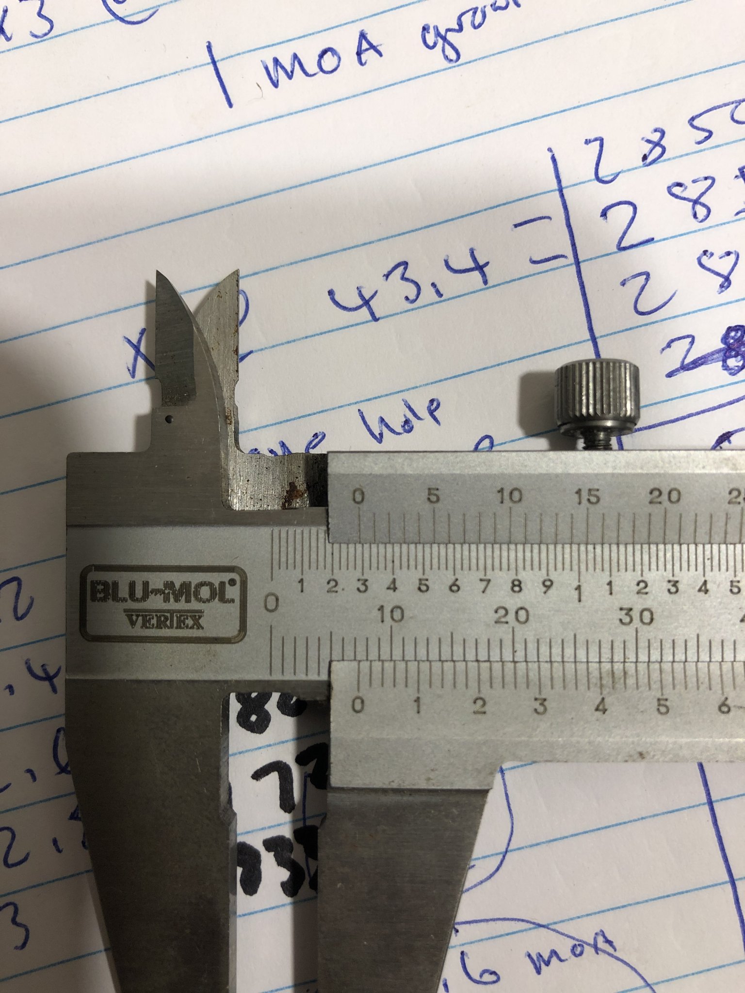

They are in a magazine, never heard of this before, would that have something to do with neck tension?? Being hornady once fired brass they do feel real soft to seat the projectiles
It would be related to neck tension. If your neck tension is super light you might have some issues. But I only run 1.5 thousands of neck tension and have no issues in a 6.5C. Measure your neck diameter before and after seating the bullet and see what you have.
Reactions: KingCountry LRS
Good thought - make sure you mark where you measured since necks cam vary in thickness. The optimal way to do this is with pin gauges.
If you want to check if its setting your projectiles back - measure the COAL of the first round you put in the magazine, then load the rest. Shoot everything but the last round and re-measure it. I've never experienced any setback, even with a semi-auto, using 2k of neck tension (pin gauge method).

Yeah I’d say I have just touch under 1/2 mm
That might be a little on the light side. As suggested above measure your first bullet in the mag fire several on top of it and remeasure to see if you have any movement. Another test would be to single feed them and see if you get the same velocity jump you saw before.
It's hard to read those calipers on a computer screen, but I come up with .33mm or .0013" neck tension. That's a little on the light side, How are you sizing your brass? I still don't think that's the issue - but could be something to play with in the future.

So I just got back from doing a heap more testing
I tested the bullets being affected by recoil scenario and that wasn’t the problem, the COAL stayed the same!
I then Dropped my load back to 42.6 grains of 16. The shots went as listed (semi warm barrel not cold). 2794-2810-2814-2808. So it seemed to settle down a bit with lighter load, .6moa group. The ES is average but I don’t have a lot of these projectiles left and being in New Zealand we’re the last people to get things from US trickle down to us so I’m having to change my components a lot to what ever I can find. So I’m not going to be to fussy. Plus our competitions here only go out to 800m most of the time

Few things to comment.
1. Neck diameter of a fired case compared to a sized case isn't going to tell you your neck tension. I think the guys missed that the comparison is fired vs sized, not sized brass vs bullet seated in the neck
2. Those conversations are not correct. 0.33mm would be 0.013", not 0.0013. This is sort of irrelevant as y'all were checking for neck tension and the measurement of unfired vs sized was being compared.
3. Not sure why y'all are converting when that vernier has inches on it already 🤔 the top scale is graduate in .001" and the bottom .02mm.a vernier on a screen is hard to be extremely precise with.
Unsized I read .300 or .301"
Sized I read maybe .291" sort of blurry.
