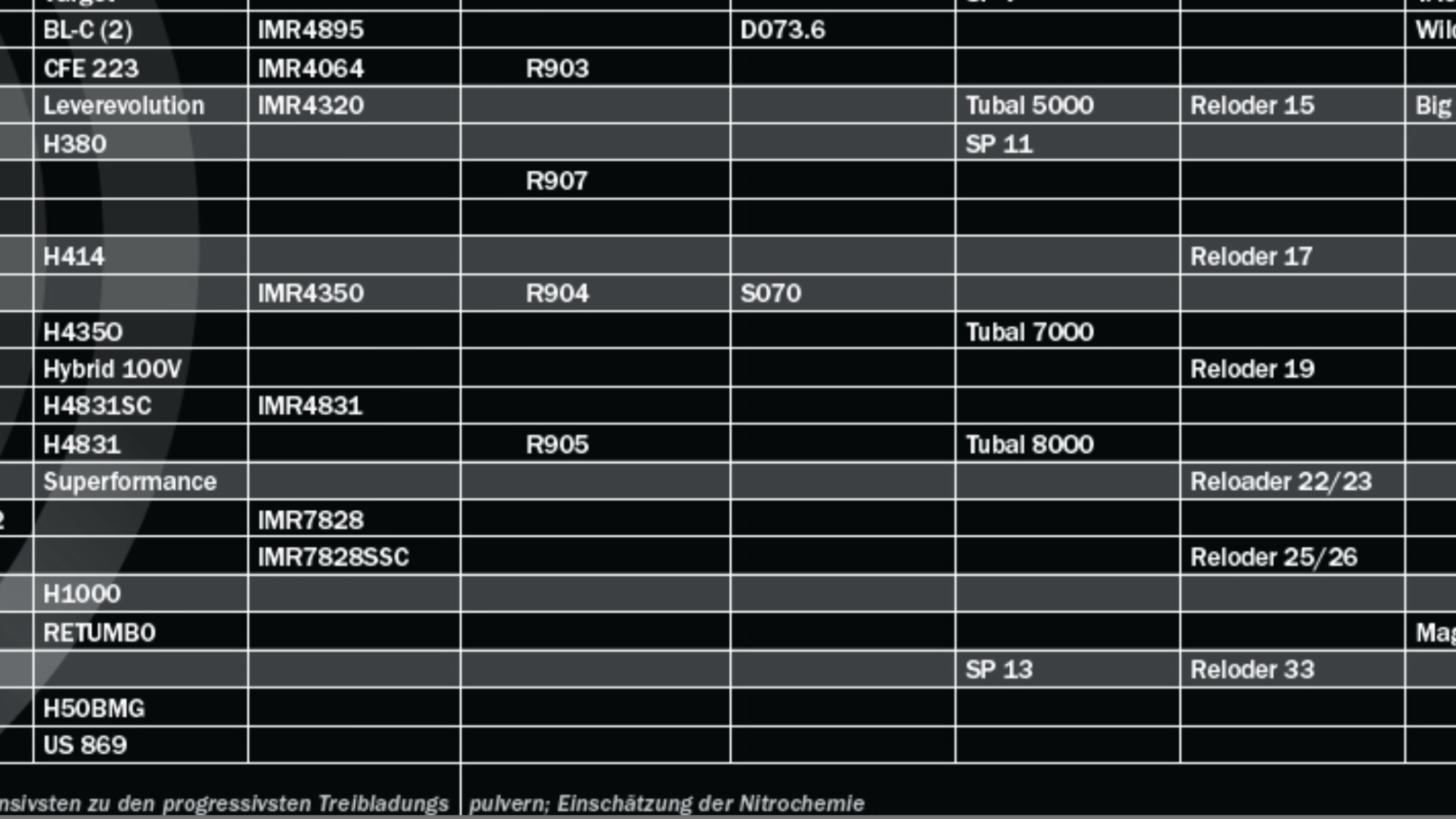

I have been searching for quite sometime now but have not been able to find a burn rate chart with both RL26 and Retumbo on the same chart. If I piece together different charts and numbers they seem to have almost the same burn rates but with Retumbo being ever so slightly slower. I have had great results with RL26 but like most others it seems very hard to get. I have a very good amount of Retumbo so I would like to explore that as a possible replacement to RL26.
Anyone able to find a burn rate chart with both listed or have any experience with using Retumbo as a replacement for RL26?
Thank you.
Reactions: Mj30wilson900
I found this one at one time, can’t remember where, and saved it to my phone. It shows Retumbo and RL26 as he same speed.
I found this one
Here:
It shows Retumbo slower than RL-26. I’m not sure there is a definite guide. I switched to H1000 when I ran low on RL-26. I’d use what you have available.

Maybe it’s just my lot, but 26 is quite a bit faster than h1000. Retumbo, which I dont shoot very much of, is a tick slower than h1000. I would t use retumbo data for r26 in any case, if that’s what you were thinking.

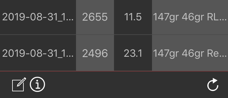

Thank you guys for the confirmation on my thinking. I have loaded up 4 rounds of Retumbo and 4 rounds of RL26 of the same charge and will run them over the Magnetospeed next time I’m out at the range to see how much slower Retumbo is. I’ll report back with the data if anyone is curious.
I doubt we will ever see a new complete burn rate chart again, as variables are explored by shooters that was never done in the past.
Just an FYI, you can never compare a high energy powder like RL 26, VV N 500 series to others even if they are in the same burn rate on a chart.
IME with 26, I would say RL 25 is the closest you will come, yet 26 seems faster, but also seems to be way more universal or forgiving if that term could possibly be used.

You guys were absolutely correct. Even though the burn rates are very close, Retumbo produced 150fps less speed than the same charge for Reloader 26 from a 20” barrel using the 147eld. You were also correct about not sealing. The entire piece of brass was covered in carbon.
