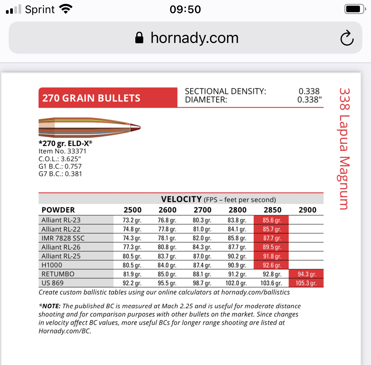

    Anyone having any luck with this combo? I have a rifle showing up in the next few days and have been looking for h1000 or retumbo but have not found any, but I have 8 pounds of reloader 26 and am wondering if it’s worth working up a load with it or not? Thanks
    I don’t have a 338, so I can’t give personal experience but Hornady does list it for use with their 285. Maybe you can develop/ extrapolate from that data.
