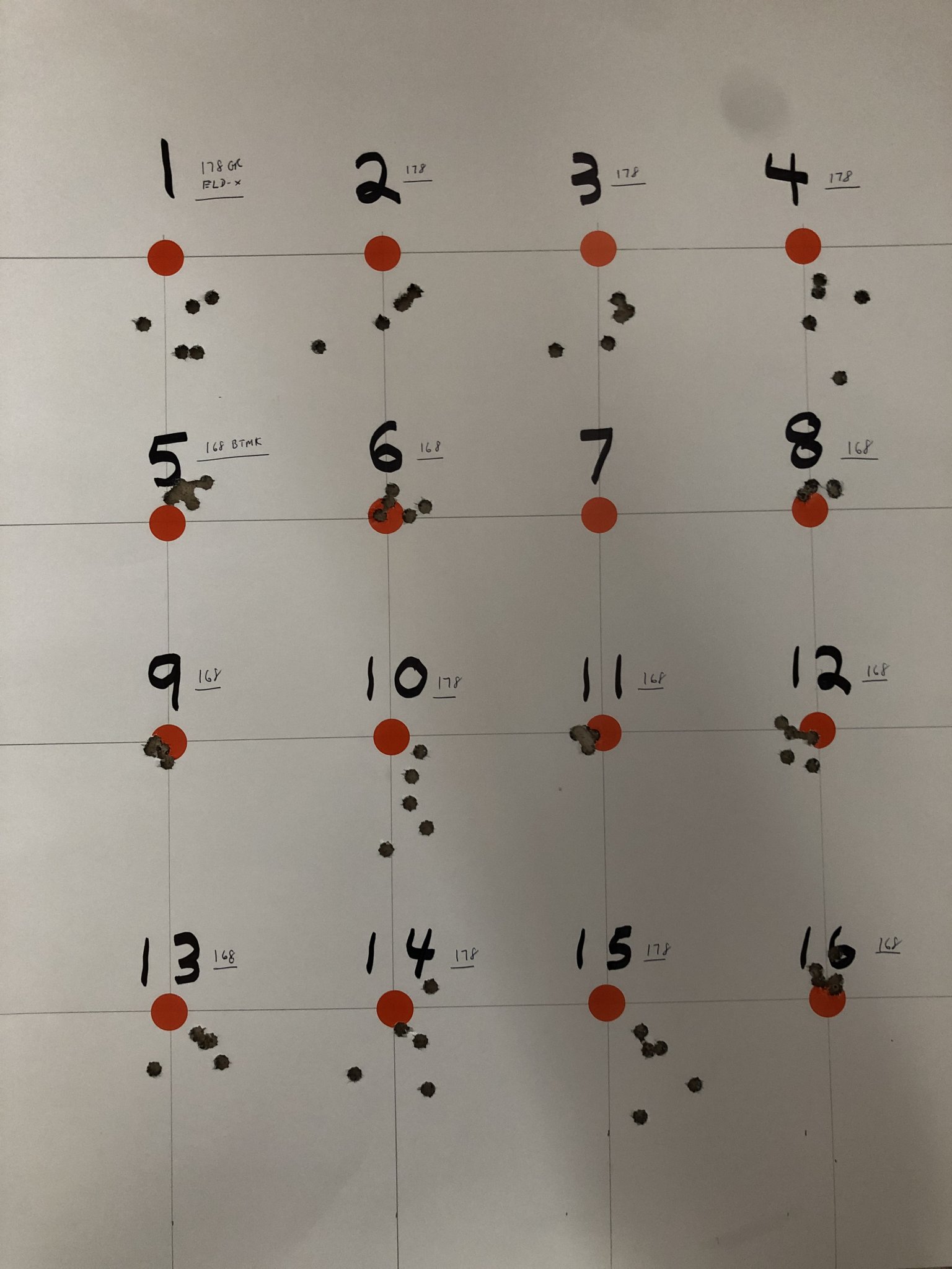

Well, I need to know what powder load you are using because I cannot get the Hornady 178gr ELD-X using IMR-4064 to shoot in my Remington TAC-21 with a 1in10 twist bolt action worth a darn no matter what powder load I use. 1,2,3,4 were the first four groups I shot so I was thinking, damn is this me or the ammo. I know I can shoot better than this. So I knew my rifle shot 168 GR HPBTMK rather well so I shot groups 5,9,11,16 and was happy. I then went back to the 178 GR ELD-X and hell I may as well had a shotgun. These were all at 100 yards not much wind. Do you guy think the twist rate is wrong for the 178 ELD-X or this rifle just doesn't like that bullet. I was going to try this bullet in my Remington 700 - R5 with a 1 in 11.25 twist to see if the 178 GR ELD-X group any better but am not sure I should waste my time. Any constructive thoughts? The orange pasty is .750" in diameter.

I have not tried the 178 ELD-X but shoot the 178 AMAX which I think is similar, could be wrong. My 20" 1/10 factory Rem 700 barrel loves that bullet with 44gr. of Varget. Velocity is 2504 and it's sub MOA out to 800, which is the furthest I've tested it.
Good luck working up your load.
ETA: I also have a Hog Hunter and will try this load in the next week or so to see how it does. It's a good shooter for a budget stick.
