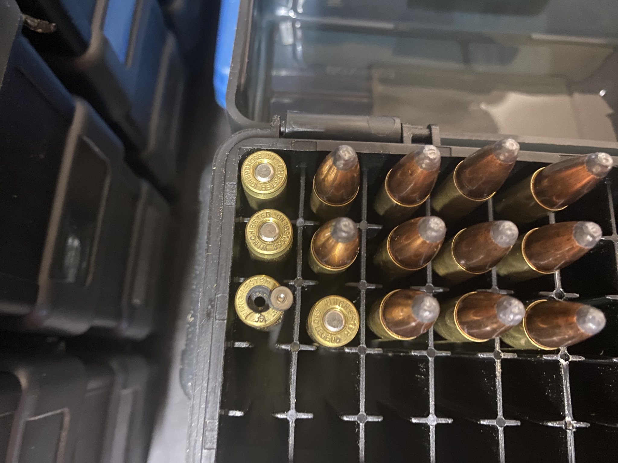

Hello everyone.
New to the site and kinda new to reloading. I’ve been reloading for almost 3 years. I primarily load for 308 and 243, and recently 350L, but mainly 308. 5% for hunting loads, the other 95% for 308 match bullets, which are just for fun. In those 3 years I’ve reloaded 4k+ loads, by far most of them being 168SMK’s. I bought the 350 just to have an off the wall fun cartridge to play with.
I thought I had a good understanding of reloading, but the 350 threw me a curve ball that’s got me concerned.
I shot 170 TSX and 165 FTX on top of H110 first with decent results (maybe 75 rounds). I bought a box of 170gr Hornady SP Interock bullets and a pound of Lil Gun. I started with 27.3gr (Hodgdon states 27 start/27.9 max). The reason for starting above max is, from my understanding when you load long you get extra volume to play with. This has never been an issue before with bottle neck cartridges. In fact, I’ve gone more than a grain above max on a few powders with no pressure signs. This load was STUPID hot. My chrono read 2450fps! Bolt stuck, primer blew out..this is a first for me. Even at min load of 27gr, I’m overly confident that this woulda been way too hot. I pulled the other 14 bullets I had loaded and weighed the charges and all were correct. Now I’m unsure about where to start my charge weight. Here are my specifics.
Win case trimmed to 1.706
CCI SR 400 primer
27.3 Lil Gun
Jammed BTO-1.895
Loaded BTO -1.834
No crimp
Any help or suggestions much appreciated

GRT says that a 350L, 170gr Interlocks @ 27.3gr Lil Gun, is at 63,144psi, exceeding max pressure of 62,366psi. I'd drop the load down to 26gr and work up in .1gr increments to find the happy place for that rifle.

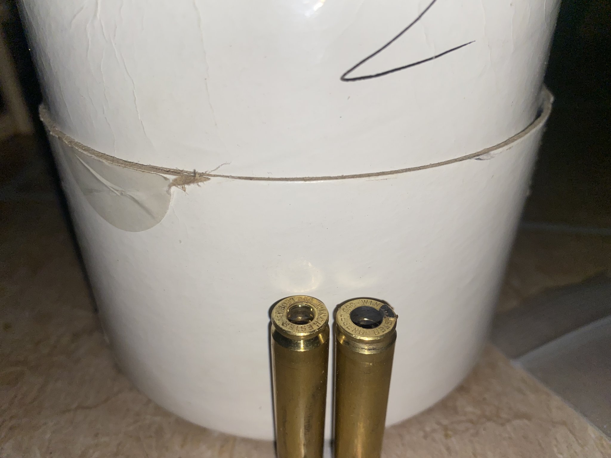

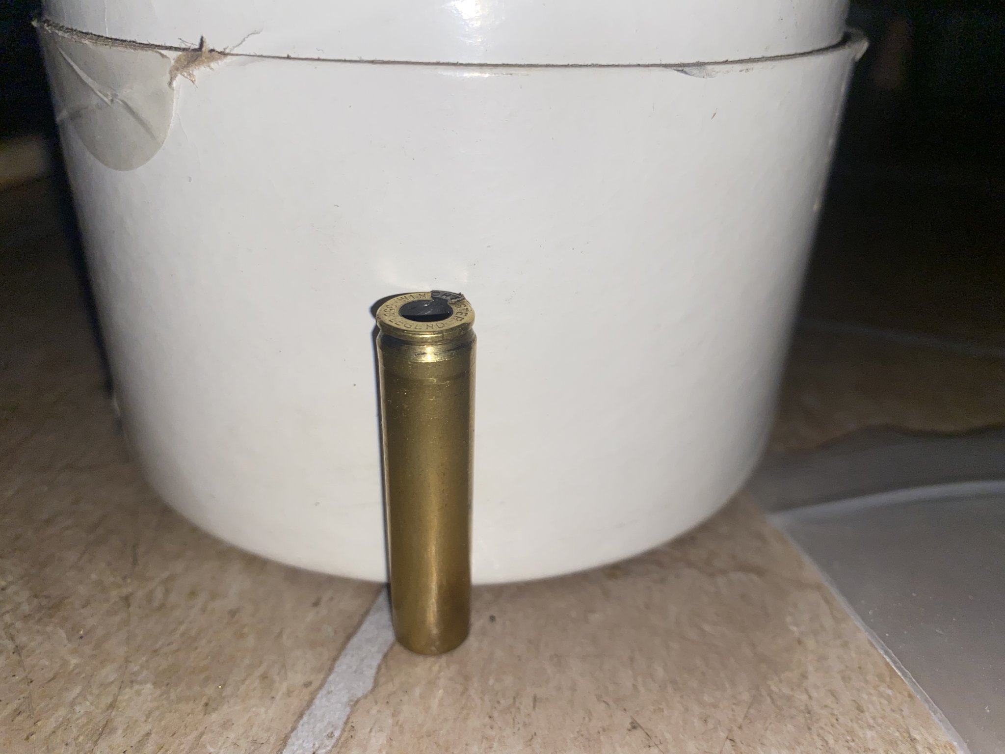

Well guys I done did it again! Finally got some time to mess with the 350L again and blew another primer.
This go around I backed the charge down to 24.8gr (27 is Hodgdon’s minimum) of LG and was gonna work up .3gr for each group. As you can see, I didn’t make it far at all…first shot got me. I pulled the bullet on a few others just to make sure I didn’t measure wrong, and they were all within .1 of what I loaded. I’m baffled..
I’m seating the bullet around .080 longer than Hodgdon’s OAL, but still .060 off of the lands. Maybe that’s it? I’ve gone that much on bottleneck cartridges and never blown a primer.
In my creek bottom, shots over 100yds are rare, so I don’t really need to sweat velocity anyways. Just figured there’s no point in not getting another 100fps if it’s there to get..
I appreciate y’all’s input and if you have any more, I’m all ears. I may tinker with it a bit more, but a different powder is definitely happening on the next go around.. again, thanks for the feedback.

Well your using good brass. The Winchester is thickest at the bottom of all available options. Also consequently the lowest case volume.

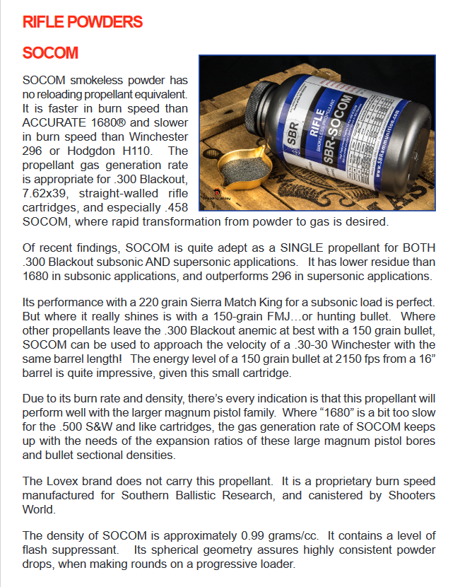

I haven't done a ton of load workup on the 350L yet, but I did a lot of research before I started. As a result I started with Shooters World SBR Socom. It burns clean & with a basically full Winchester case 29.2gr & 165 FTX it duplicated the factor Hornady load. In the Hornady case with 29.5gr it was just 10fps faster, both loads had no pressure signs. 2185-2195fps from an 11" barrel.
I have no idea how temp sensative this powder is, but I suspect it's better than some of the other popular options.
