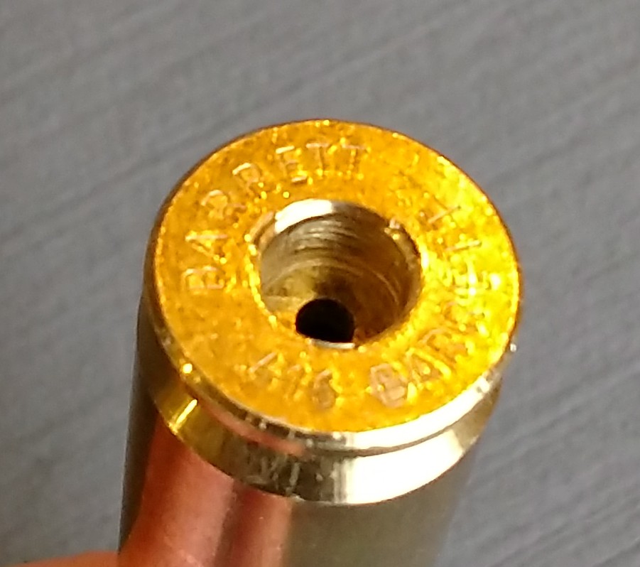

This is the tool I use. Removes the crimps in seconds. I then put a small 45 deg. chamfer on the pocket to aid the new primer in. I'm using CCI #35 primers.
http://kmshooting.com/primer-pocket-correction-tool-50-bmg.html
Here's how they come out. Not the greatest pic.....sorry.
Todd

Todd,
Thank you for the reply! So the KM tool works very good for you? Also, I’d like to know more about your 45 degree chamfer process. I’d like to see specifically how you’re doing that. If you’re good with it, I’ll message you my contact info and hopefully you have a few minutes to connect. Thanks again! - Joe

In my experience the most complete and nicest looking crimp removal is done by the LE Wilson Reamer. Cuts the crimp out completely, leaves a nice rounded taper for easy primer insertion and doesn't scar up the pocket walls. Needs to be used with the BMG case tools, cannot be used freehand successfully. Alternately I have had good luck using a chamfer tool and the CH4D primer pocket swager. The chamfer tool is used to cut a portion of the pocket away before using the swager so that the bulge raised around the pocket is minimal. Otherwise the bulge can mess with your cartridge headspace for the first firing.

I don't load the 50 BMG but I have loaded a lot of calibers with crimped primers. I've used the Dillon Swadge, the RCBS tool, the Wilson tool and they all work on some crimps and not so well on others. I keep going back to a cordless drill and a carbide countersink. I guess you could set this up in a drill press and set the adjustable stop but I just free hand it. It should work ok on the 50 BMG.
