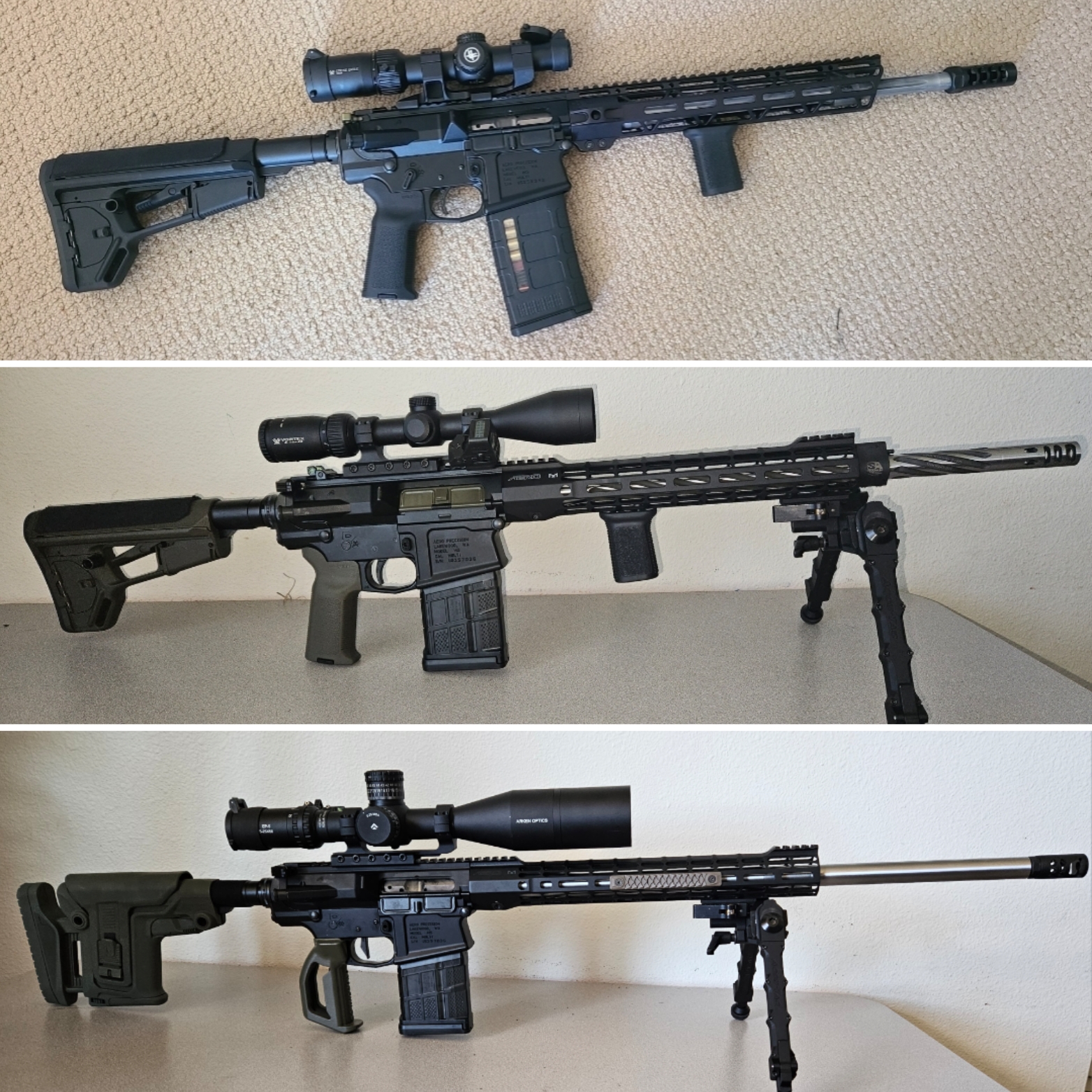

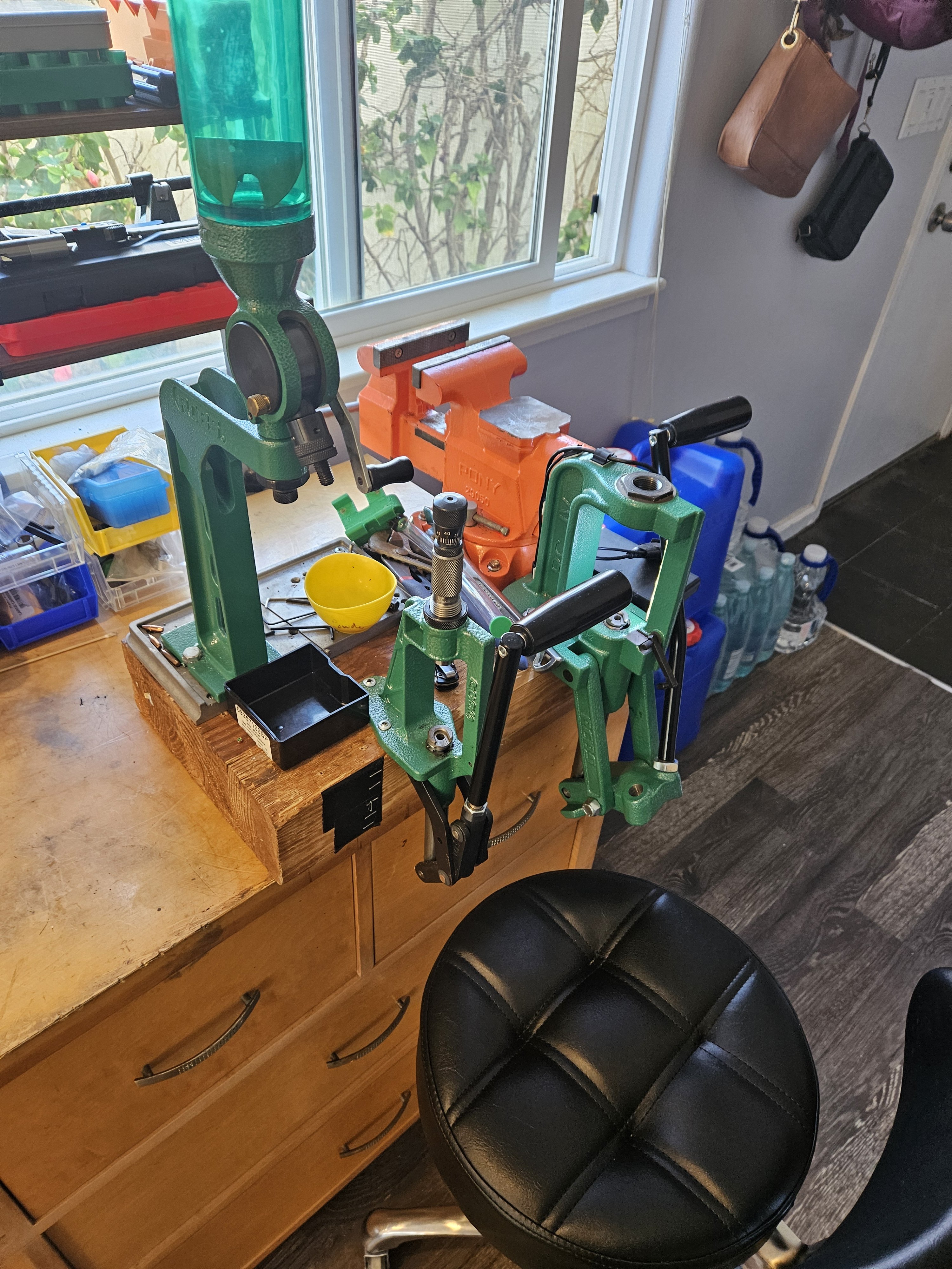

(I've got my (3) AR-10's pictured: 16" Wilson Combat Recon; 18" Bartlein, and 24" Shaw Bull........and, a picture of my "reloading station" on top of my wife's dresser).... the bartlein has a slightly smaller chamber and is more sensitive to hotter loads.....
