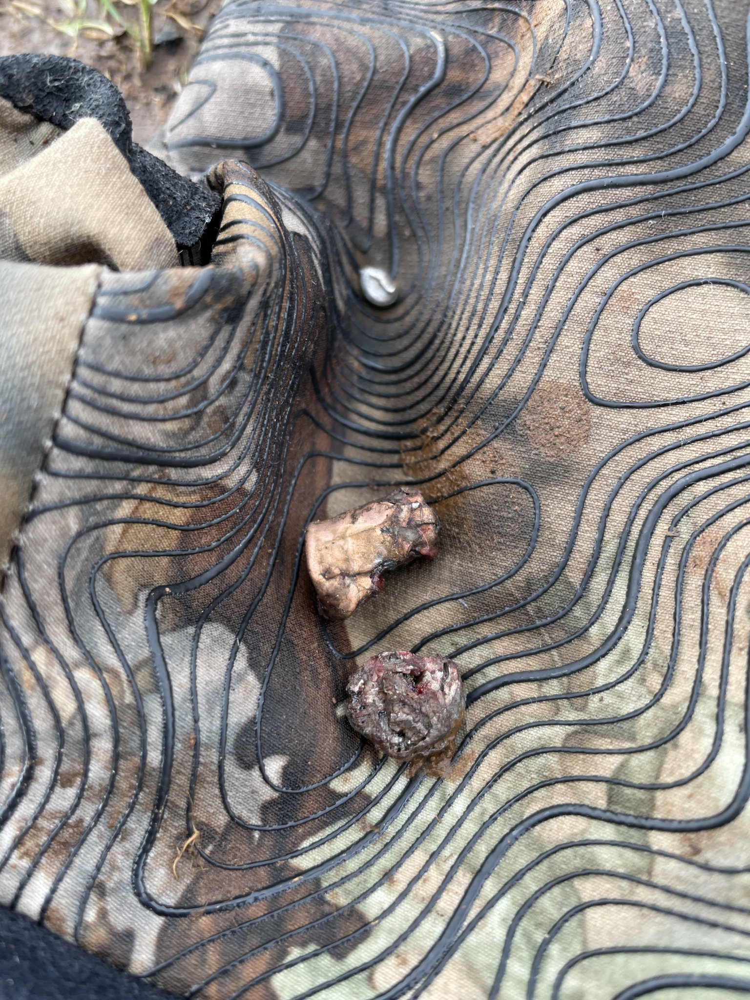

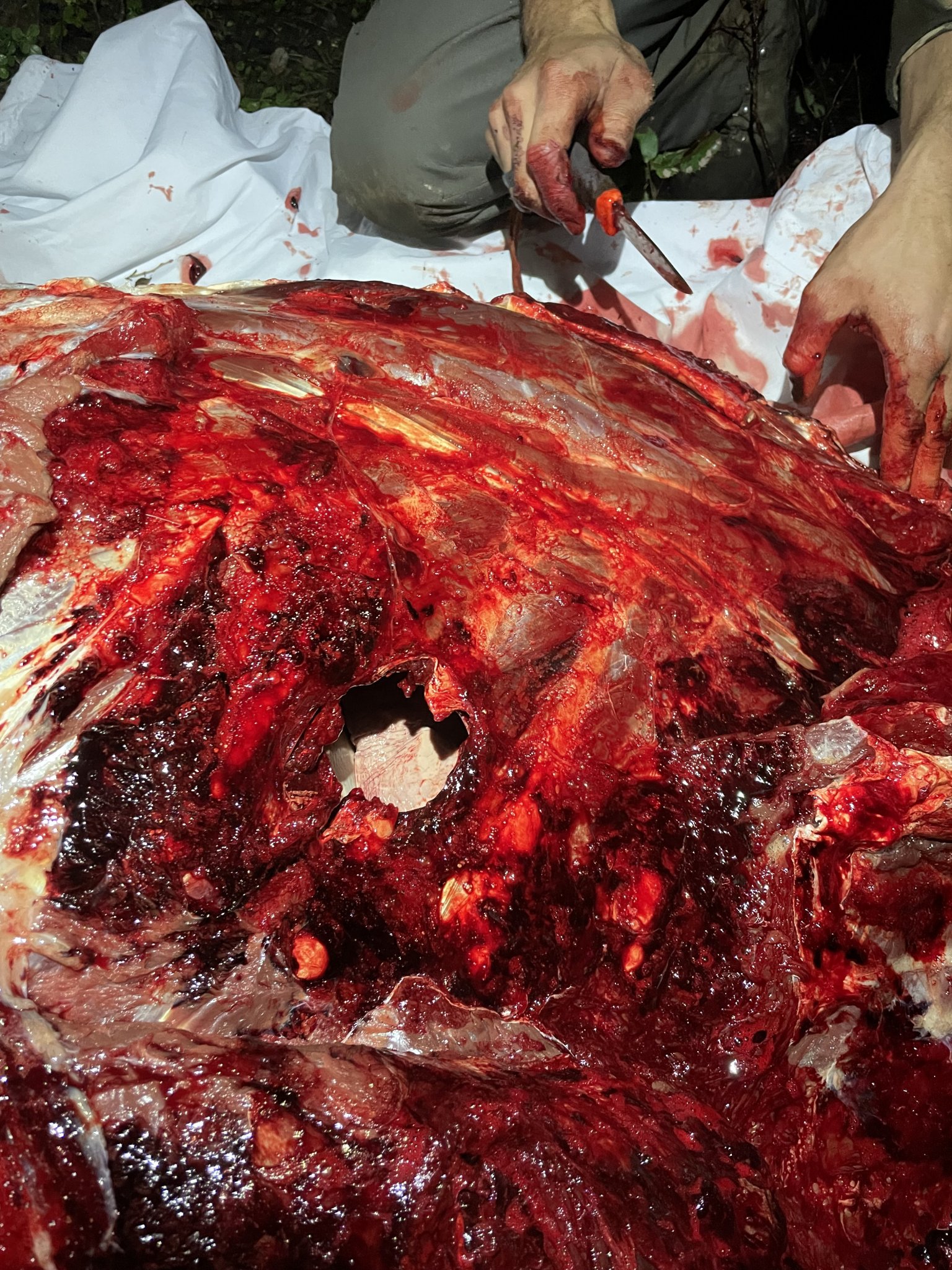

Here’s my elk from two weeks ago. Double lung, 50yds, zero meat loss, massive internal hemorrhage, just had enough energy in him to run down a short hill and die at the edge of brush. Pic is of the entrance wound, the bullet stopped under the far side hide.
View attachment 8276420View attachment 8276421View attachment 8276422

Both of these elk in the above pics got shot broadside through both lungs. The 7PRC went in, shredded a 2" diameter cylinder through both lungs, and the fragments were under the off-side with no lead/copper in any meat, even the heart was untouched. The 6.5 creedmoor did the same thing with about a 1.5" diameter cylinder of shredded lung.
