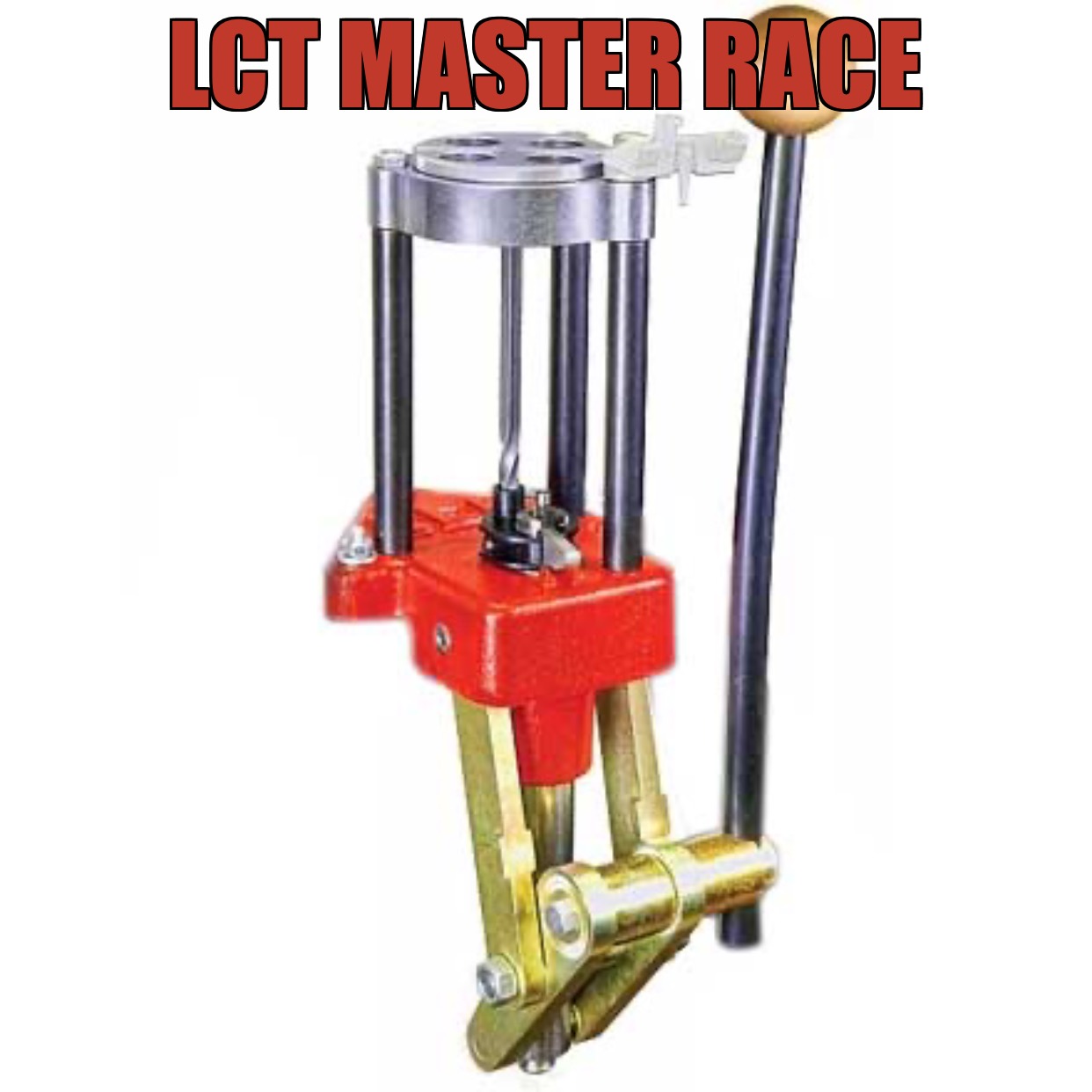

I really like my Lee turret press compared to a single stage.

I've been eyeballing the Lyman brass smith turret too. I've got the Lee turret that auto indexes, which is nice,, but the Lyman looks really sturdy.
I bought the Lyman last year. While it is certainly heavy, there was more play than I like in the ram while pressing down on the handle. I switched back to the RCBS Rock Chucker I was using, which has an absolutely solid ram stroke with no play.
While it’s convenient to have the extra dies on the turret, I installed the Hornady Lock and Load die bushings on the Chucker which makes swapping out the dies effortless. There is a conversion kit that fits the Rock Chucker
