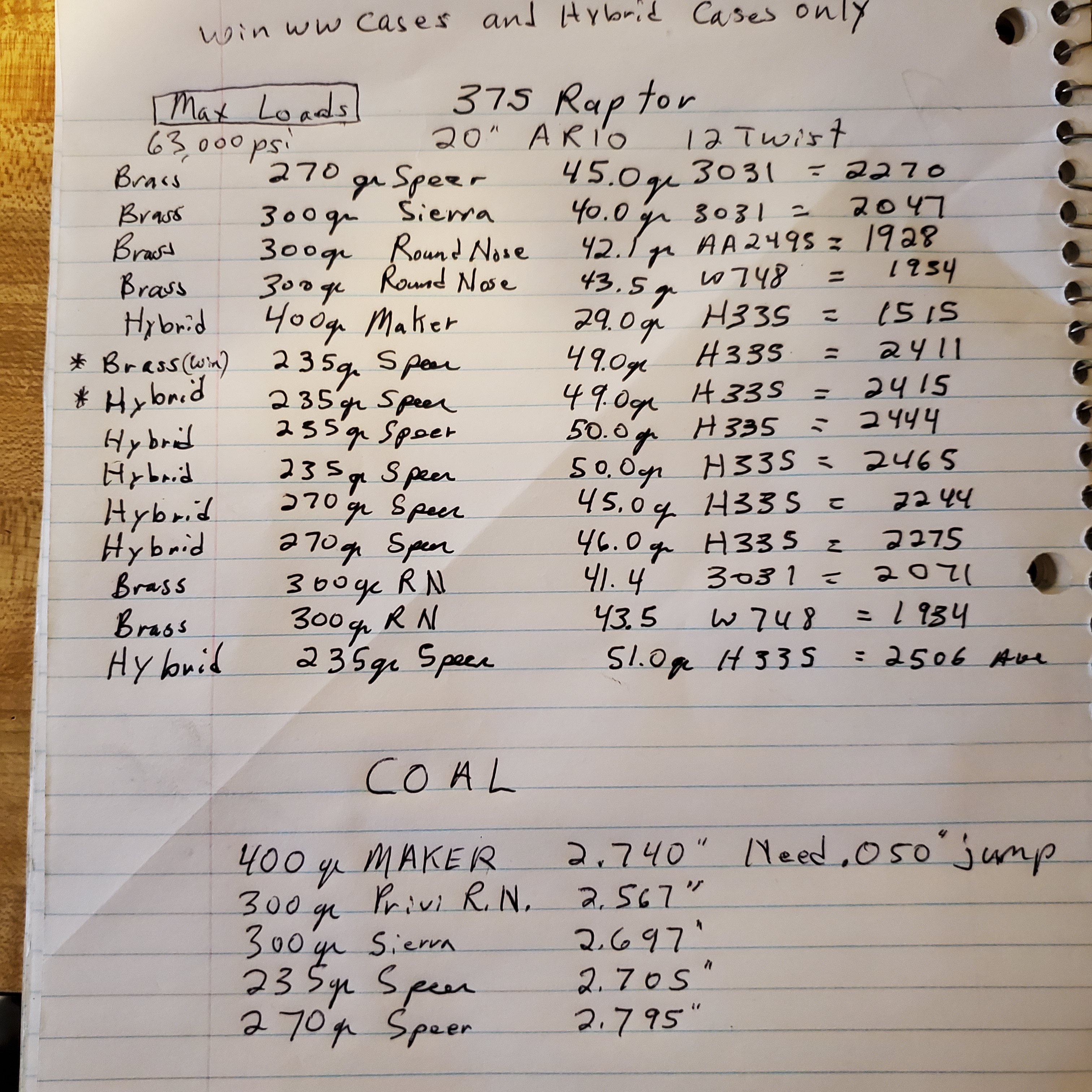

Here's my first load data for the newly built 375 Raptor...
It is Maximum for my AR 10 with 20" 12 twist barrel. Do not increase but start low and see where your pressure indicators start.
This was made from Winchester WW brand and hybrid cases which had more capacity than the others tested and were not used...as noticed by the asterisk by the hybrid and brass with the same capacity got almost the same velocity with the same powder charge.
You must be aware of the cartridge overall lengths shown at the bottom, that and use of other brass with less case capacity will affect drastically!
You must start your load development much lower for the powder charge if anything is different ...in smaller case capacity and shorter COALs...These "ARE
MAXIMUM LOADS"... NOT starting loads...so drop down at least 10% and work up.
Plus rifles, barrels, and chambers are all a little different in sizes.
Use at your own risk, becareful, for informational purposes...and work up, if you decide to use any of it.
