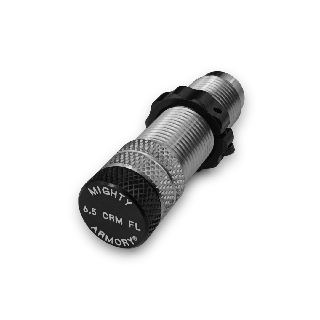

    Im going to make this REAL easy for you to get going making precision rounds for your 6.5cm gasser. Get a Might Armory or Forster FL Sizing die and THATS it. You do not need anything other than a properly setup FL sizing. Now, the Forster FL will work great, but the Mighty Armory is a work of perfection. The type of steel, the finish/quality, the decapping pins are pretty much unbreakable and the expander leaves you with .003 neck tension, perfect for a large frame gasser.
    Set your FL die up in your press to bump shoulders .003, trim to length, chamfer and debur and your ready to load. Get some new Hornady 6.5cm brass which Ive used 10,000's over the years in my gasser with excellent accuracy. I have NEVER crimped a rifle round in my life and havent found a need to.

    Thank you for your help mighty sizer ordered. A member here has reached out to me about brass. It happens to be Hornady. I was leaning towards small primer due to the supposed longer primer pocket life but srp are impossible to find right now and if the price is right the brass life is a diminishing return on investment. And who knows with lrp I might not have primer issues. What do you think about the Forster ultra micrometer seater dies?
    You won't go wrong with them, I have been using them for every bottleneck cartridge I shoot for quite a few years now. I like them better than Redding, and I do use a lot of Redding products.
    I use a lot of Forster micro seaters. They are good. LRP brass is fine.
