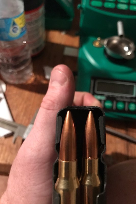

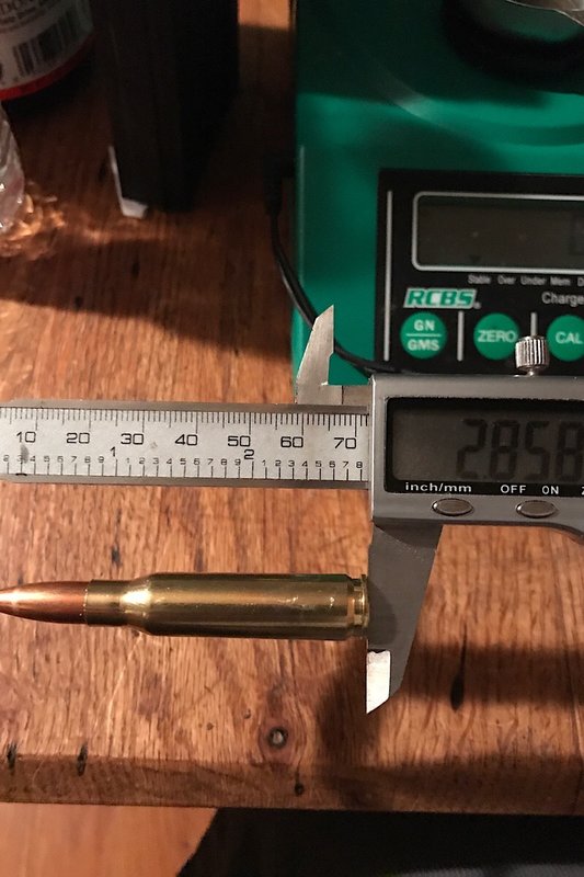

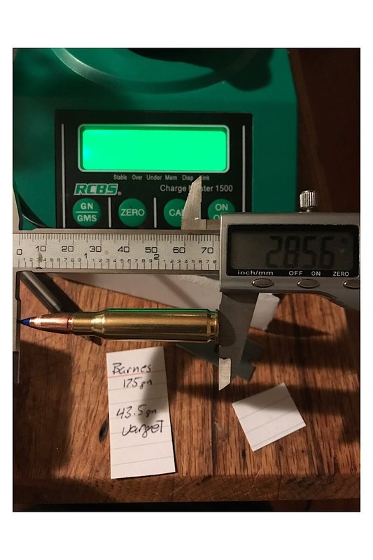

Your loads appear to be near the top of range-not necessarily an ideal starting point. General advice is to work up to upper range of scale, rather than start at top down. Google Dan Newberry for OCW and then work on optimal length to lands, which is a process. Padom has posted yards of his load data work ups for various rifles and calibers. Some pretty solid loading methodology is right here on Hide. The more variables you can isolate, the more reliable your results.

To the OP. How / what / why did you get to the point of using that powder charge and OAL? Did you do a proper load development finding your charge weight, then work on seating depth? Sounds like you're new to all this and that's cool but damn.. you're gonna get nowhere, use a ton of components and frustrate yourself to no end. Don't use them magnum primers and get a chrono. It's a must have for reloaders. Don't just load rounds using charges other people have posted. Do a proper work up for your rifle. You can get some really bad info and screw yourself.
