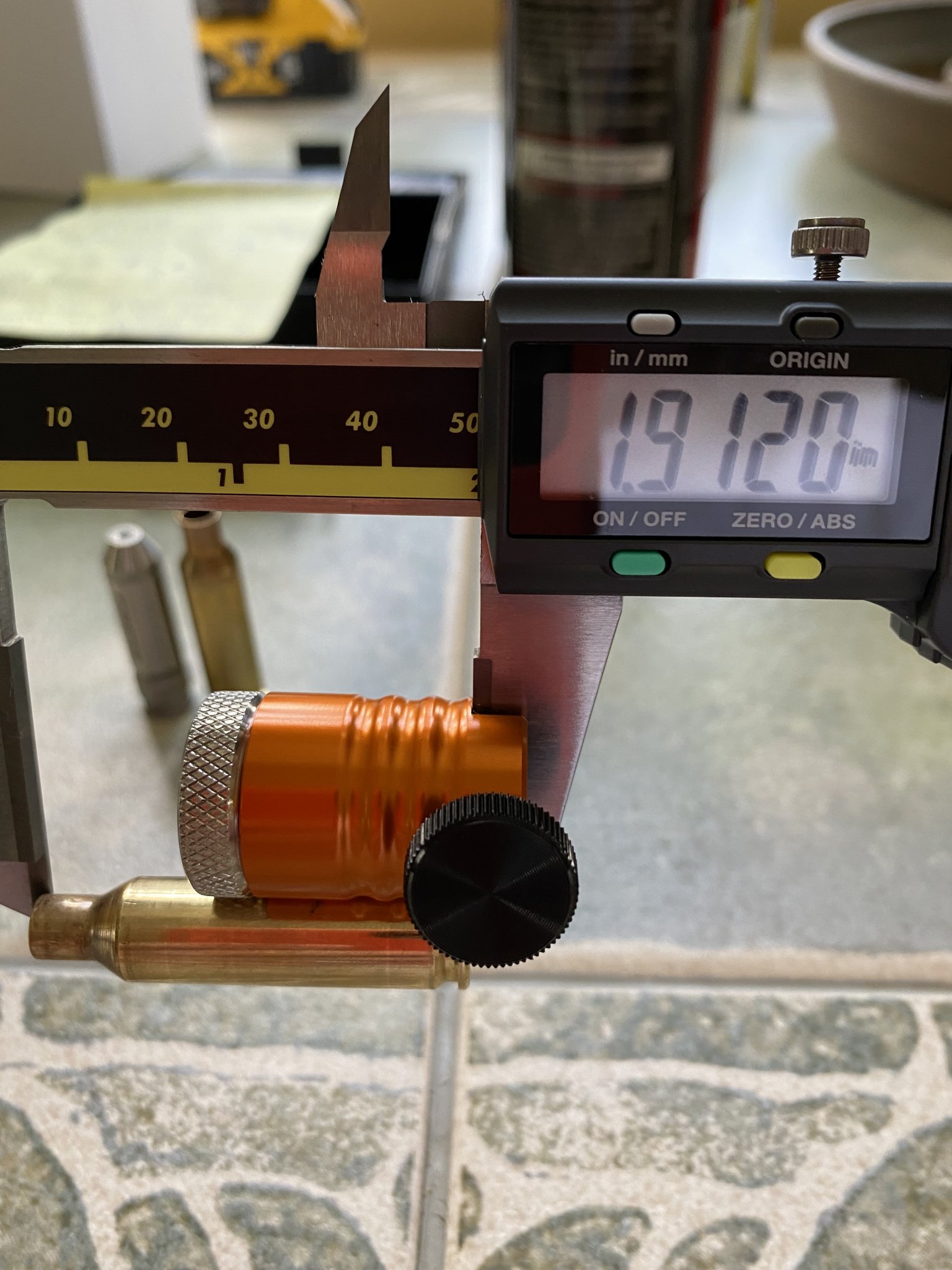

I don’t have it all figured out yet but I’m getting close. I got an RCBS AR series short base die set (just to try).
Today, I used my digital caliper and SAC headspace gauge to measure a fired lapua case…a virgin one…and, my 65CM GO gauge
The virgin case was 2.5820
GO gauge was 2.5850
Fired was 2.5880
So, I figure .003 thousands is what I should bump for this gun
My SAMMI chamber shuts with the go gauge and does not shut with nogo (I checked all that)
I then setup my rcbs short base fl die with proper shellholder
Took the 2.5880 fired case and ran it through SB die
It measured 2.5900. I annealed it before doing so. WTF. I figured it would come back form .5880 to .5850 or .5860. But it came to .5900
It fits in the chamber and falls out but I guess I just don’t get it
Something does not seem correct with your numbers.
Virgin is 3 thousand less than GO gauge
GO is 3 thousand less then fired
After sizing it grew 5 thousandths from what the fired case was
I didn’t zero my caliper after putting the headspace gauge on.
Not sure what you mean. I am using shellholder systems not turning my die up or down.
I’m guessing that a short base die also changes how the shellholder set does its thing.
At the same time I am just not sure if I’m doing something wrong using the caliper and sac headspace gauge

Pic just show case length and caliper used and sac has gauge
